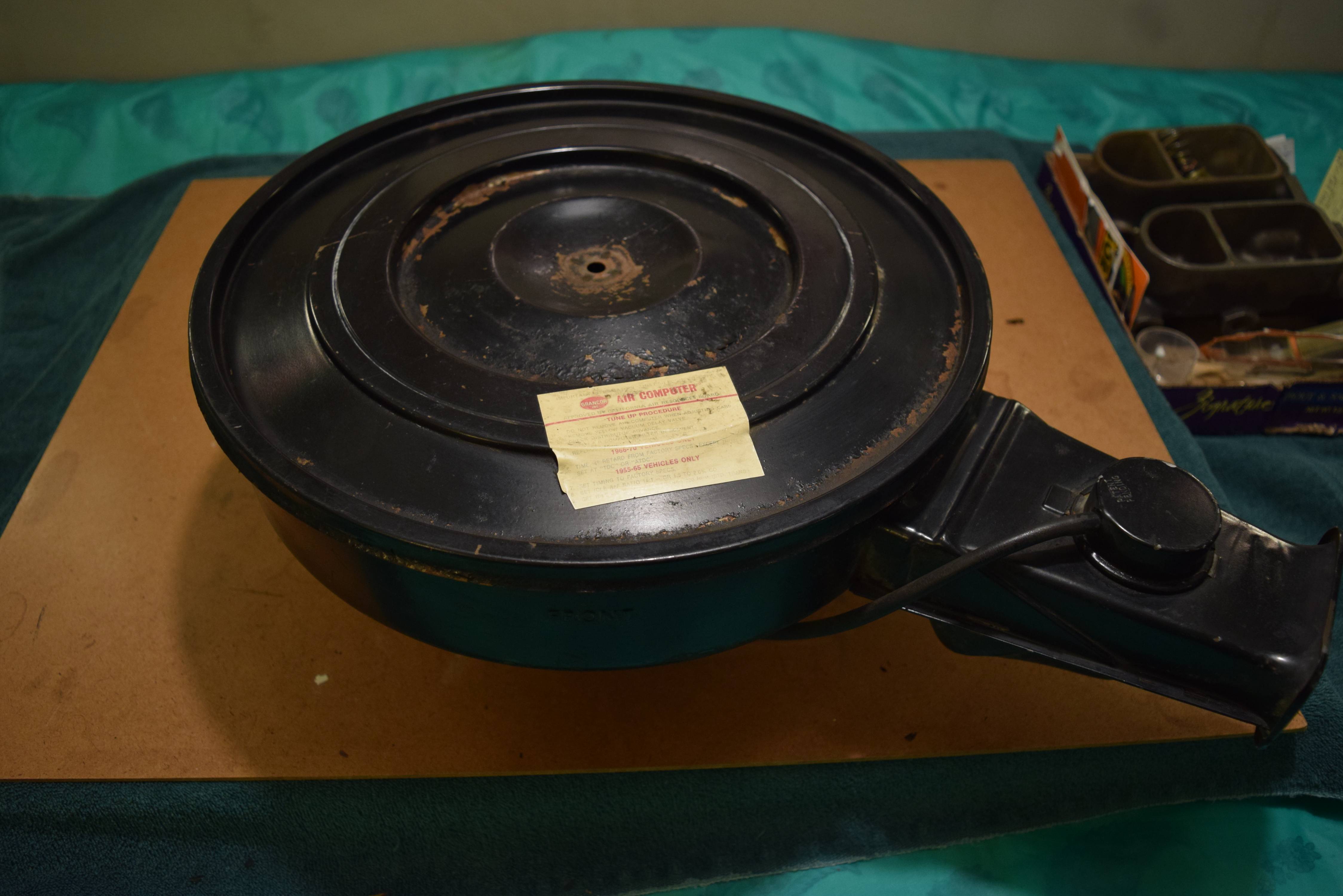

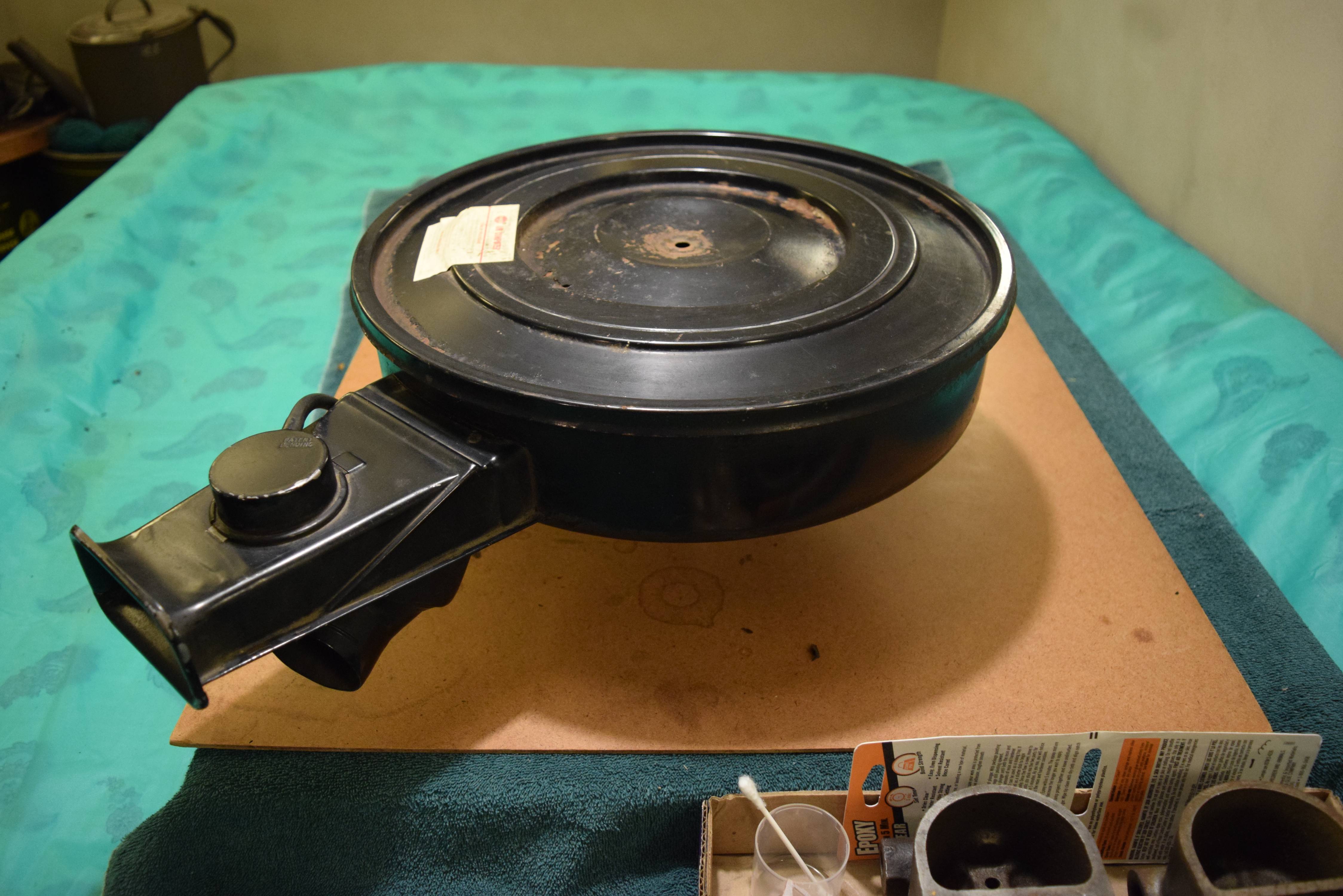

Here are some shots from a March 1970, LA build Challenger 318 in "survivor" condition. This air cleaner, the AC, and exhaust manifolds were removed from the car in 1980 and have been in storage since. This car lived in CA and AZ up until that time. These would have come from the factory with 2bbl carbs, not 4bbl.
No sticker or pie plate at all, and the owner I purchased it from had made no mods.

WOW!
What a fantastic example thank you for sharing!
I was wondering, in my 1970 Service Manual it only states 2bbl and I did not find any examples of 4bbl online.
So long story short both of the aftermarket parts above would be "incorrect" although one is a "Mopar" part.

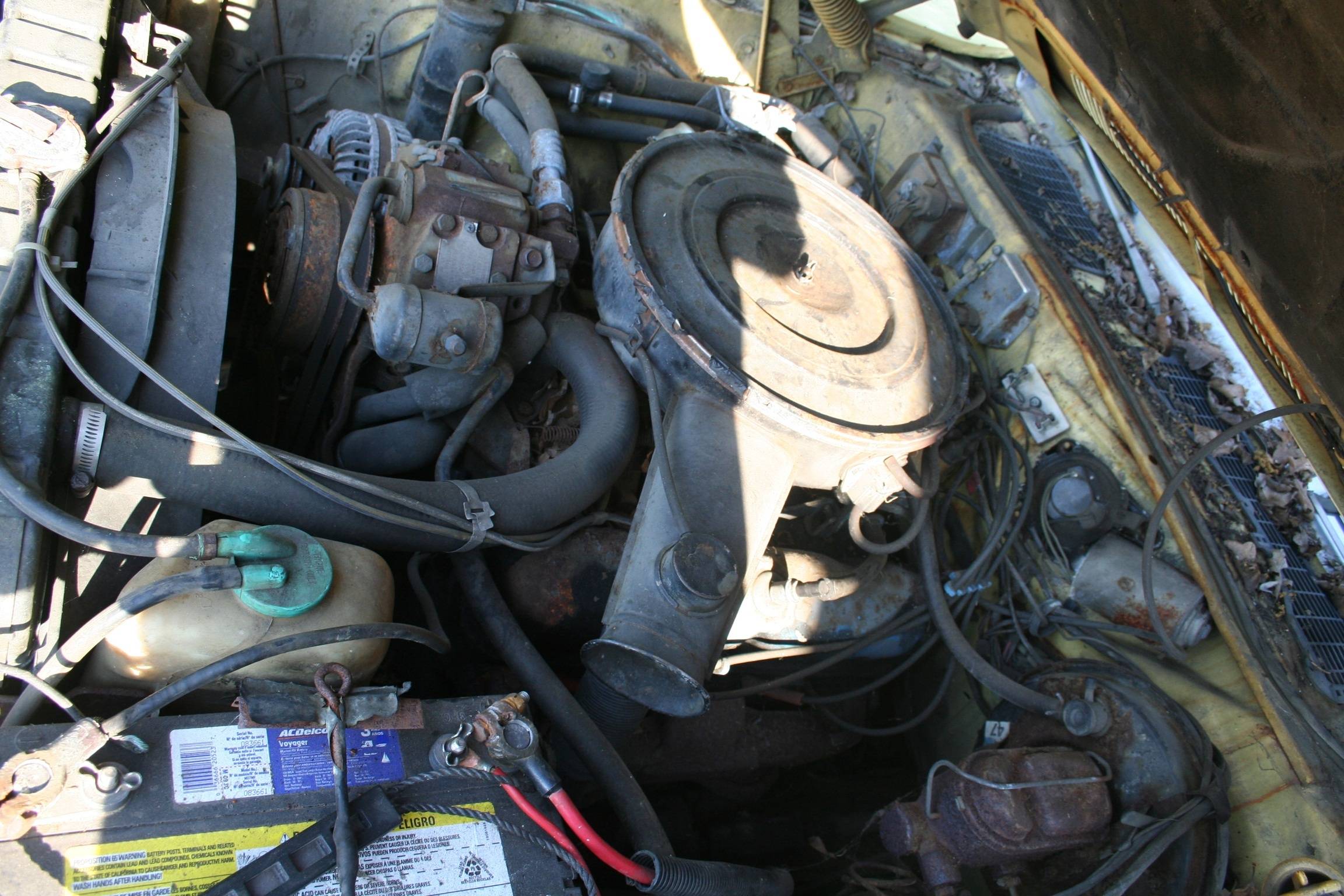

Thats what my 73 looks like! (Benguins picture)
