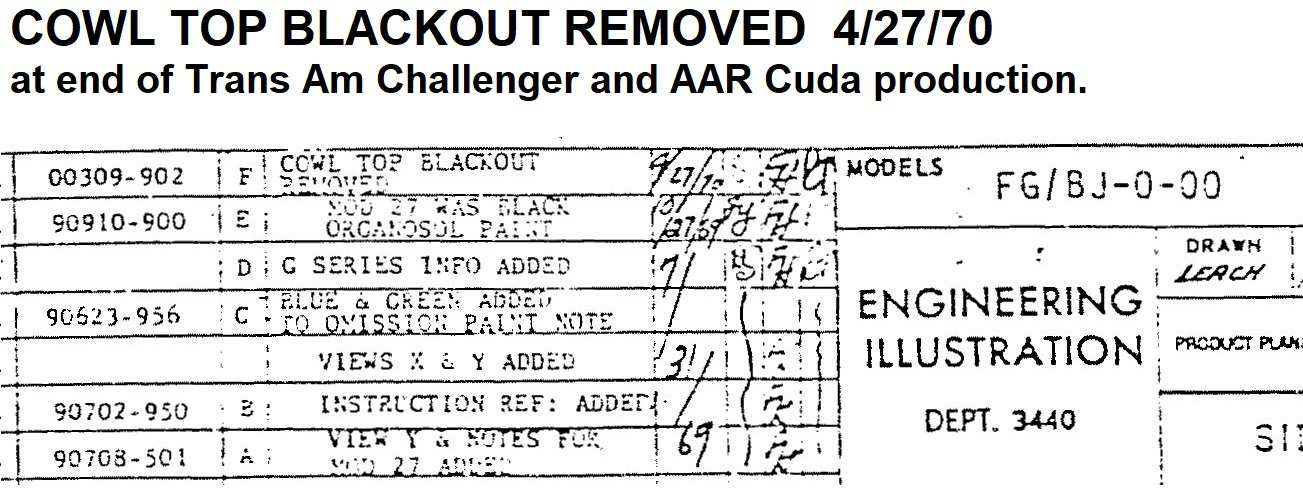

1970 - Cowl is blacked out from AUGUST 1969 thru the end of APRIL 1970. Blackout went away on 4/27/70 as the T/A-AAR run was wrapping up.
The top line shows 00309-902 F COWL TOP BLACKOUT REMOVED 4/27/70. Both MODELS F = 1970 and G = 1971 / B = Barracuda and J = Challenger.
Note the 90623-956 C instruction shows "BLUE & GREEN ADDED TO OMISSION PAINT NOTE" and is dated 7/31/69. That added EB7 & EF8 to TX9 Black for omitting the cowl blackout on the darker colors.
It is not uncommon to find blackout on the blue & green cars by mistake
1971 - No cowl blackout.
