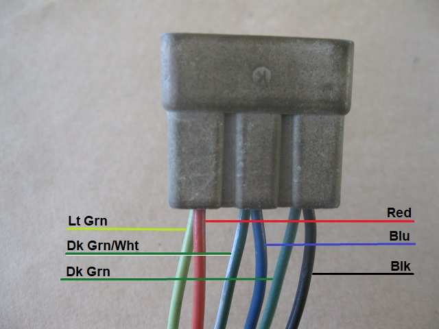

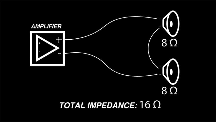

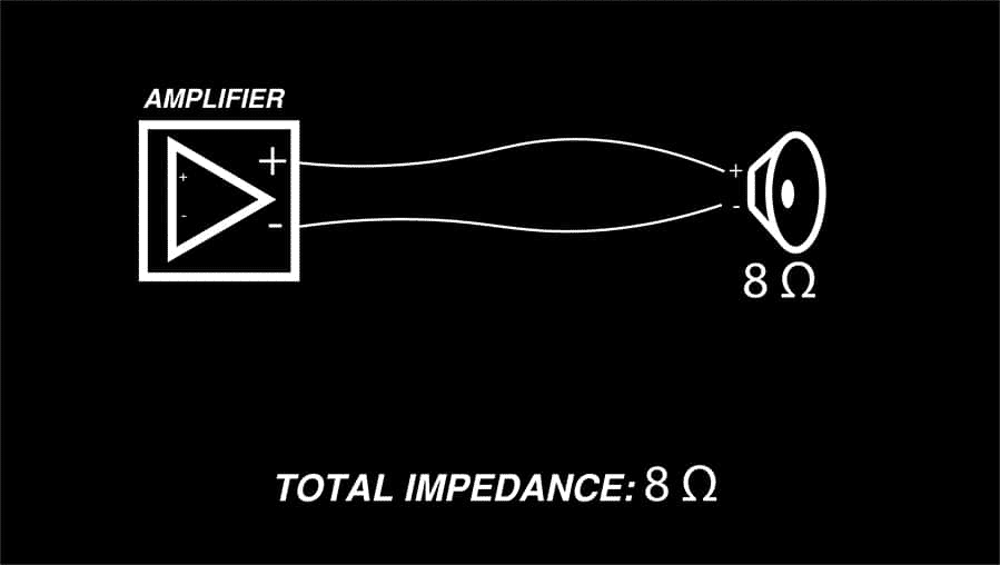

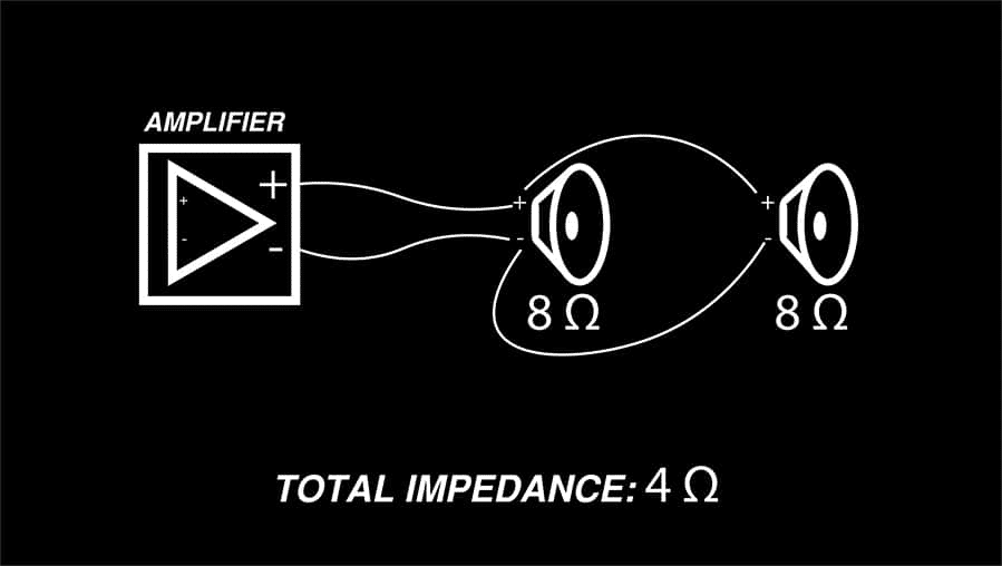

Below is a diagram a member made up.
Keeping it simple.

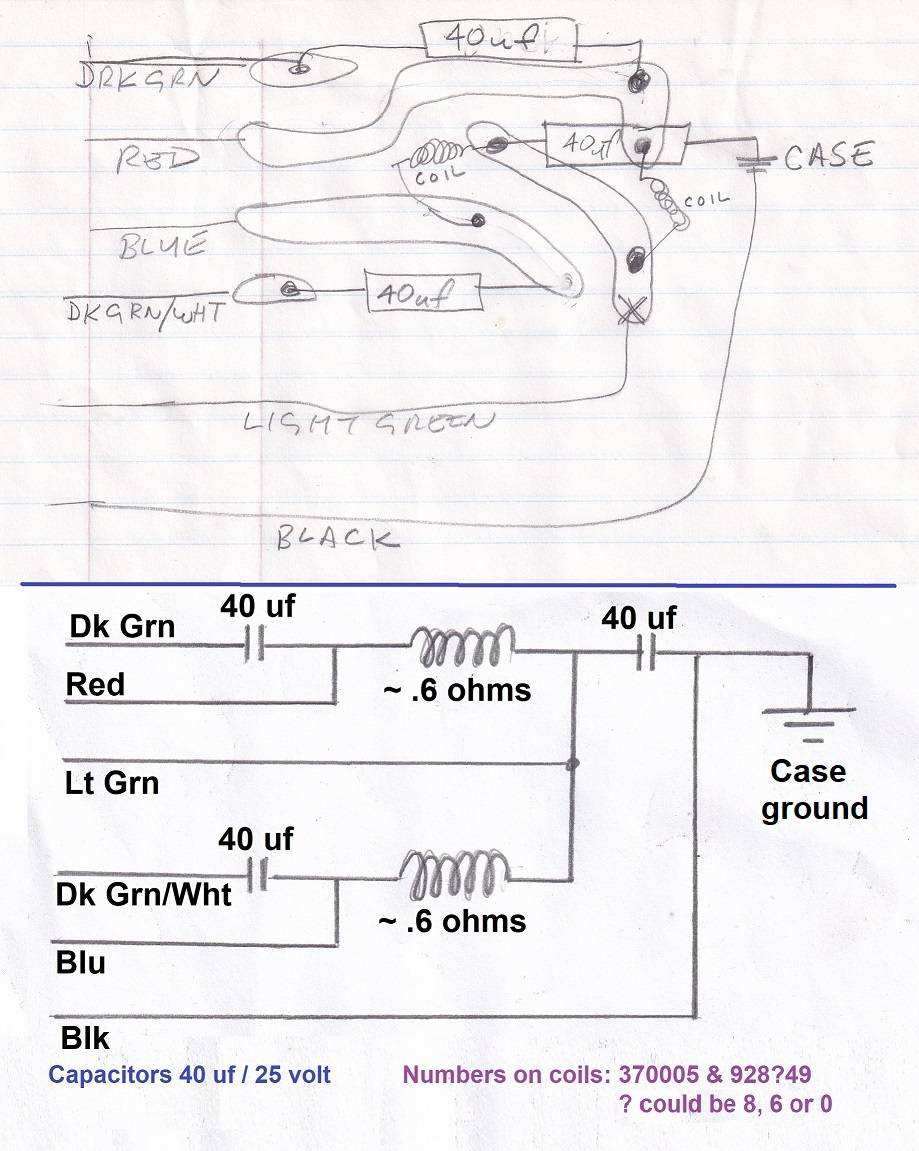

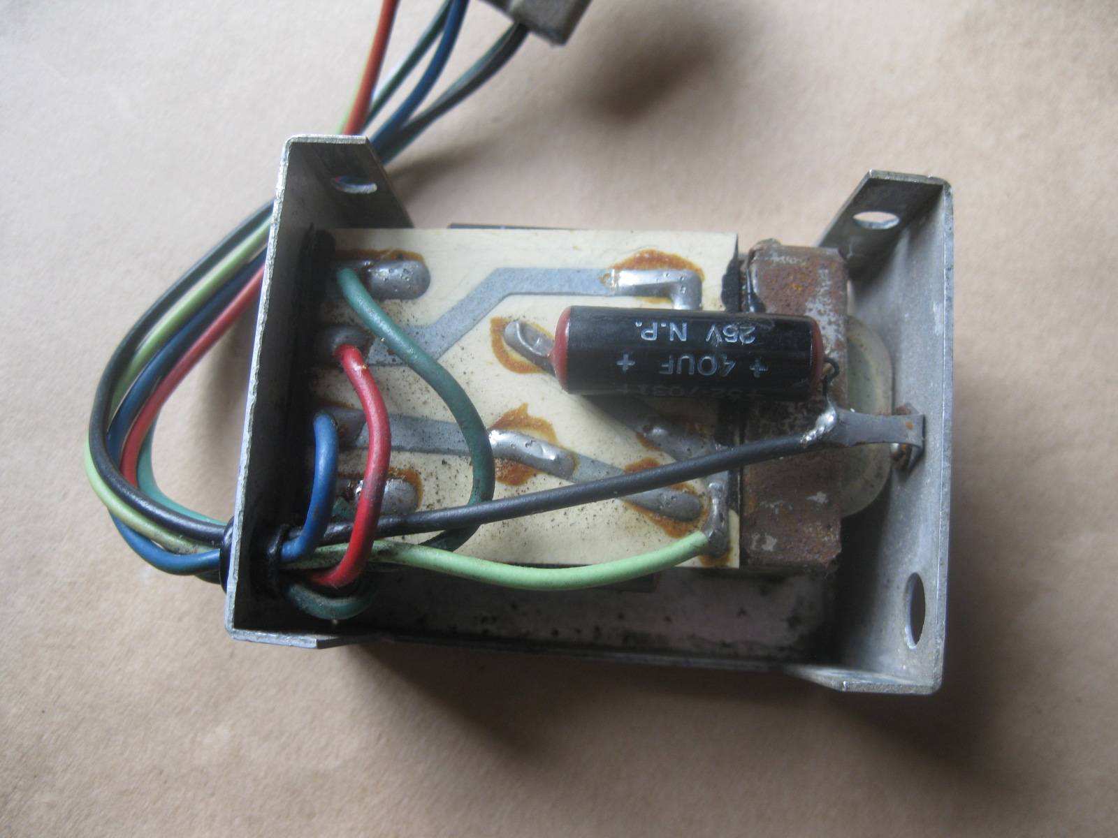

I haven't made a new post since I sold the 5 speaker wiring and speakers.
I still have the 3 speaker AM wires and spare crossovers.
