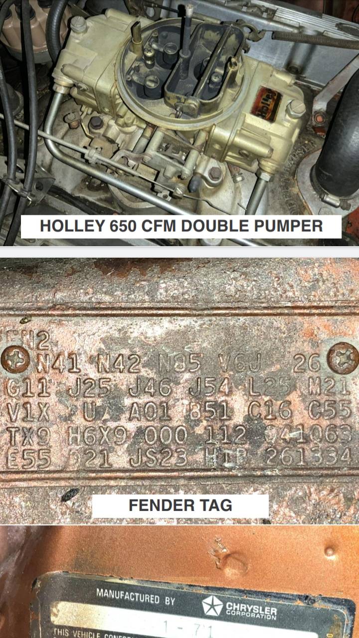

Was thinking the same. I really would have to even look at it before applying them anyhow. It would probably look funky on the scoops. Being black really makes it hard to figure out. Here's the fender tag tho. I had gone thru it once but v6j is the only thing I seen related to the stripe.

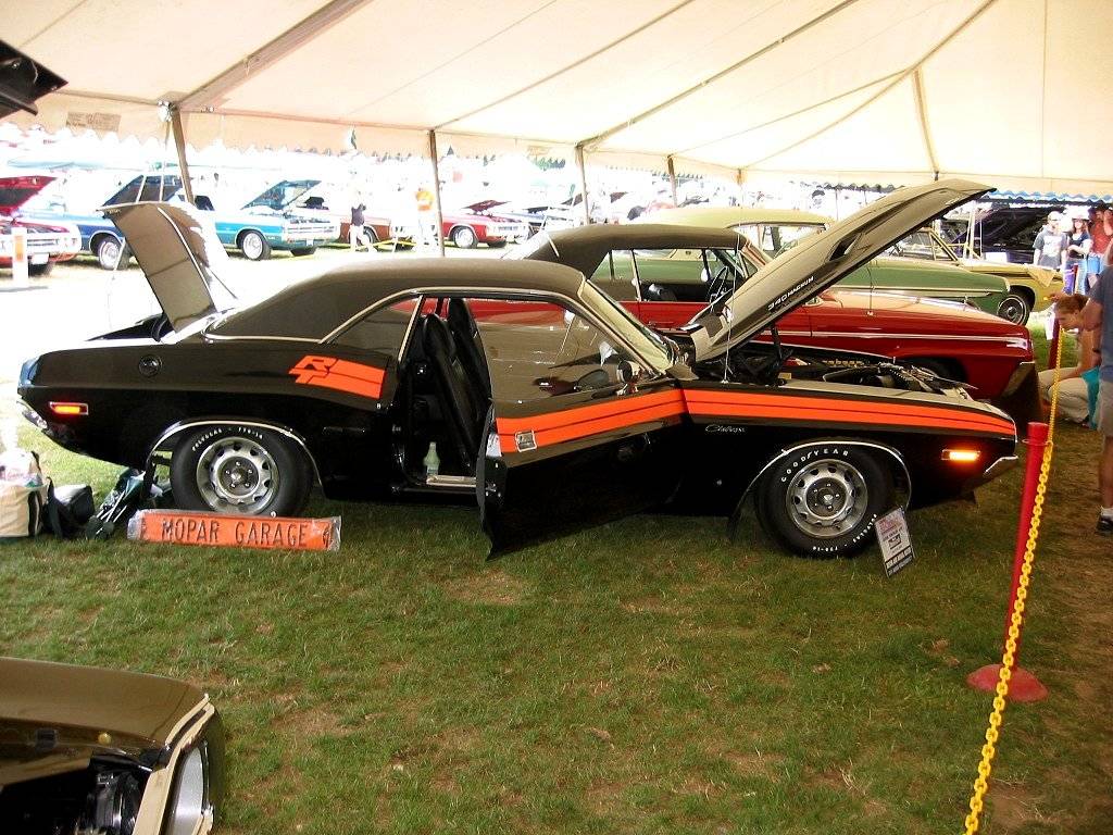

Great looking car
Love the Black and Orange

I seen this car before and looks like no rt decal on the hood. The only other black car I seen to have the other flourescent stripe kit. Orange and chartreuse we're the only flourescent colors. There may be more tho. Think it's a 440 4 speed. Mine is a 340 4 speed. Birthdate is 1-12-71.

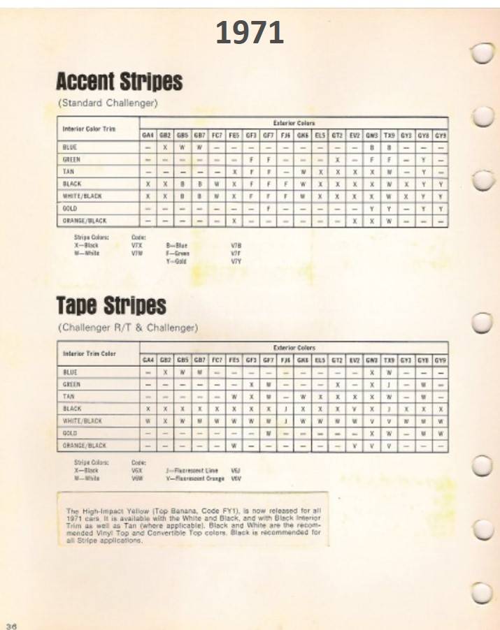

Challenger V6J - Fluorescent Lime
