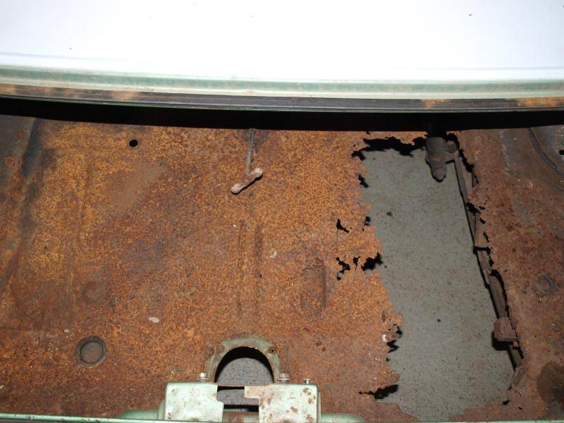

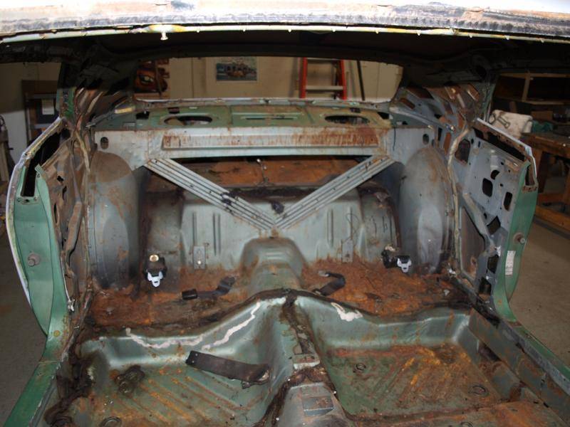

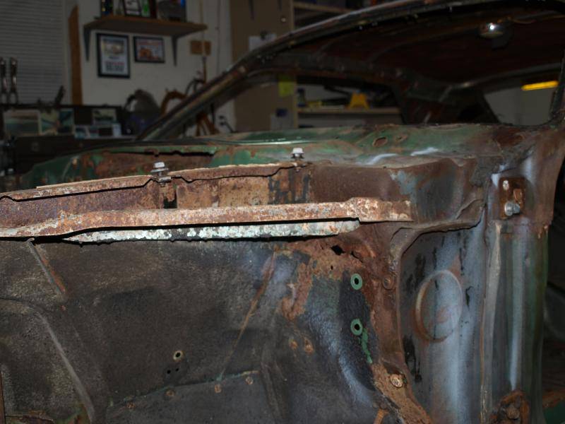

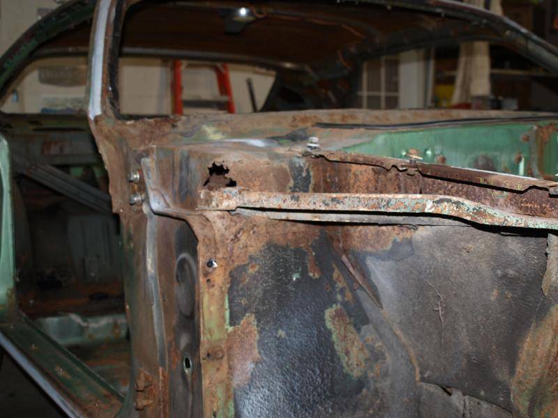

Wow. Cars like this, with hard and really bad rust, I don't even waste my time or my customers money on. If the panel is clearly bad before any blasting, we just take it off, and keep going till we hit the bottom and have a core structure to work with, then media blast, and start the build from this clean core shell.
