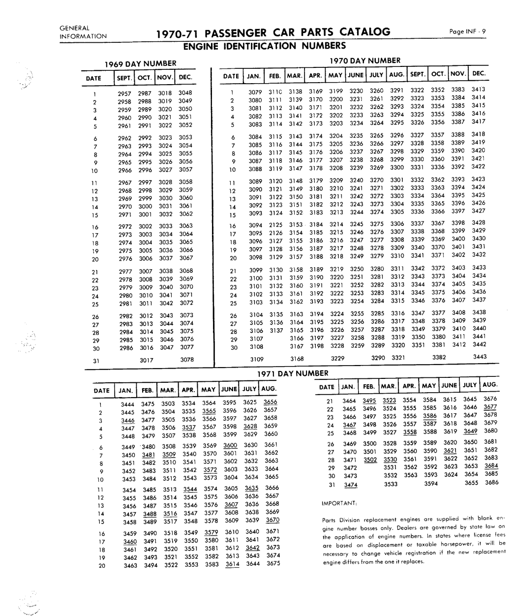

I have a 340 engine. I'm trying to determine what year the engine is. I located the stamped info at the base of the head on the driver's side. I have looked on different threads that explain the stampings. I don't understand what they mean about a 10,000 day calendar, when they talk about the manufactured date of the engine. For example, 3174 means April 6, 1970, based on a 10,000 day calendar.

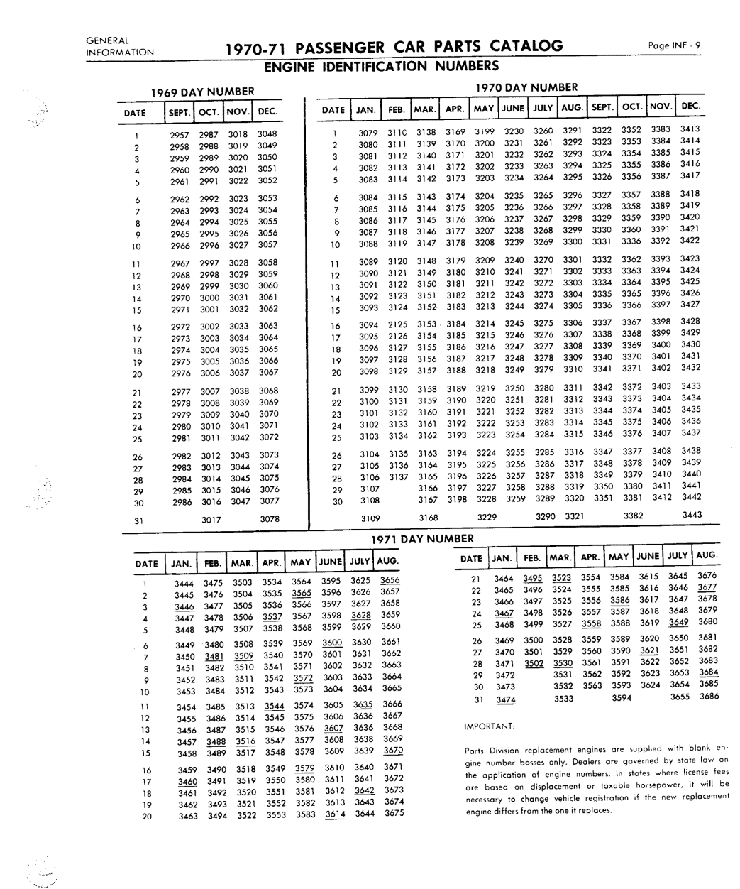

The Chrysler 10000 day calendar is a date coding scheme. The beginning day of the first 10000 day range was Saturday July 29th, 1961, and the days count sequentially from then. The 1970 model year range of days is 2895 – 3259. Tables are in the factory parts catalogs, and as you noted, 3174 = April 6, 1970. Tables/charts and calculators for the dates are also available online. The following image shows the table from the 1970-1971 Parts Catalog:

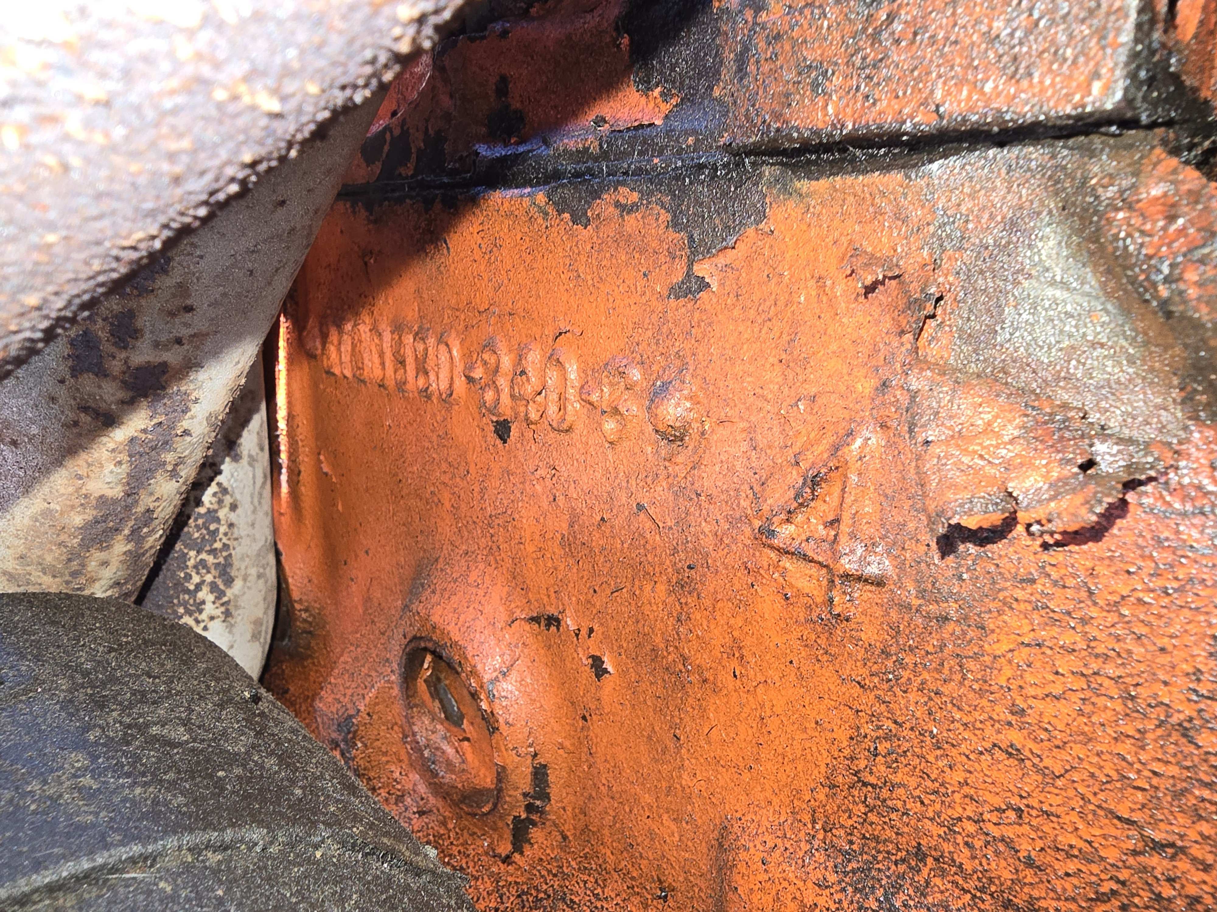

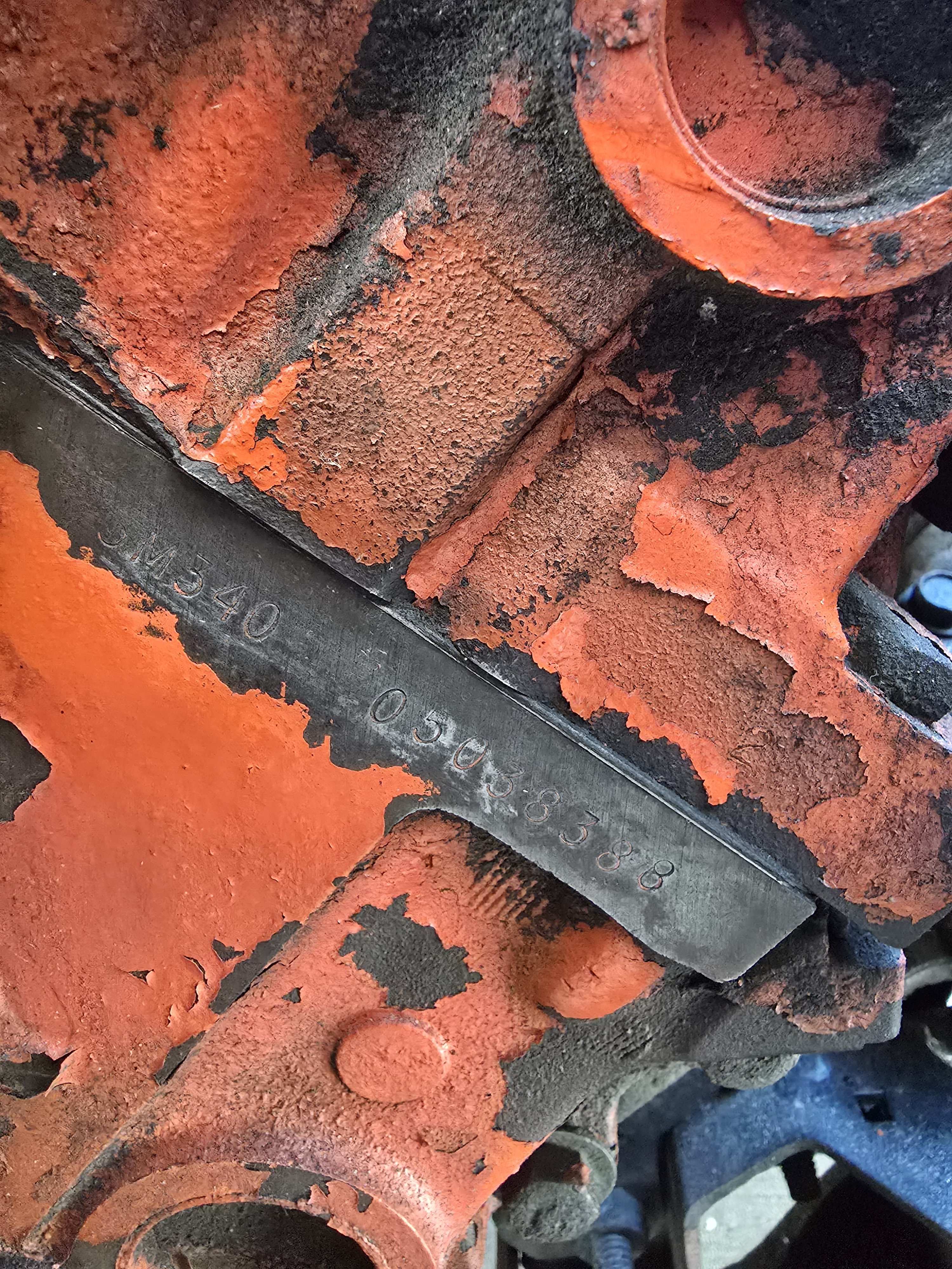

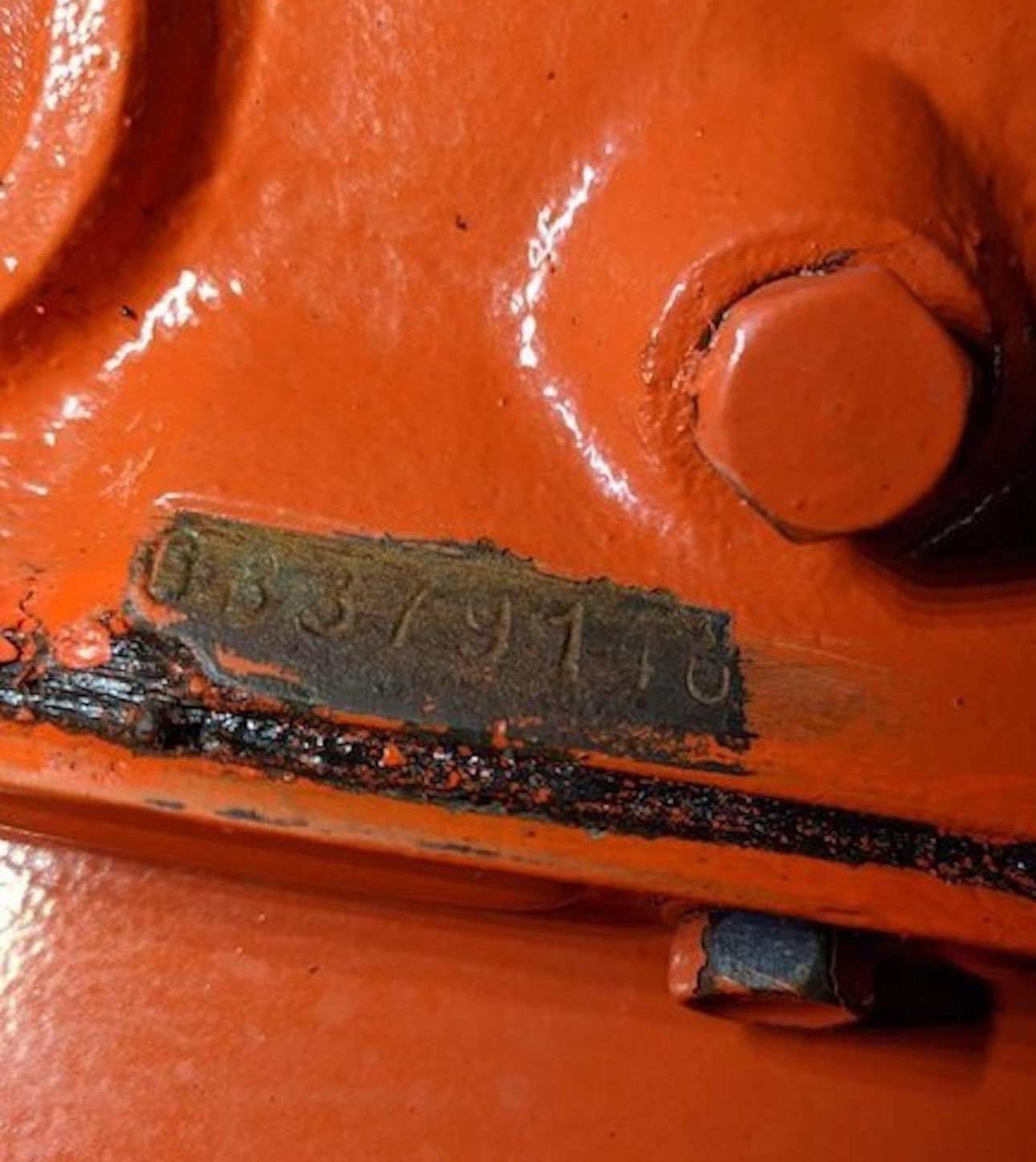

Such a complex way to code the details. I'm having a problem decoding the stamping on my engine. The car was originally a 383 2 barrel. It was converted to a AAR clone by the previous owner. The 340 needs to be rebuilt so I want to be sure I have the proper year.

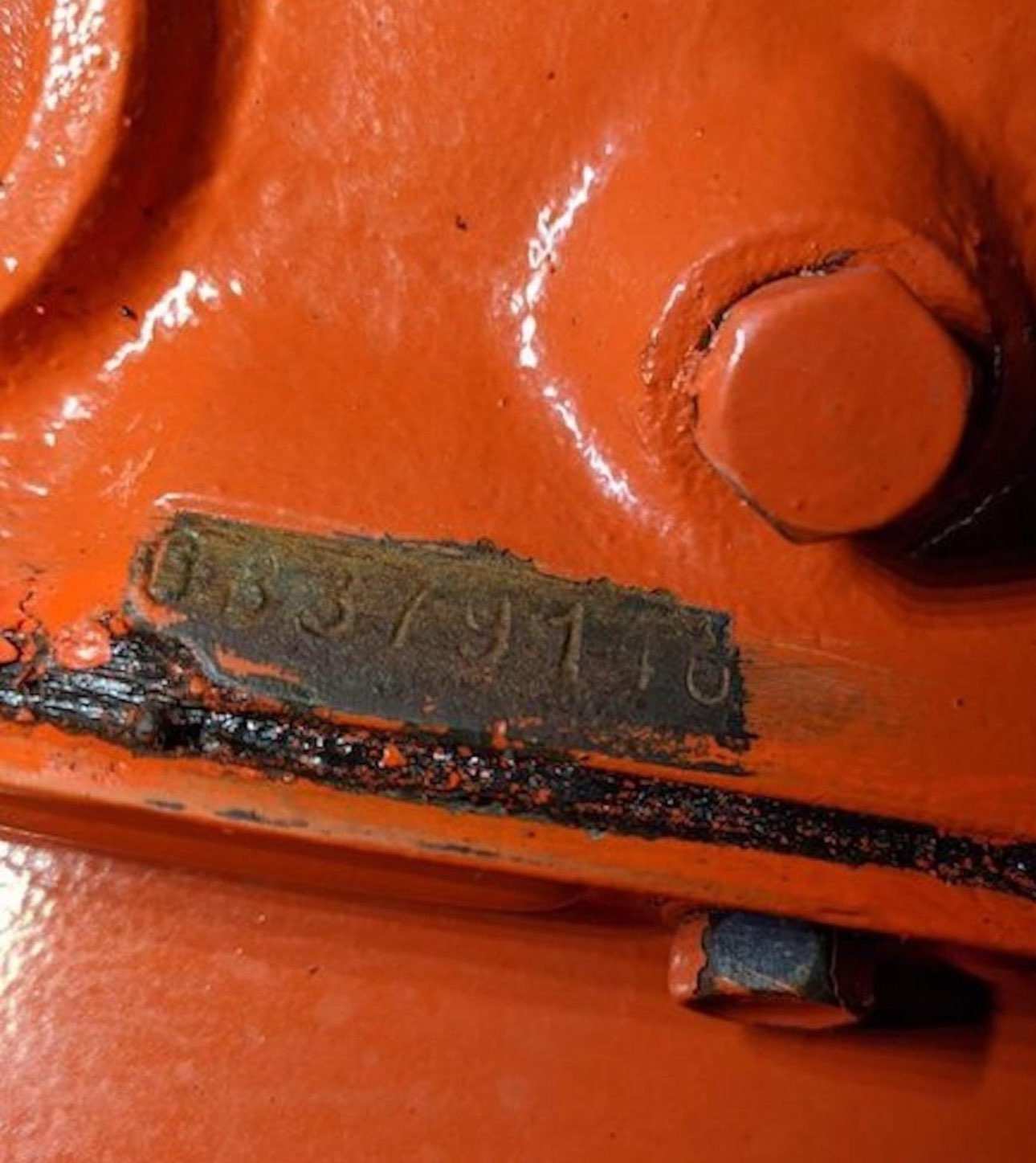

Look at the VIN stamping as that will show the model year as part of the stamping.
Example: VIN ending in 0B379146 below (passenger side oil pan rail) shows zero "0" as the first digit which is the 1970 model year, B for Hamtramck Assembly Plant and the six-digit sequence number.

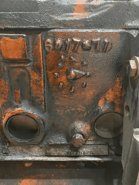

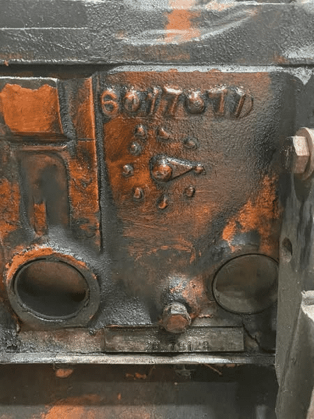

You can also look at the casting date on the side of the passenger side of the block to determine when it was cast. This would narrow down the model year as well.
Below example is casting date 6/17/71 for a 1972 340 (VIN stamping starts with a "2").
Your 340 block casting is the none TA block 2780930 used between 68-73. The numbers on the block are what I think is a factory mistake. It should read 3888 0503 to make more sense. That would make it a 72 340 built on Monday March 20, 1972. A casting date earlier than March 20, 1972 would confirm my suspicion! And it would be the 503rd engine built that day.
