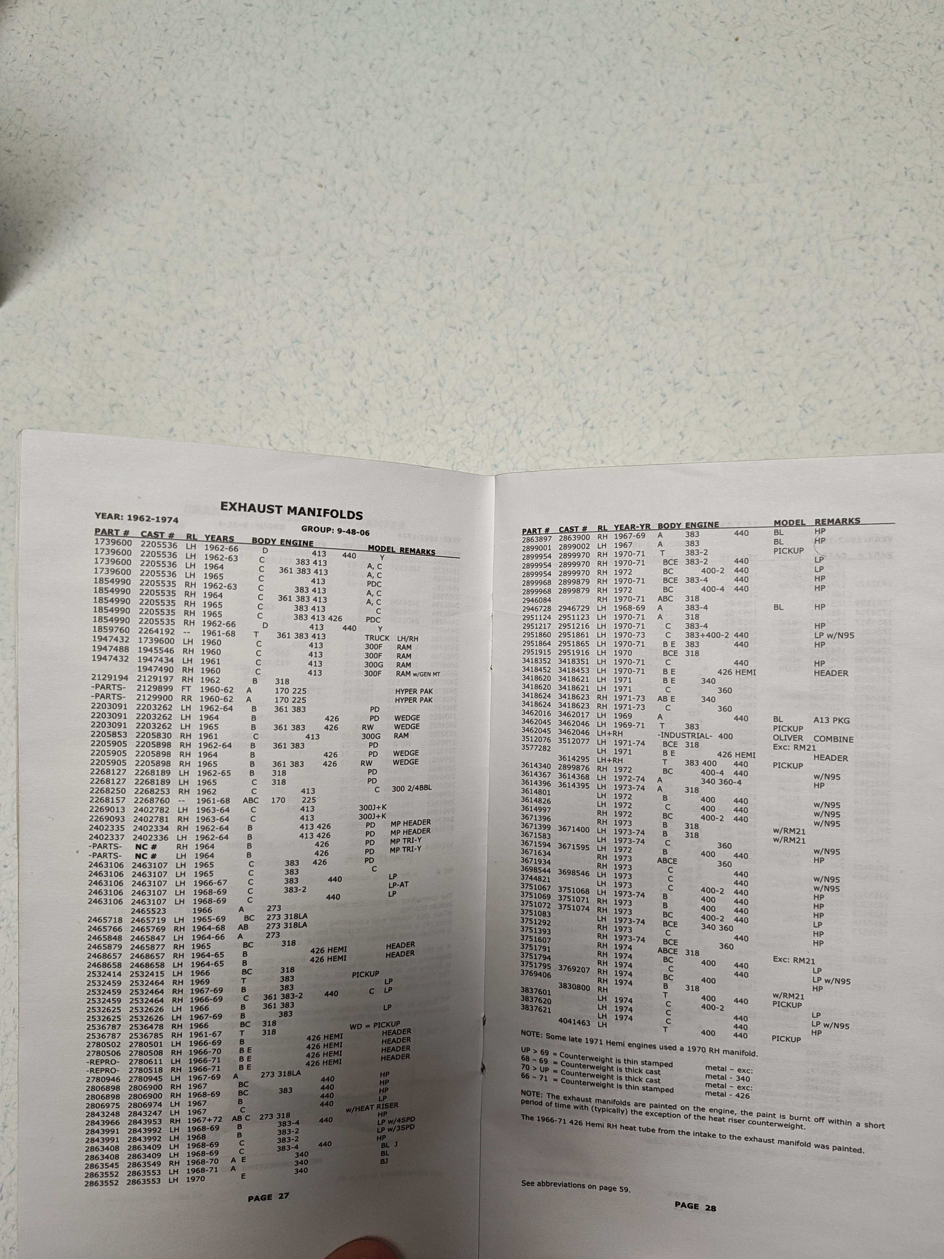

Are the stock exhaust manifolds the same for all years the 340 was built? Also, are the manifold specific to the body style (B body vs etc)? Are the 318 or 360 manifolds the same as a 340? Thanks

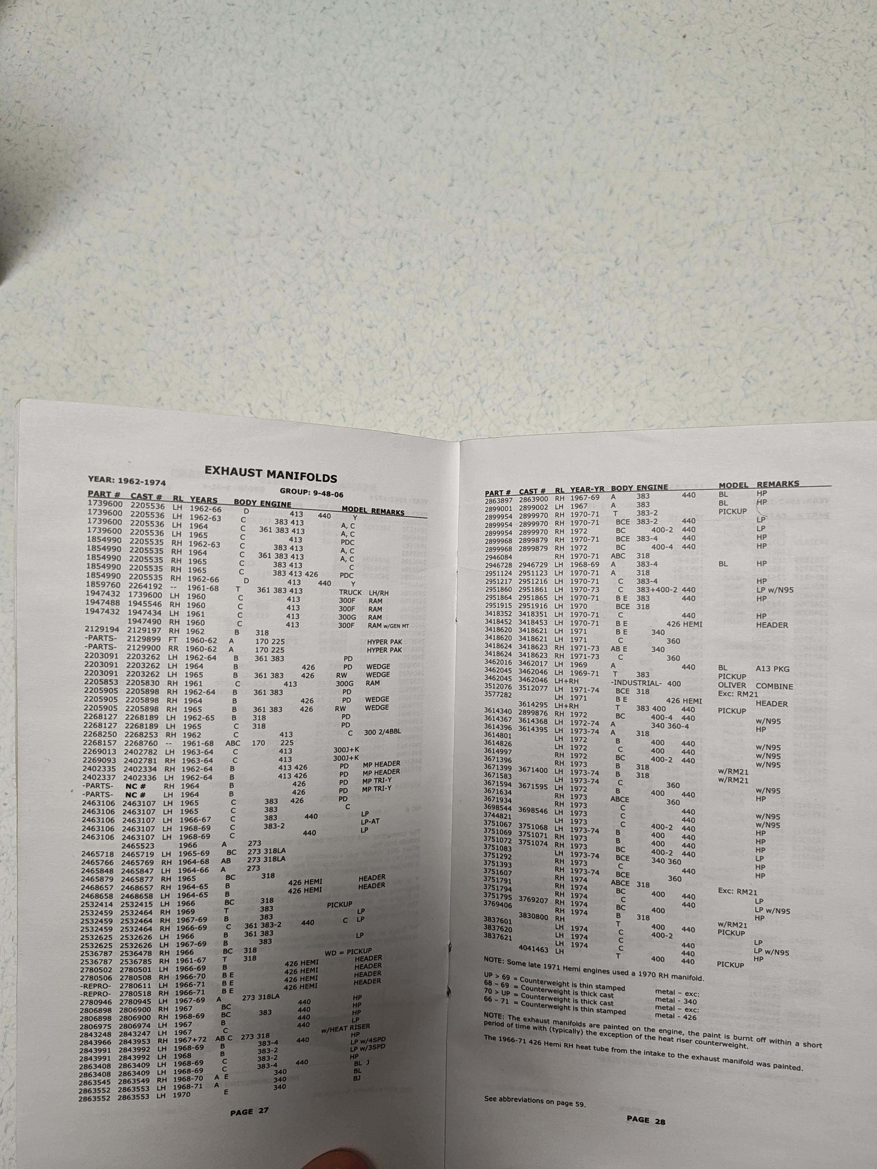

See photo below. It's kinda complicated after 1970. But all 340 exhaust manifolds were the same between A and E-Bodies. Then they started putting 340s in B-Bodies in 71 and the 360 came along.
