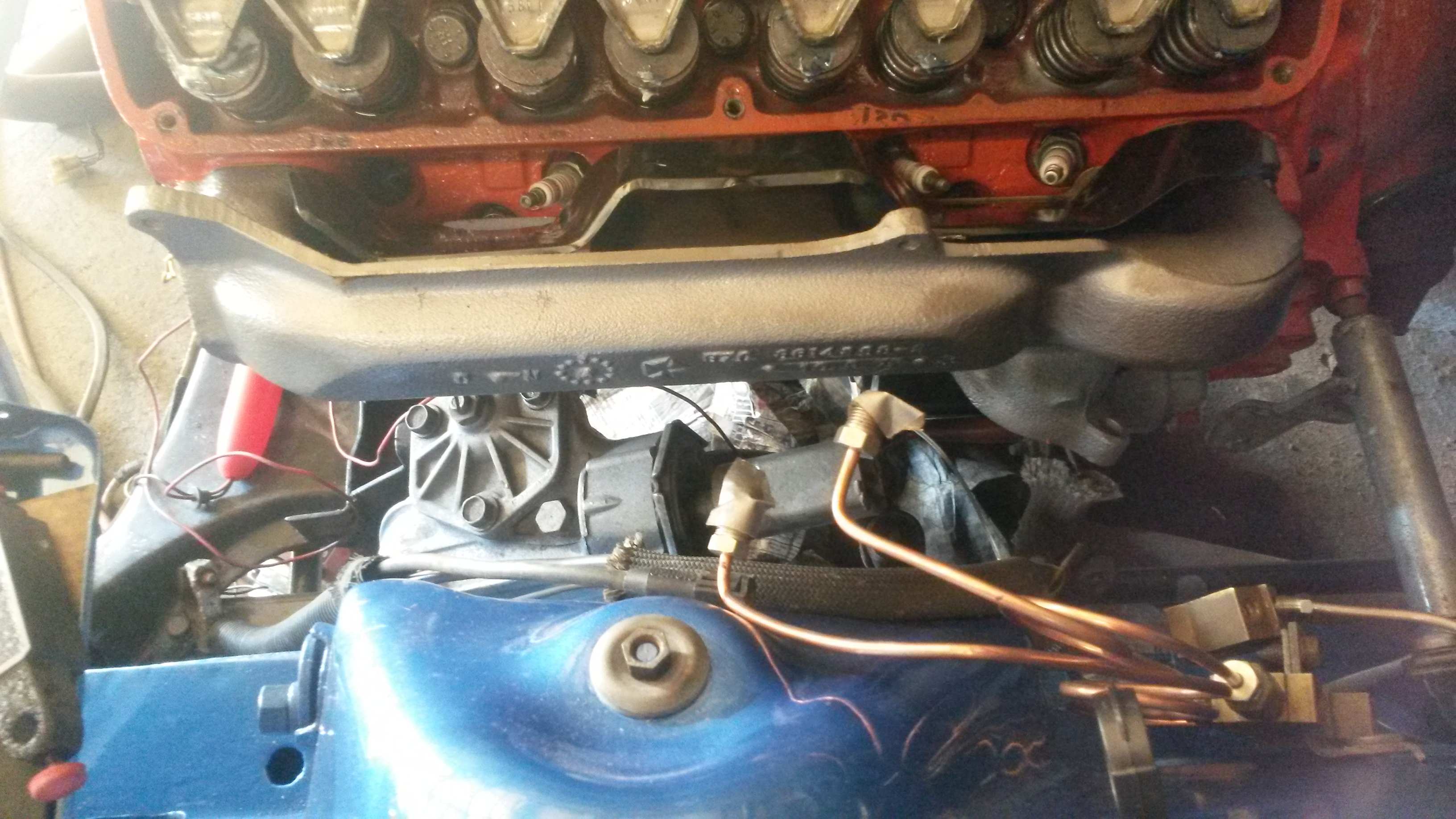

My question is what is the casting numbers for the 318 and the 340 I know are different high performance and will A body dart duster are they the same because people saying they're the same and I don't know around that steering column driver side would be different
Mr Cuda
Jan 26, 2022
310
158
North of Seattle

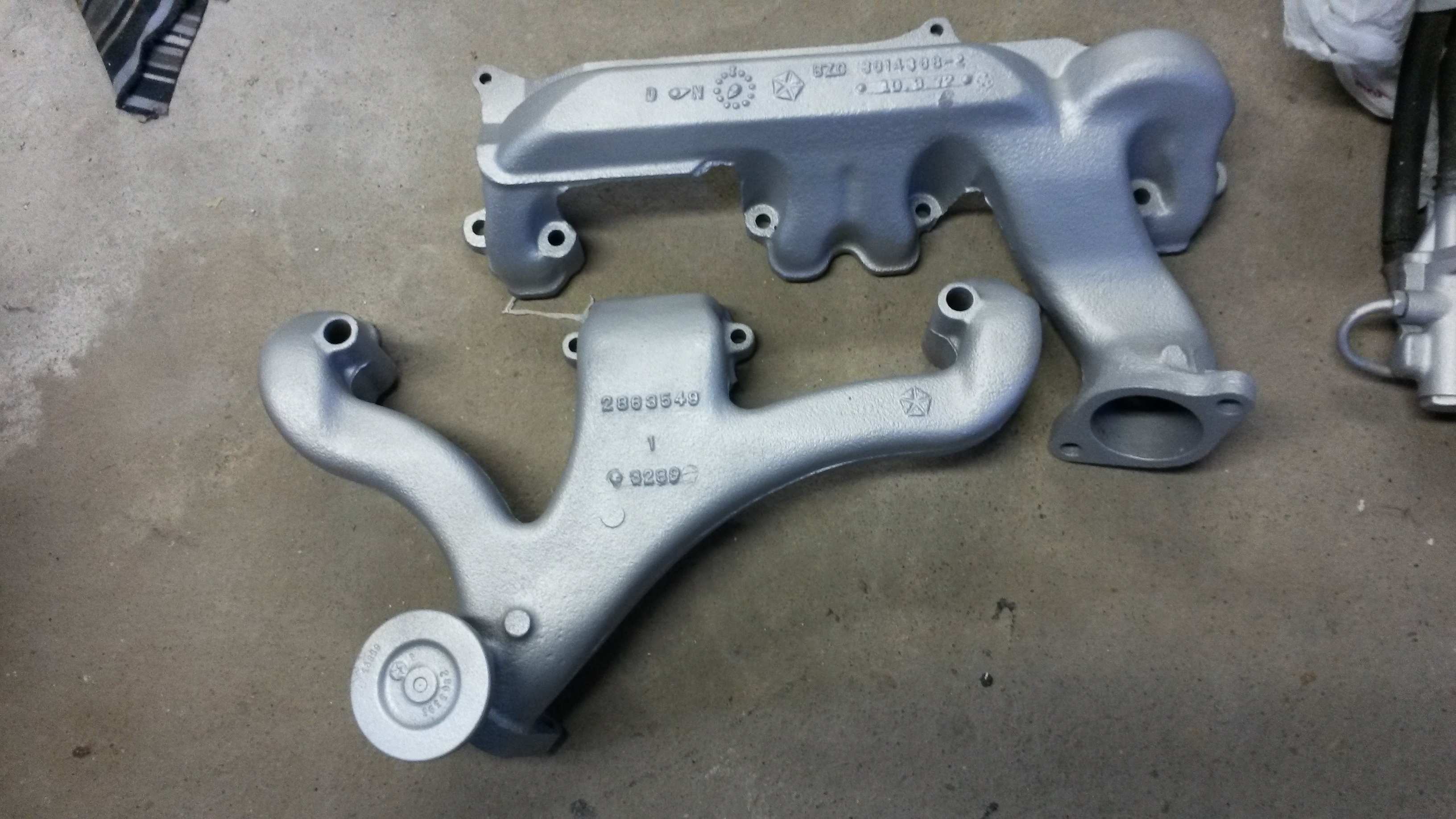

It depends.

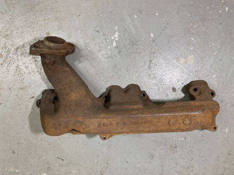

The 3614395 is for 73-74 A body.
The one ad I pulled up said 318, but it looks like a 340 manifold.
First, what head port are you running?
You can't seal a 340 manifold on a 318 head, unless you have a later air port head.
Then, no pre built pipes are made to use that manifold in an E body.
If you need a set of 340-360 manifolds, I have a set available.
They are technically 73's, but fit the same. .

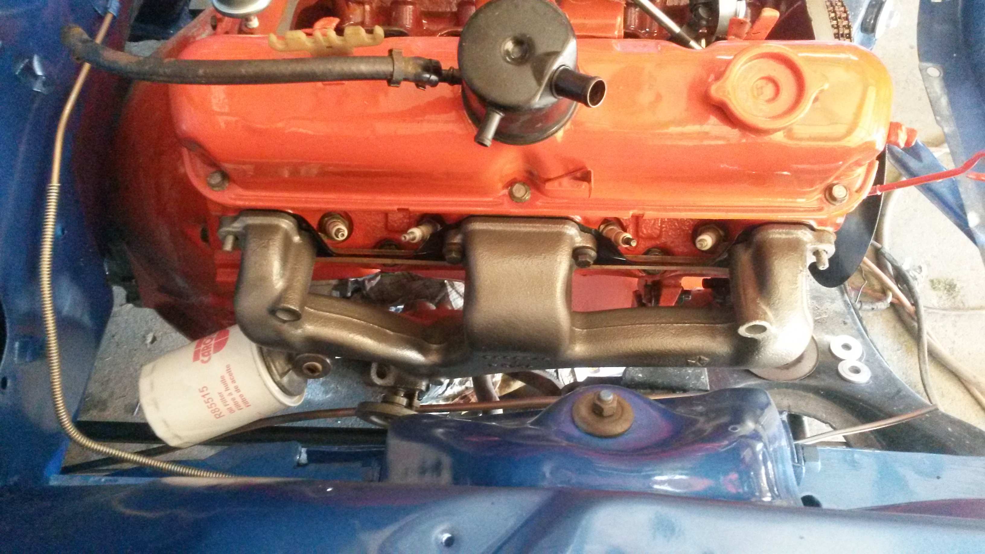

My three team is a 1983 which has the air injection holes in the heads it just seems like they make so many styles for A and e body it gets confusing how much do you want for yours and yours is correct for a 318 style not the high performance 340 correct
Mr Cuda
Jan 26, 2022
310
158
North of Seattle
Yeah, Xcudame, how much are those?
Spikey, those are 68-70. They are better than the style I have available.
The ones I have would be an upgrade for a 318, and are factory for 71 up 340.

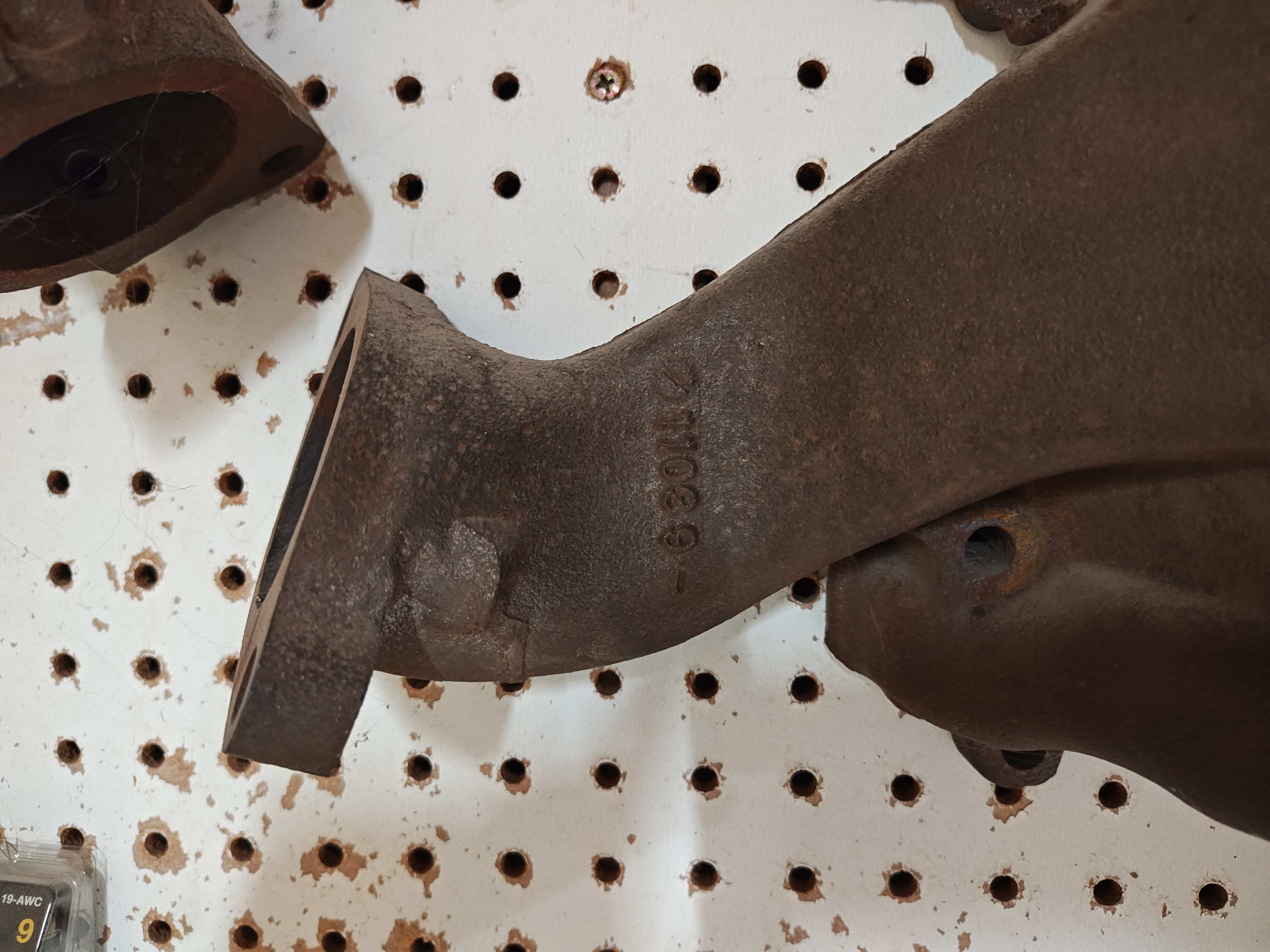

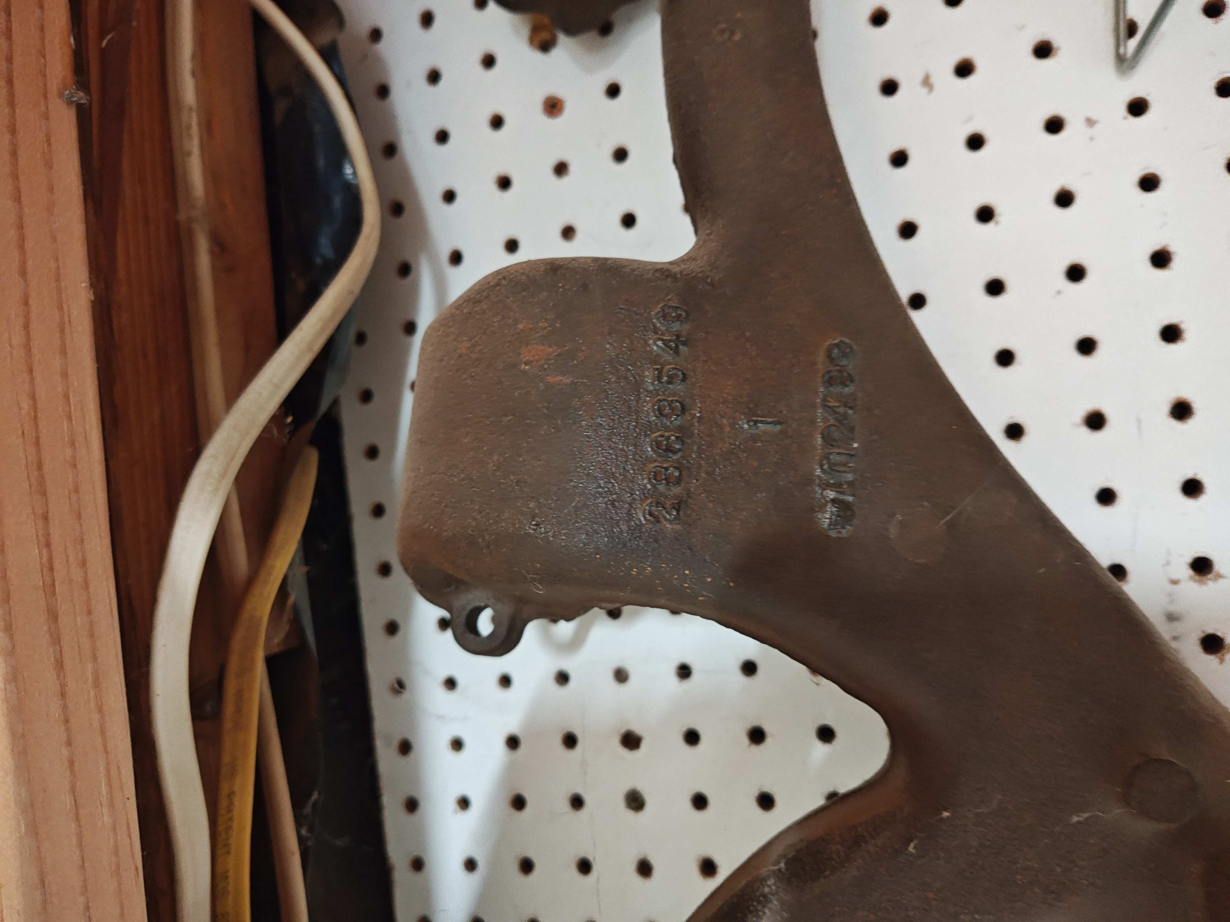

The regular 70 head pipe should have worked fine with that 72 340 A nody left manifold.
The 4388 has just a slight bit less rise away from the head, othereise the same.
The manifold mentioned in the first post is a 3614395, A body 318 and different port and flange.
The good 340 manifolds could be worth more than $1200, if no defects or pitting.

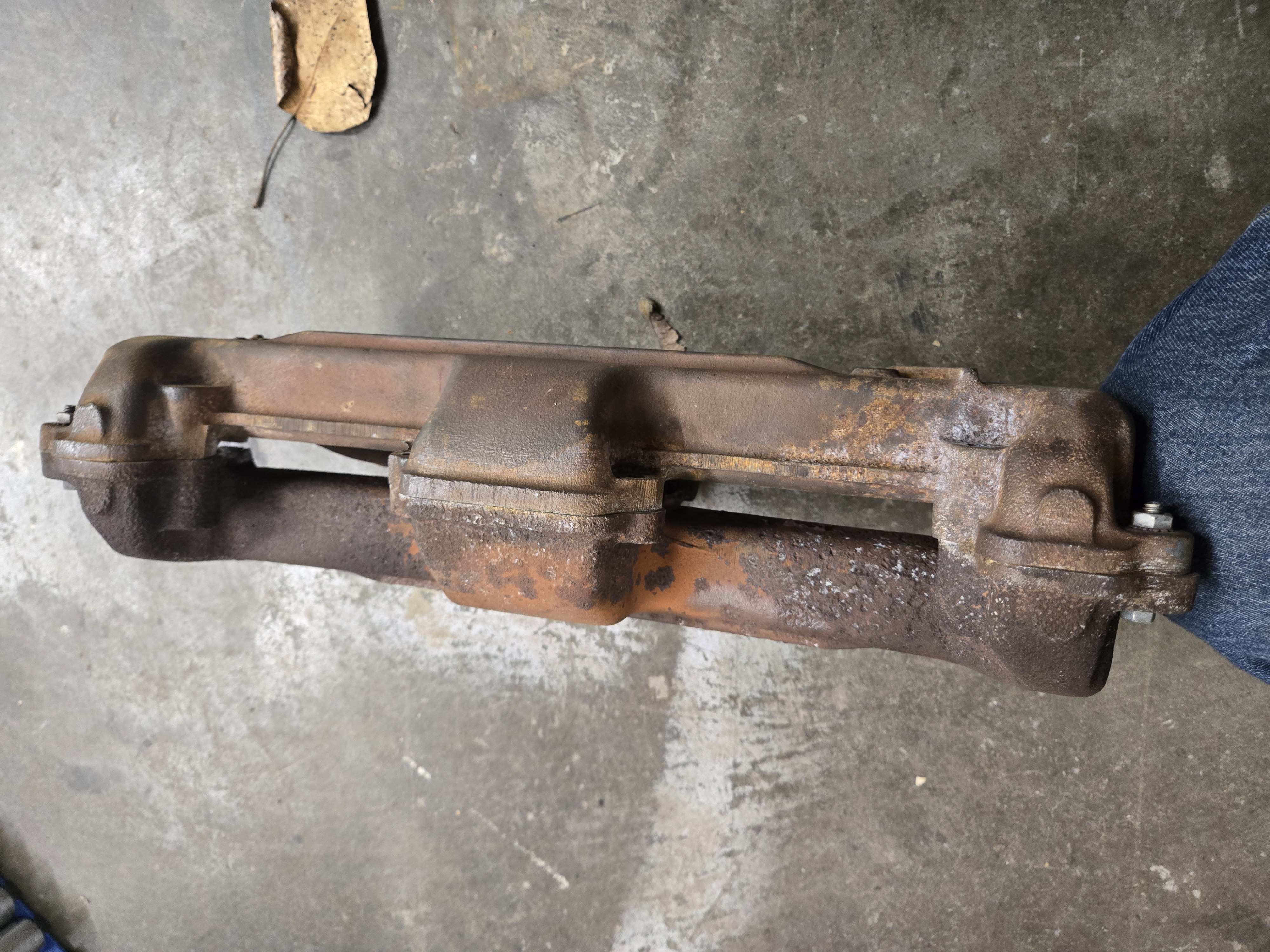

Castings are late 1969 if you zoom in.
The problem I have with selling them is I have a very stout 70 340 with ported and polished heads, adjustable iron rockers, LD340, 72 Thermoquad and the block has main studs and of course full floating connecting rods! The whole engine is balanced and blue printed. And I haven't decided if I want to sell it as a complete package or various components. And I promised Righty Tighty (member here) first right of refusal if I sell it.
