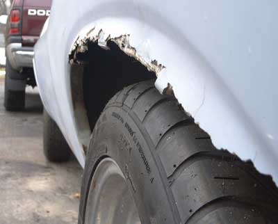

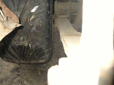

enclosed are some pics of the 18x10s on my old challenger...
You just may get away with the room...
as for tire size, a 275-295 wide tire will be right at home on that 15x10 of yours.
