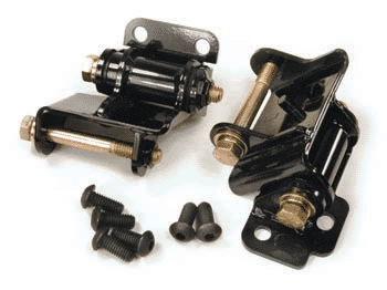

And hemi K frame has a skid plate to protect 6 qt. oil pan. I converted my 71 Cuda to hemi power 20 years ago and bought a K frame from hemispherical products. Don't know if he's still around. Also had to change positive battery cable to starter because 440 cable didn't work. Nothing like looking at a hemi when you open the hood.

I used the old Schumacher conversion mounts to install one of my Hemi's on my 440 K frame.
This is the least expensive option. Schumacher has been around for decades. Conversion mounts
