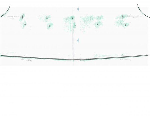

Does anybody know of a template you can purchase to drill the holes for the DODGE letters on a power buldge hood for a '70 challenger? I could make a template but I have no hoods close to me to drill the hole location in the template.

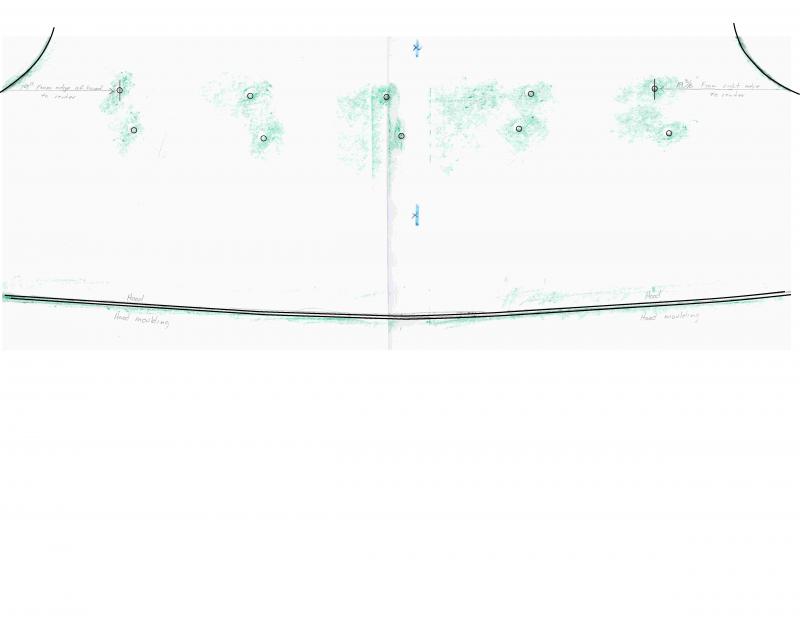

I found a template to use but I added the black lines and circles to make sure it's easy to see. The hardest part is printing it out to scale. I poked holes in it with the DODGE letter to make sure it was the right size and then the curved lines on top still didn't match. But it's a starting point. There's also a listing on ebay for $30. Hood template DODGE letters.jpg
