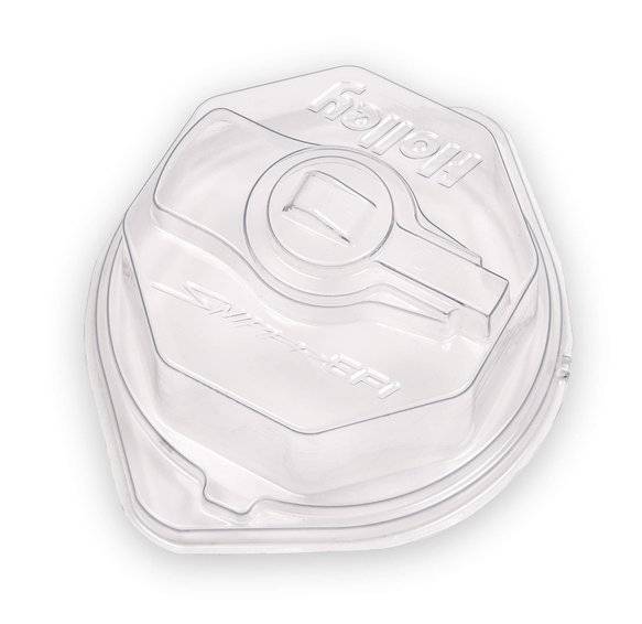

My clear cap to setup Holley Hyperspark has been lost. Out of stock at Holley.

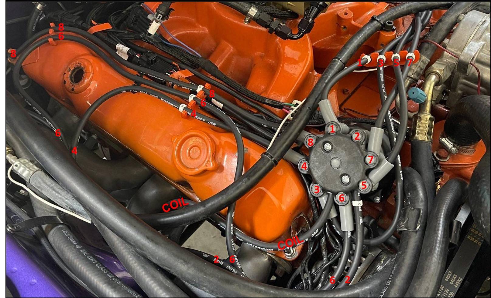

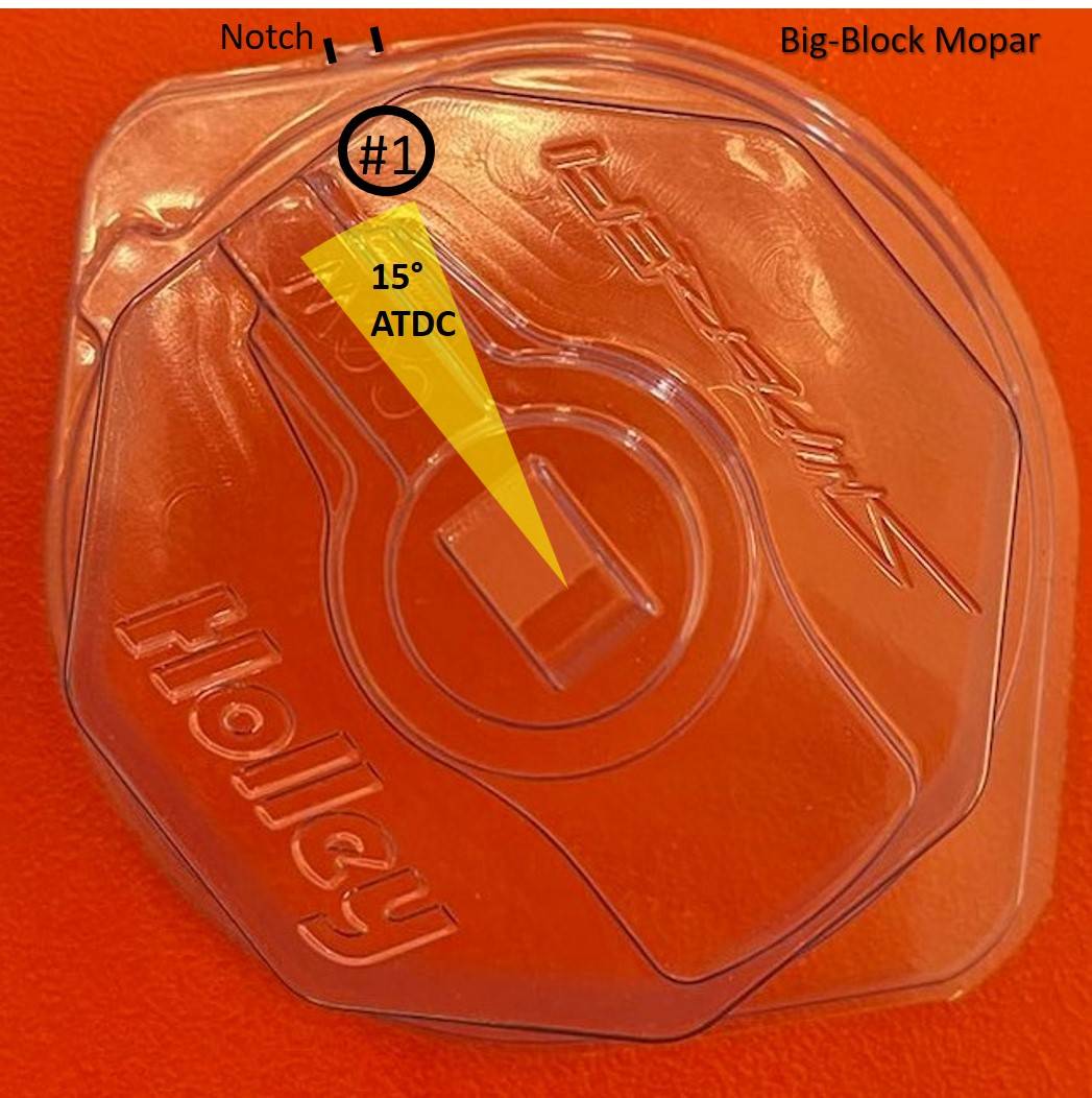

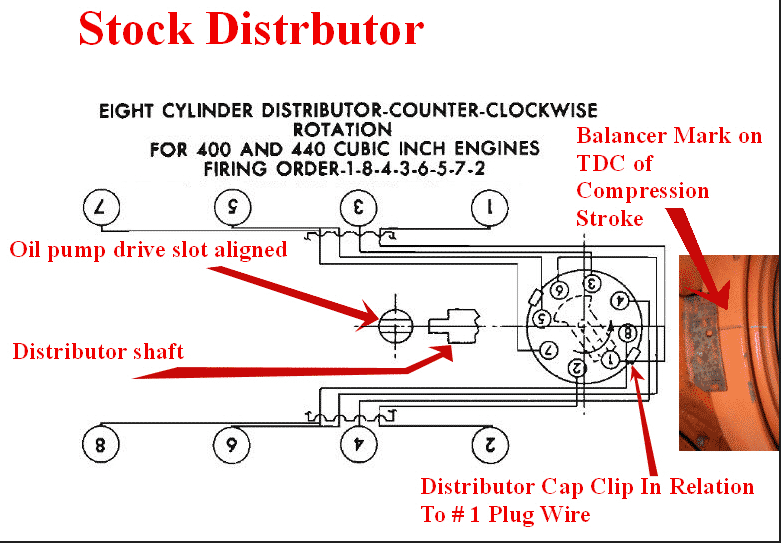

I installed the same distributor with my Terminator X Stealth EFI kit. The pictures with info below should help you to install it without the clear cap. The scale of the 15° arc is not perfect but you get the idea.
FYI - I chose to put my #1 spark plug wire 180° from the factory location so that wires 1, 5, & 7 were closer to those cylinders for better wiring routing. The 15° After TDC rotor position in relation to the #1 spark plug wire remains the same in any orientation.
