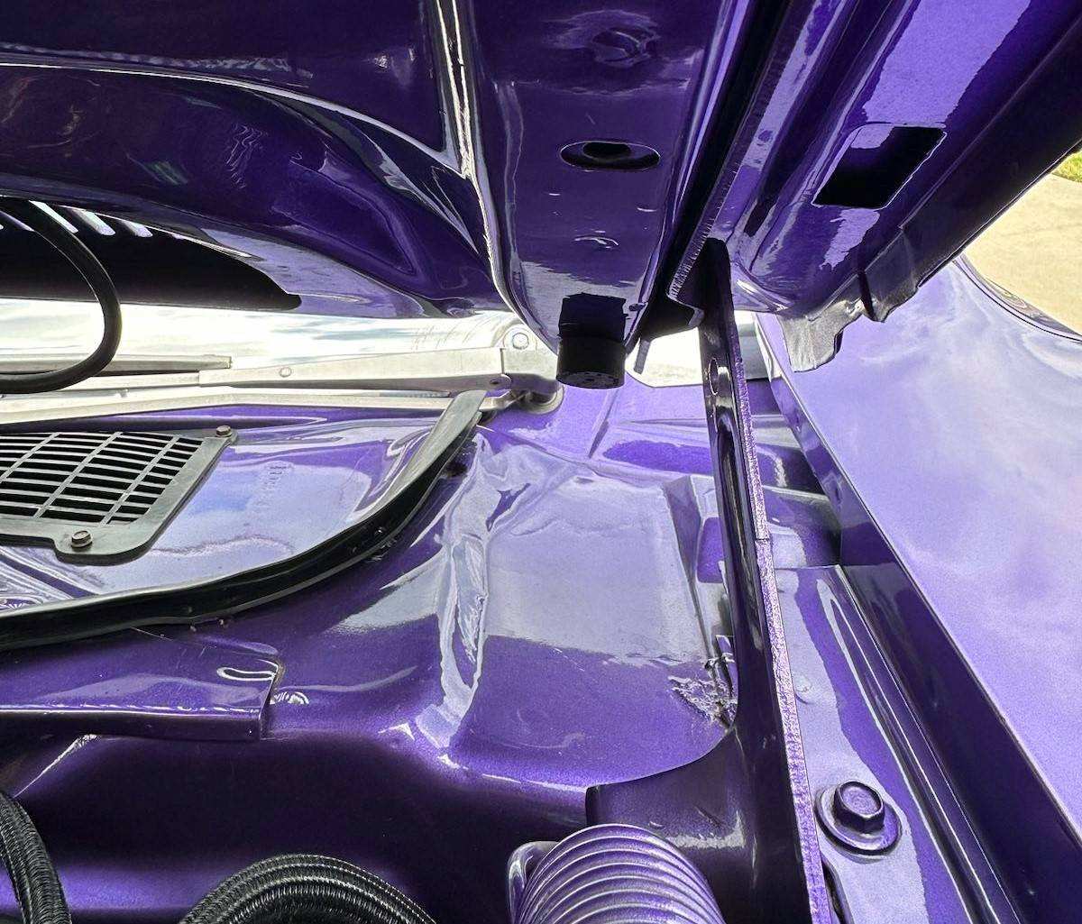

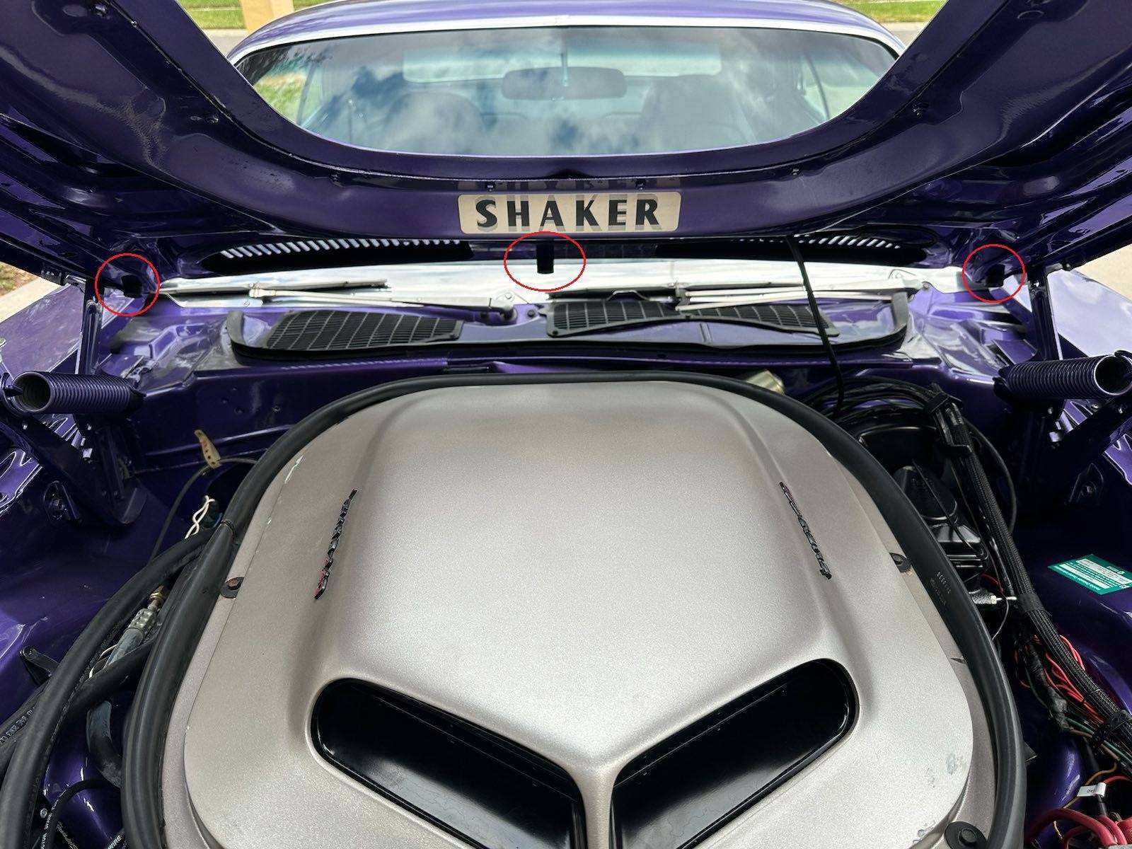

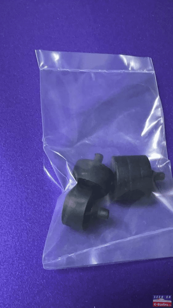

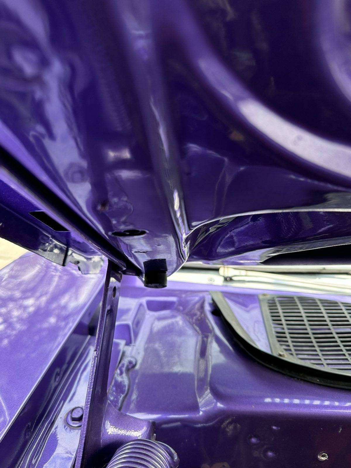

This may help. The bumper in the center is taller. Read this thread in order to get the right kit.
There are kits with three of the same height bumpers and those are incorrect. You need 2 x short for each corner and 1 x tall for the center.
Thread about rear hood bumpers
