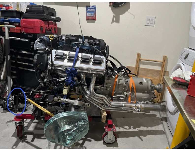

Well since I have the QA1 setup the blue circle shows where the front bolt goes, not much coverage on the frame rail.
