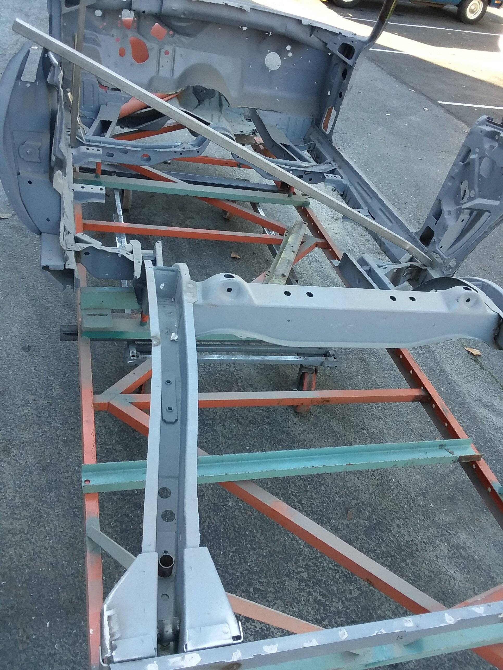

Building a barracuda from a challenger. Cause, I don't do dodges.

It's really no problem. Natural progression from doing front clips, qtr panel, trunk floor together or full floor replacement.
Plus 40 years of heavy collision experience.

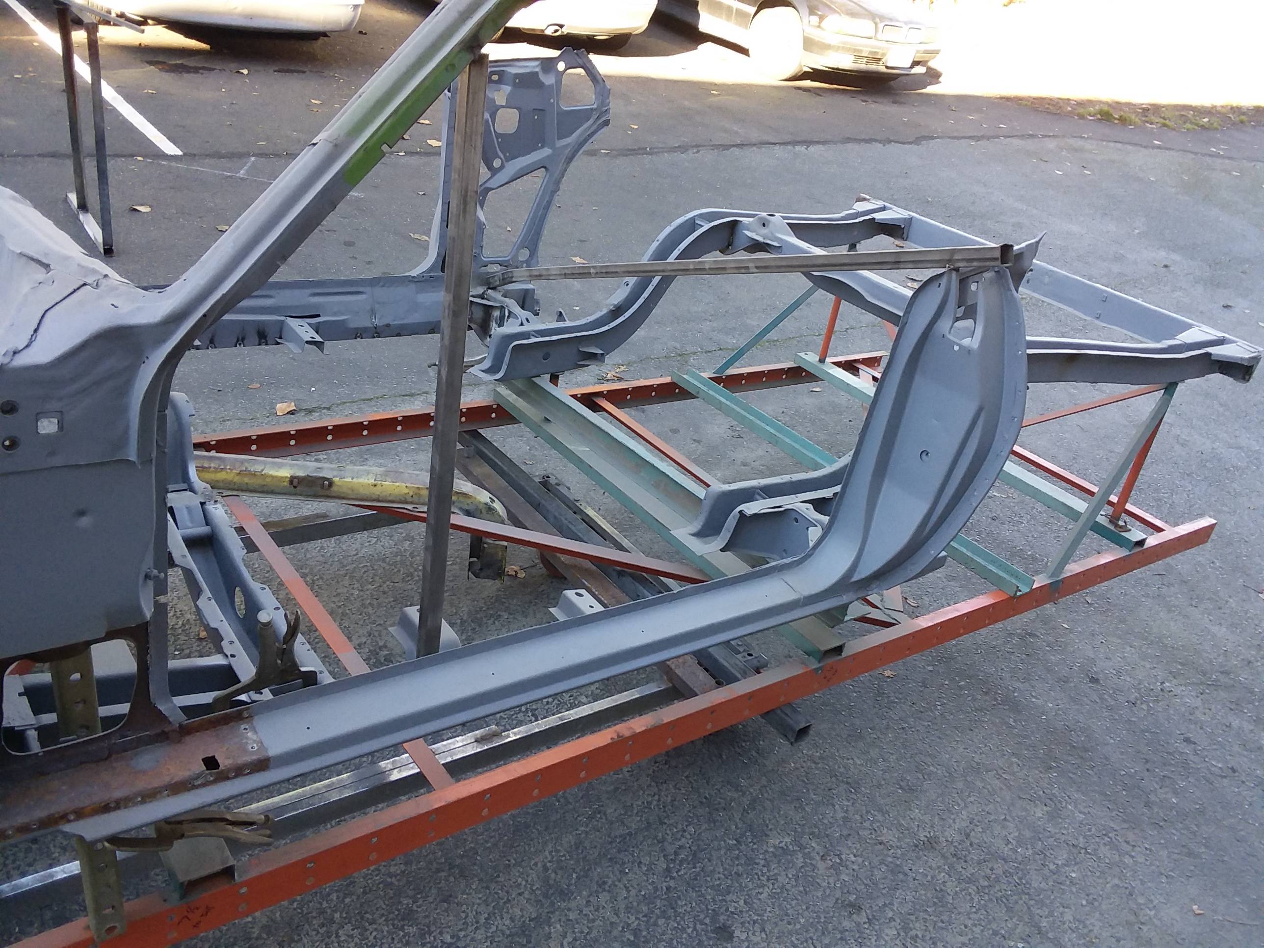

The jig makes it nice. I got the secret datum specs, (saved from being thrown out in 82') made the jig first, and a car dropped right on.

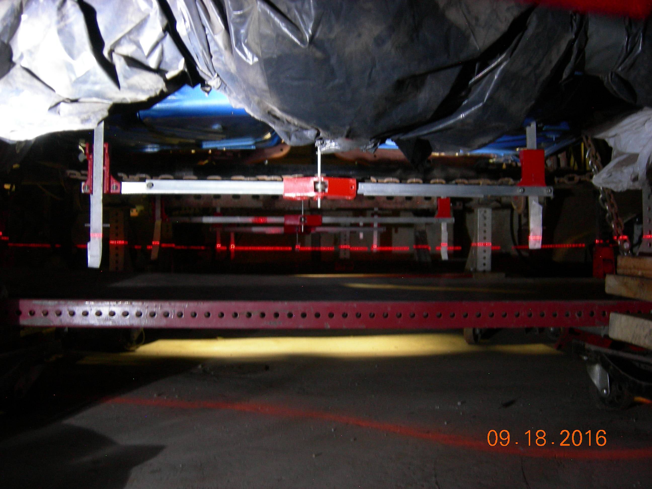

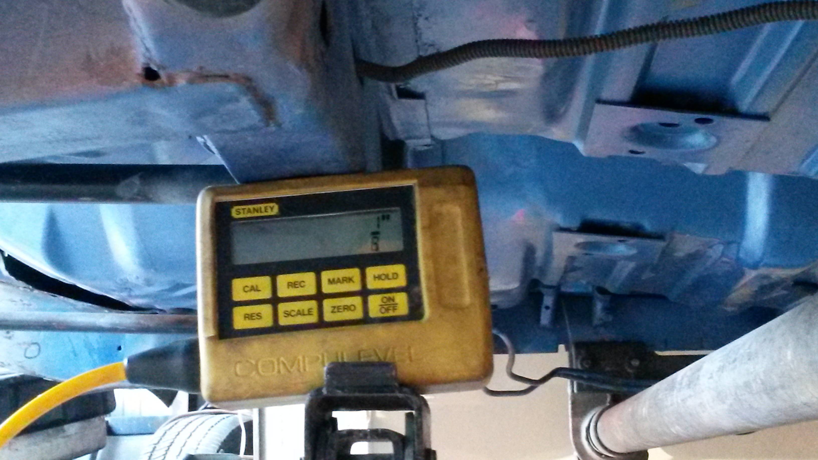

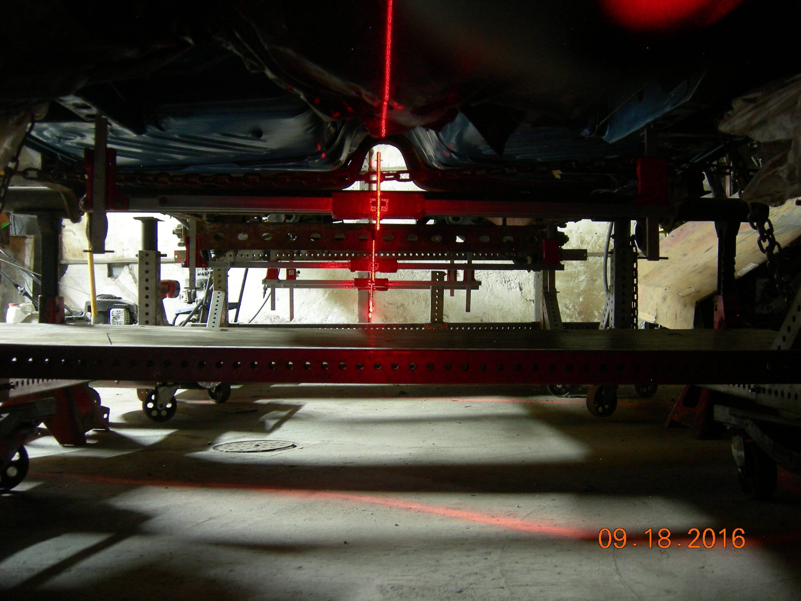

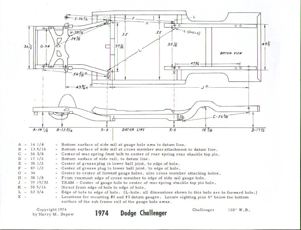

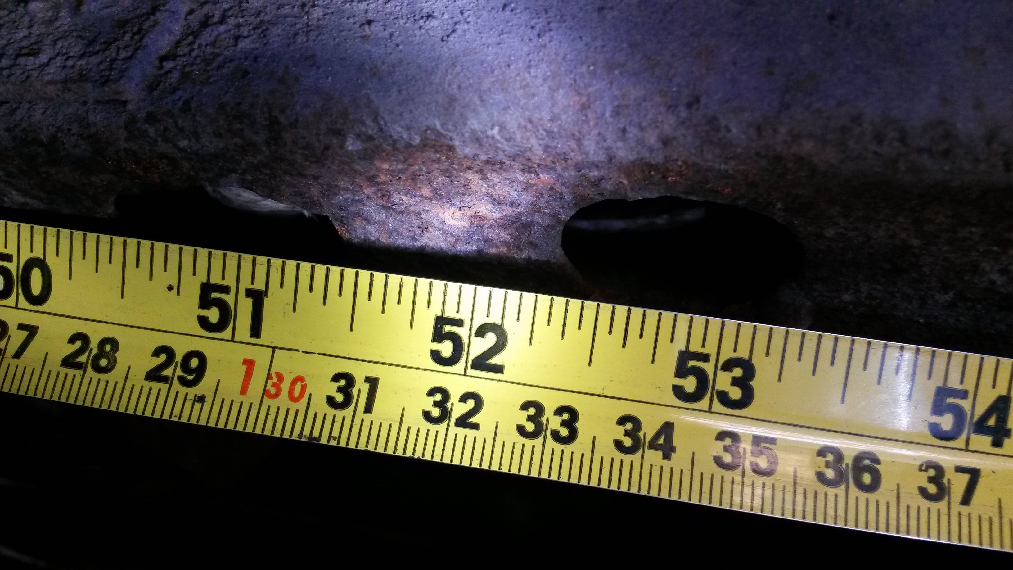

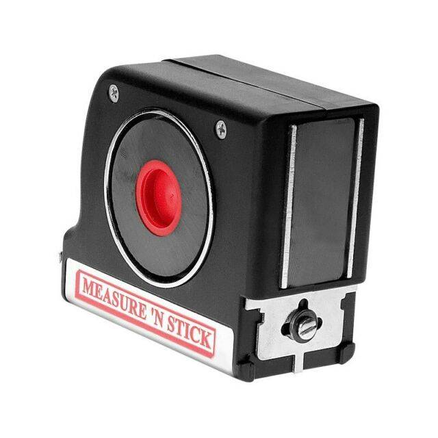

I was wondering when that would come up! I would get the rear floor pans first. I believe that's where it's shorter. While you are at it I would get a rocker panel reinforcement kit.//When you cut the rocker panels and you move the rear section forward. I think you have a plan and understand you need 4 other jig point to sit on. also you might want to have them adjustable (All thread or nut and bolt washer or shims on jig pin) to line up with the front. have front fixed so it won't move.//I can't see everything but it looks like you used the gauge holes. only concern you won' be able to measure or tram.//I would pick up Steck tape
ebay.com/p/1600211734?iid=393097010352 , a laser level inexpensive will do (The set up is what maters) string line and plum bobs.You may already have this stuff.

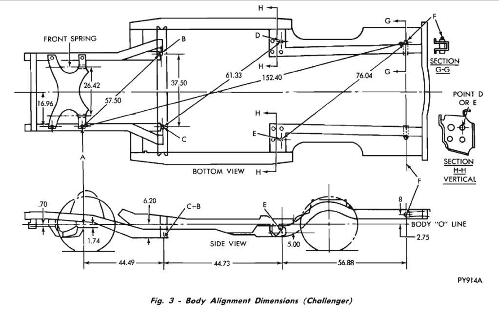

Before you cut. Measure what the car is,so you know where you started and where your going.What you think is right can and will be wrong. thesis cars have error and it has to be matched.//From what I understand the car will have to be assembled from back to front. 1/4 panels dictate door gap. That's how I would approach it.That's where the rear jig preset would help.

See what craws into the gauge holes. I put 1" plugs into all hole when done.2nd frame picture right click on to save.There is a blank frame page to measure before start or damage. 3rd also has datum line on.

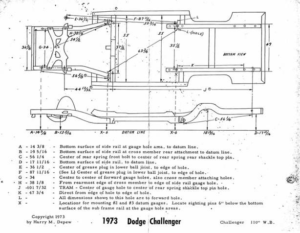

I see Challenger RTA has a blackhawk frame dimensions book also! Yes that's my reference spec.
I laid out the 8 vertical post with large washers at stop points to hold at the right height.
Then slid it up under and non crashed car to confirm. It holds everything so well, there is no guesswork.
The extra length is all behind the drivers seat. So you shorten the rocker assembly that is hidden behind the qtr panel.

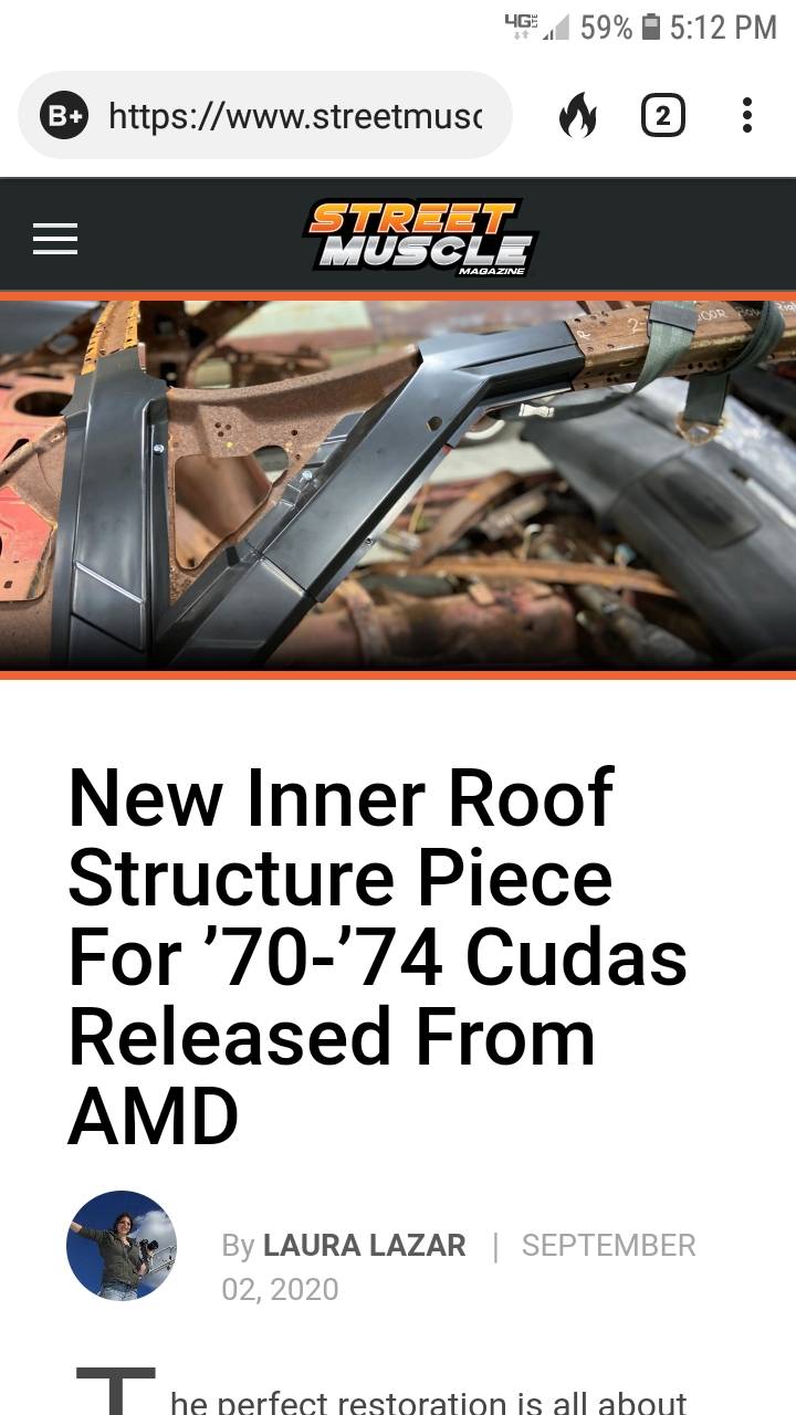

Hi Mr Cuda,
You state: "They are making inner roof structure now, to go with the roof skin." If you don't mind, who is making the inner roof structure? Thank you,

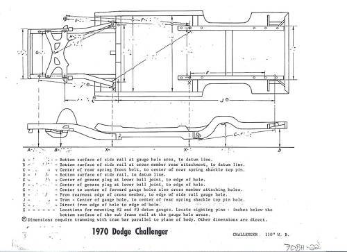

1973 Challenger Datum sheet for those that need one. Found it interesting that some dimensions changed from 1970!

I get emails from AMD. Never bothered to look up a catalog number as this one will have no top. I saw a picture with roof side header, c panel , and structure.
All I could find now was this link
Very interesting. thank you so much Mr Cuda
rallysport
Jul 15, 2017
7
Thank you. I found everything on AMD's site. Cheers!

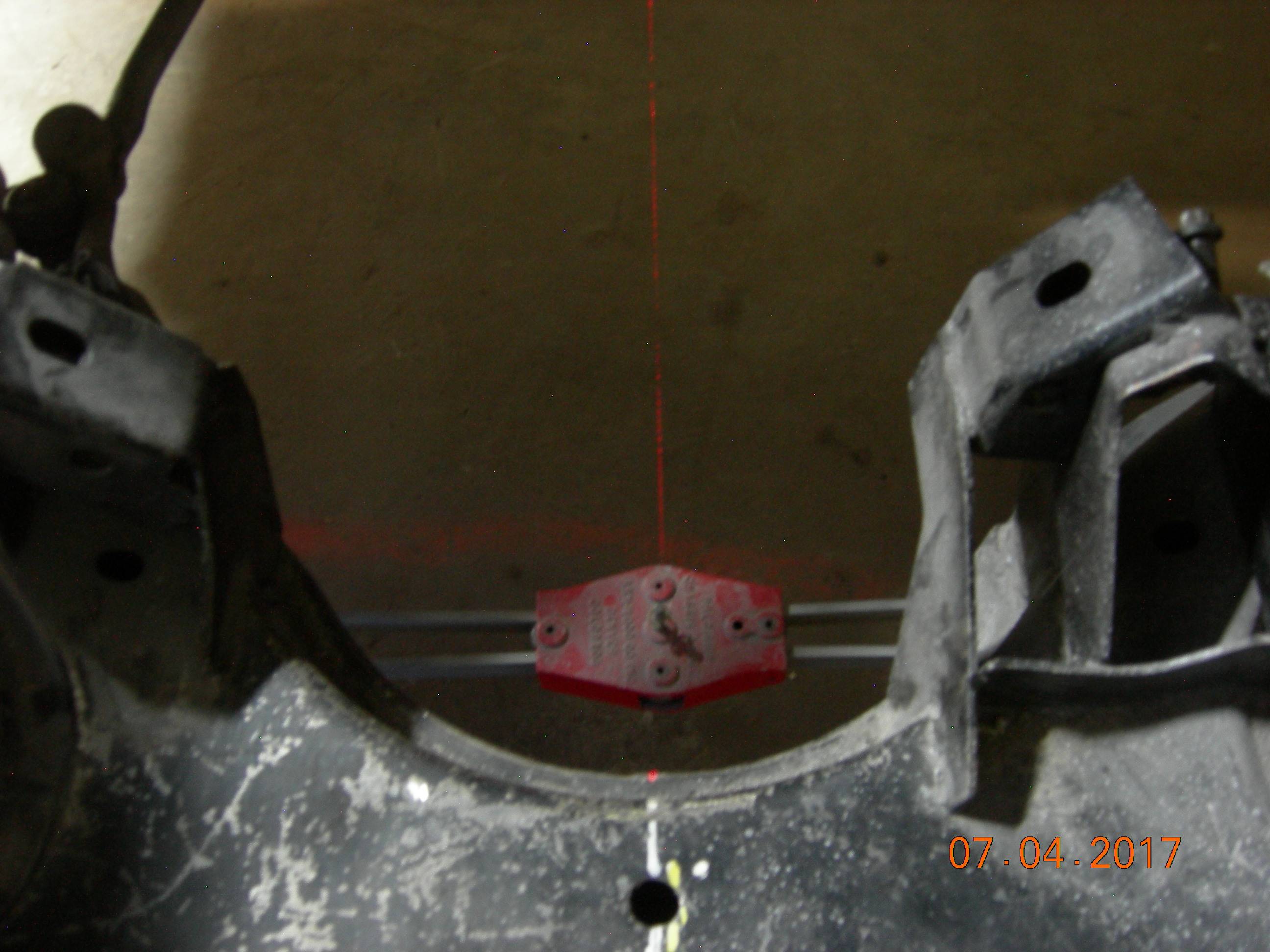

bear sight gages I haven;t seen them in a while
