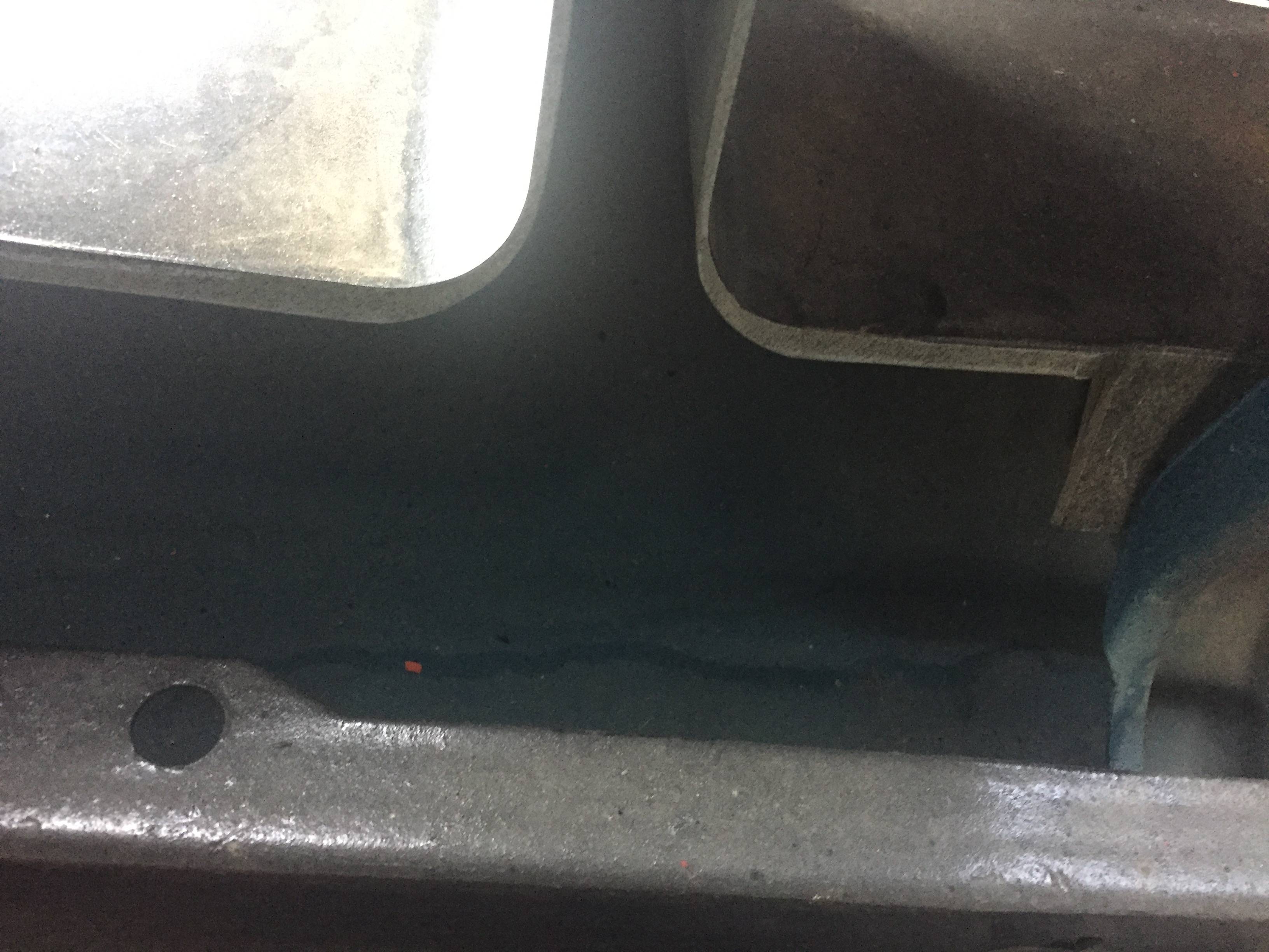

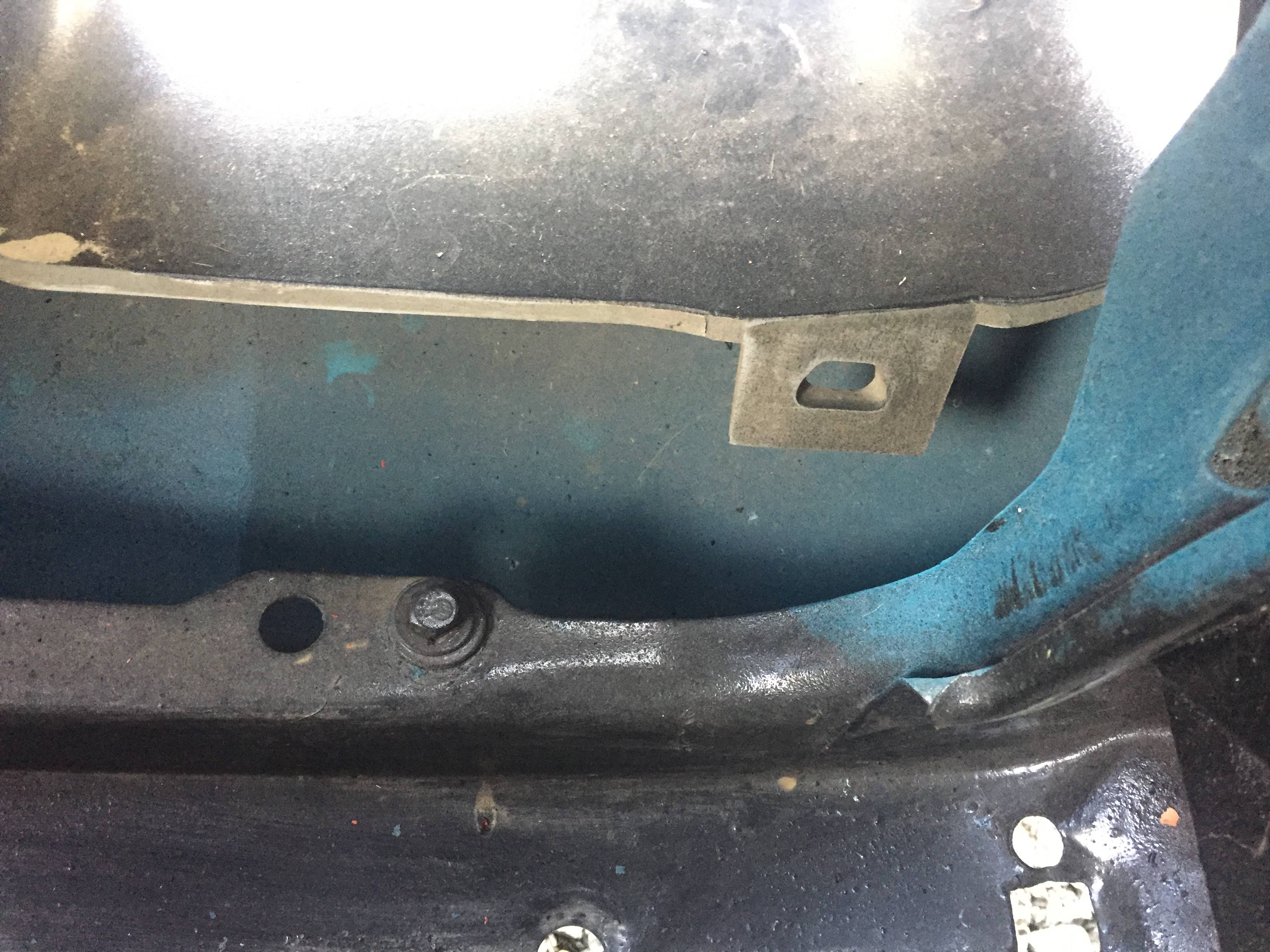

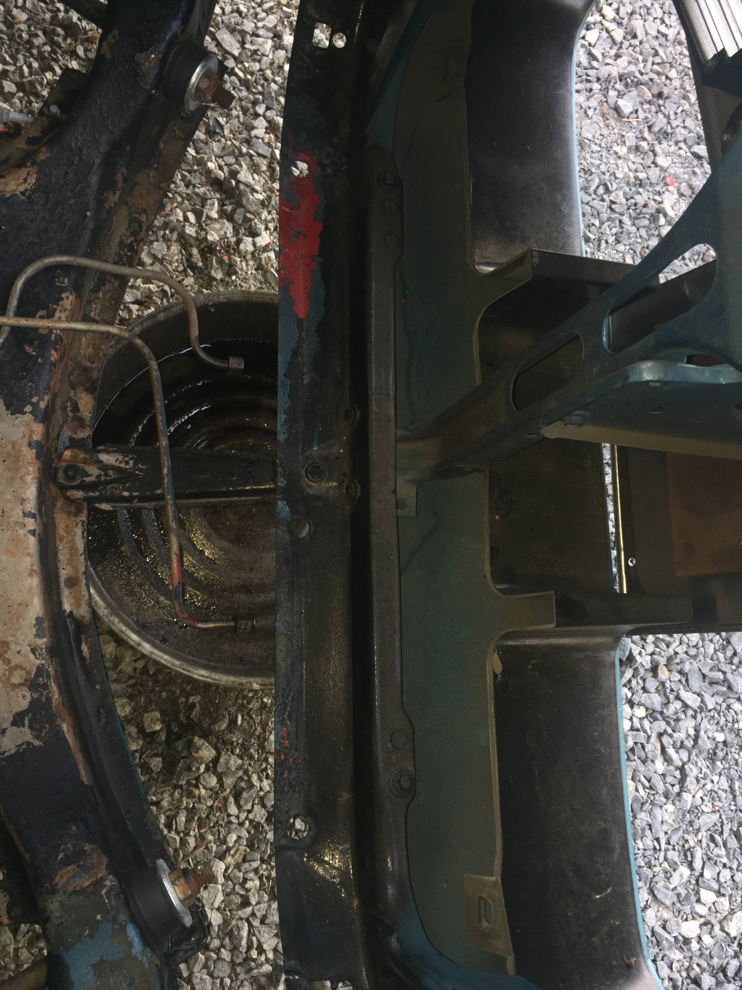

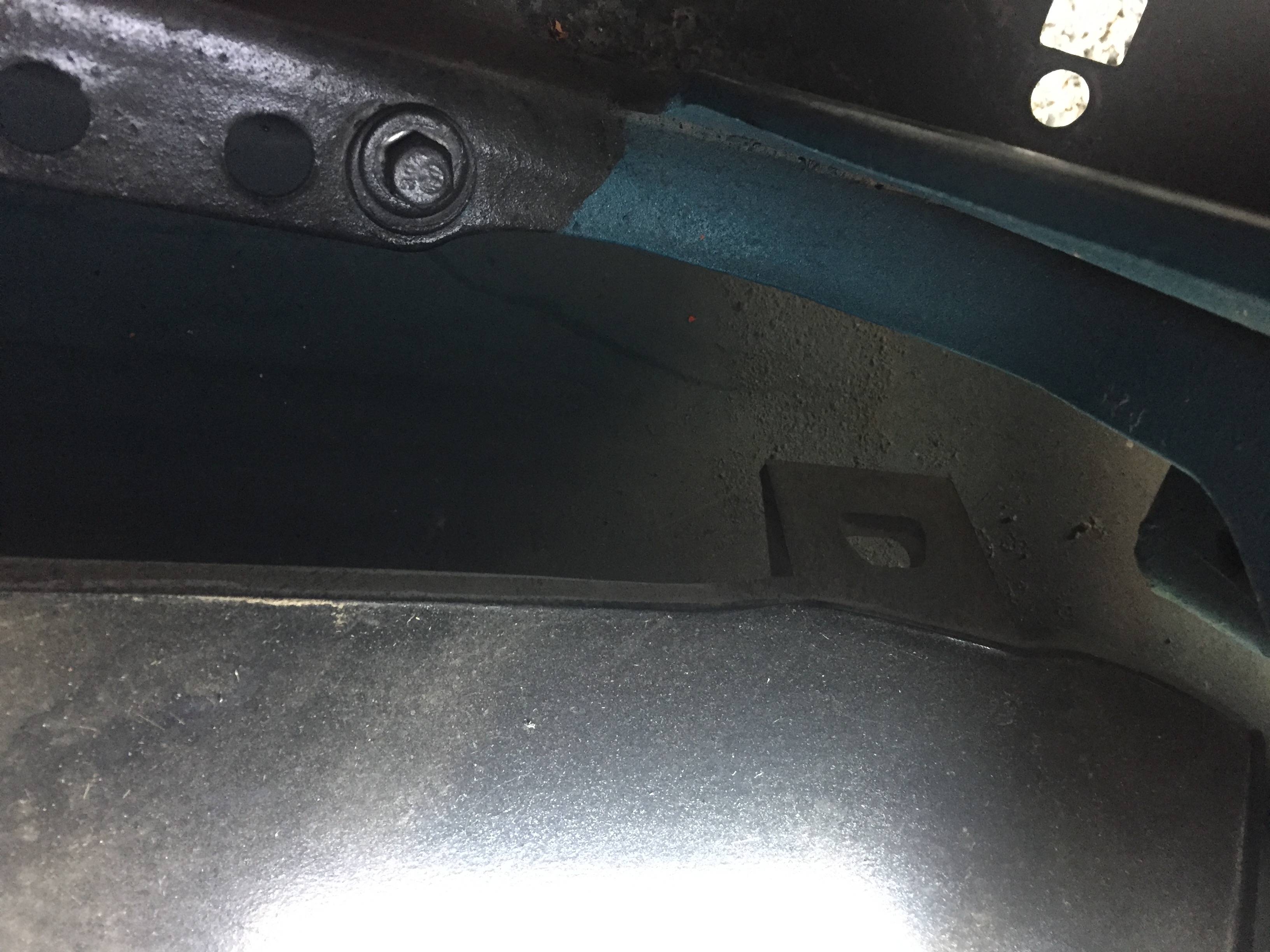

You should post a pic of what you're talking about. You're referring to the part that attaches to the lower valance under the front bumper right? There is no bracket for the tabs on that part, they hook under the lip of the front valance itself.
Here is a few pictures of the tabs and the general area

Okay, I see what you're referring to now. The tabs I was talking about are under the front edge of the valance insert and hook under the edge of the valance. The tabs you are talking about are at the back and yes, there should be some brackets for those to bolt to. My 70 Cuda has them and they are attached to the lower valance itself and bolt to the radiator support. I don't know if the 71 lower valance is the same but I would think it was.
