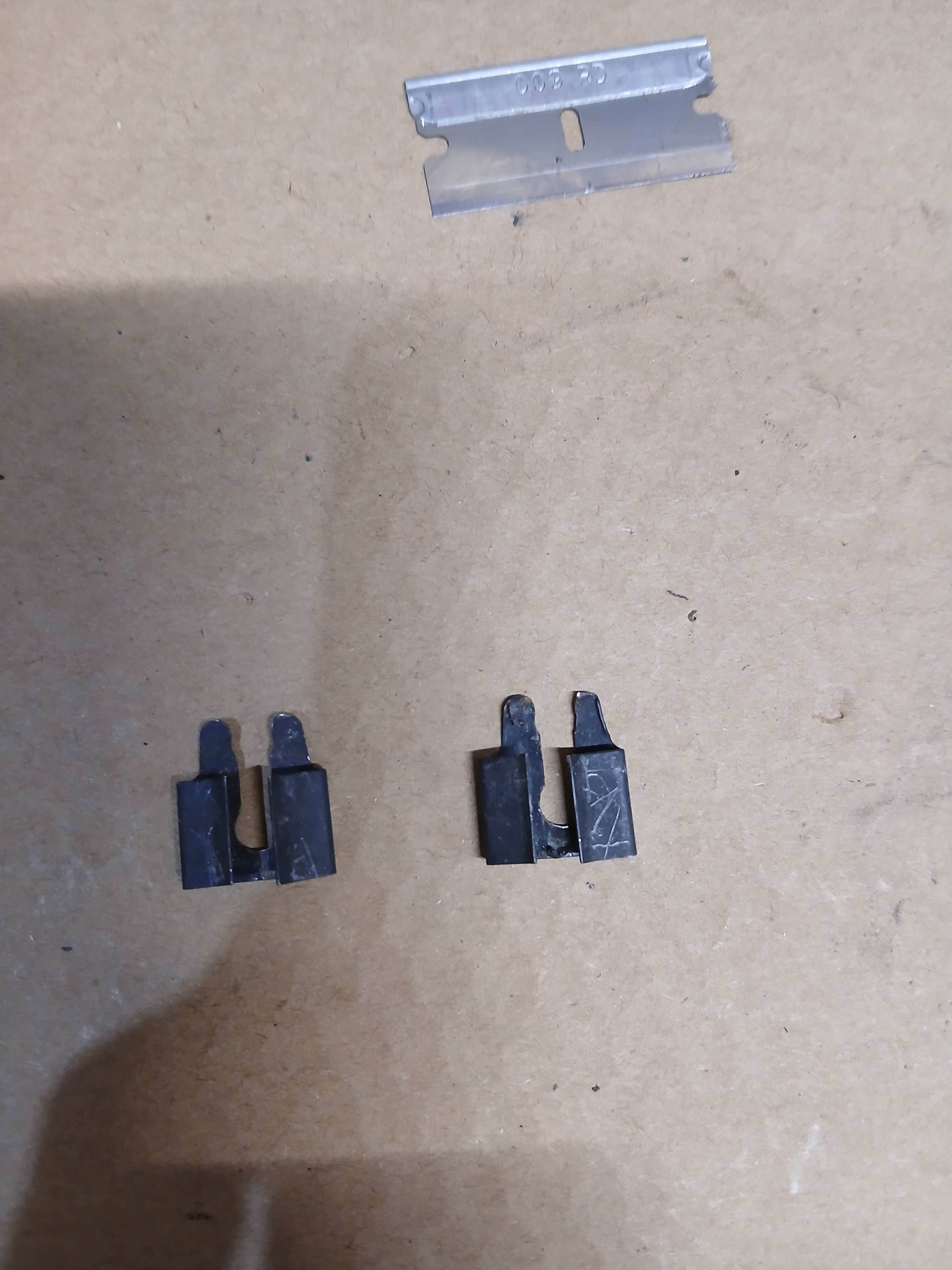

Aug 5, 2025 #1 G gran coupe john Well-Known Member Joined Aug 15, 2023 Messages 745 Reaction score 219 Location Ohio These were with the inside door lock. Don't know where they go, or how they go on
Aug 5, 2025 #2 MOPARMITCH Well-Known Member Joined May 6, 2013 Messages 637 Reaction score 197 Location Friendship,Maryland Linkage clips for door lock and door open mechanisms.....
Aug 5, 2025 #3 G gran coupe john Well-Known Member Joined Aug 15, 2023 Messages 745 Reaction score 219 Location Ohio Do you got pic how they go on?
Aug 5, 2025 #4 MOPARMITCH Well-Known Member Joined May 6, 2013 Messages 637 Reaction score 197 Location Friendship,Maryland Not handy, But they slide on to the squared ends of the linkage rods, and hold them fast to their attaching points....

Aug 5, 2025 #5 J Jeff K Member Joined Oct 20, 2017 Messages 12 Reaction score 13 Here's a pic (not mine) of the back side once installed. The open slot in the middle of the clip is designed to snap in a groove that's cut into the end of the linkage rod.
