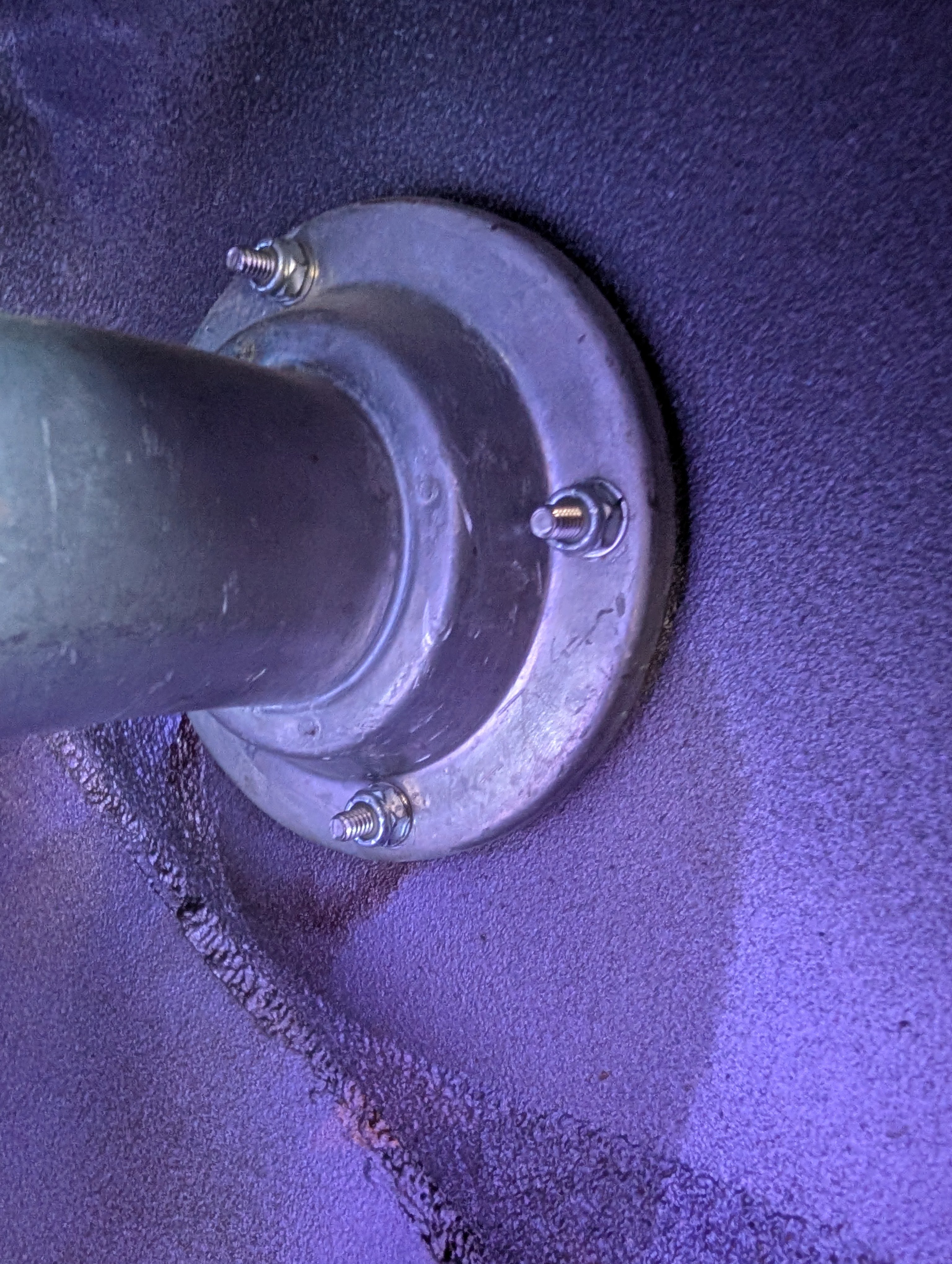

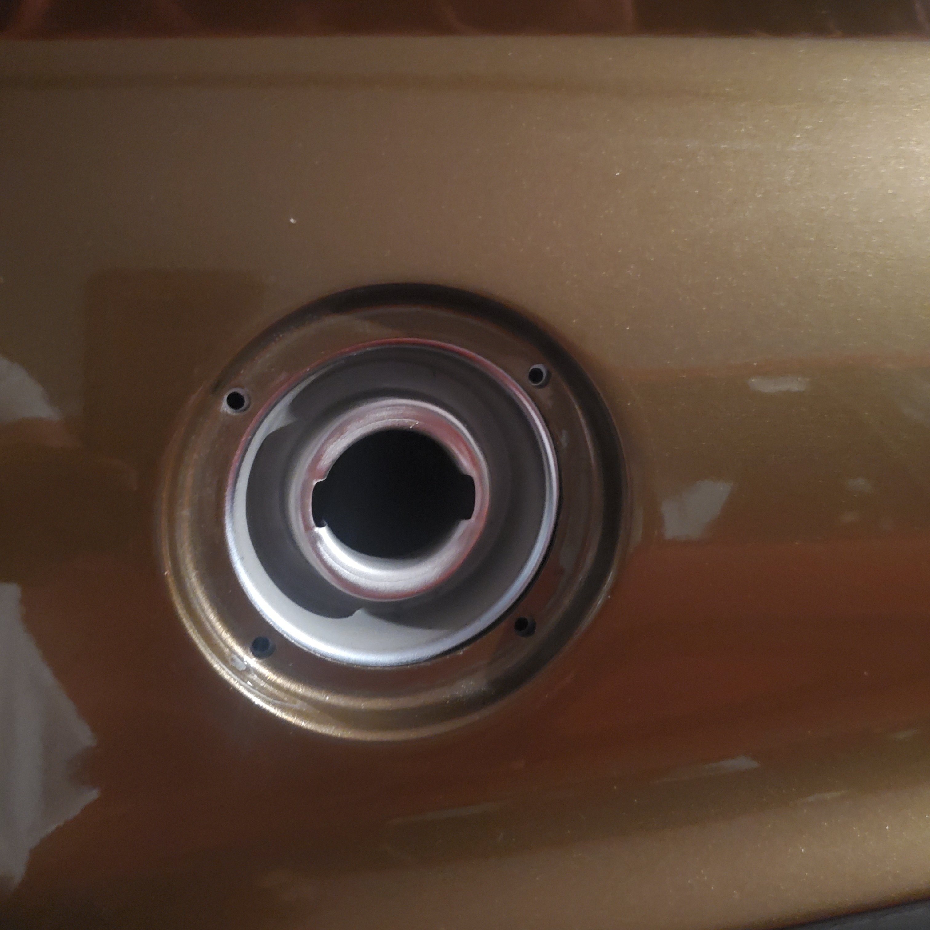

Ok after finally wrestling the filler neck tube into grommet/gas tank, can anyone tell me what size the 4 bolts/screws are that mount the filler neck tube to quarter panel. Im going to install the after market flip top cap. Thanks ahead of time

The filler tube is aftermarket, im gonna check threads tomorrow. I thought one of the last cars i had, had screws in there. Unfortunately this car was unassembled
