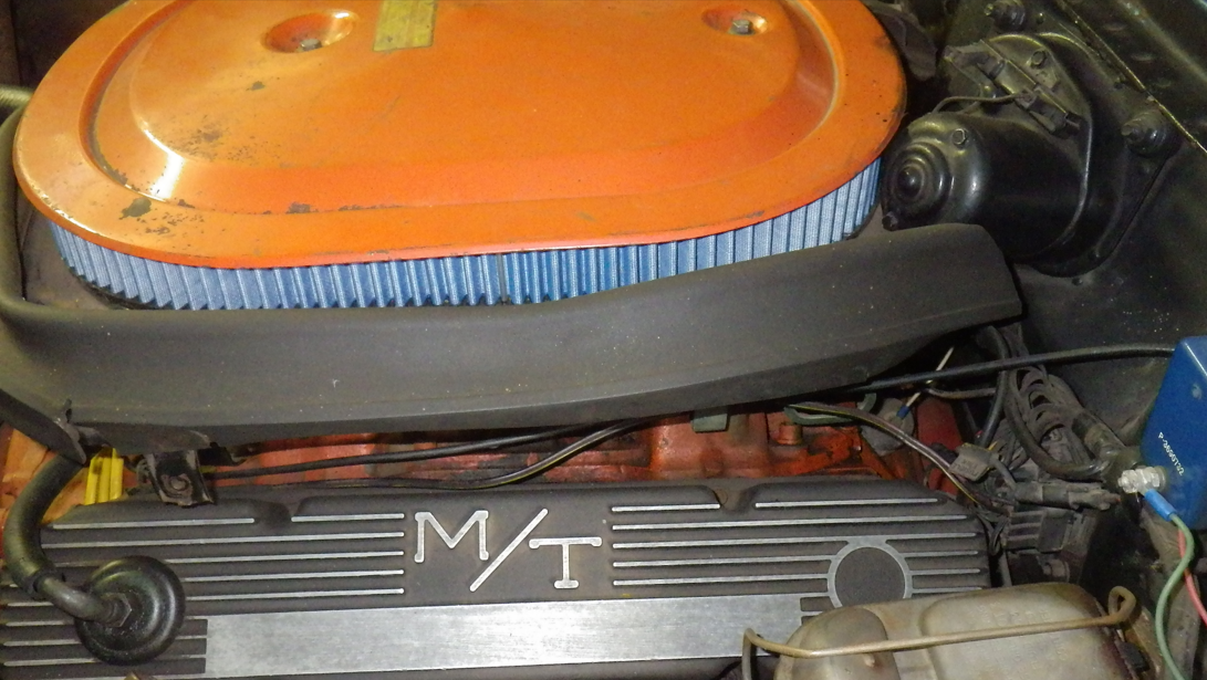

Hi Guys,
I’m looking for an oval air filter 1 3/4” tall for an air grabber or ramcharger setup.
The two filters (6 Barrel)I have measure 2.05 and too tall for the studs. My set up is now a single 4 barrel. I could modify but, I’d rather find a filter.

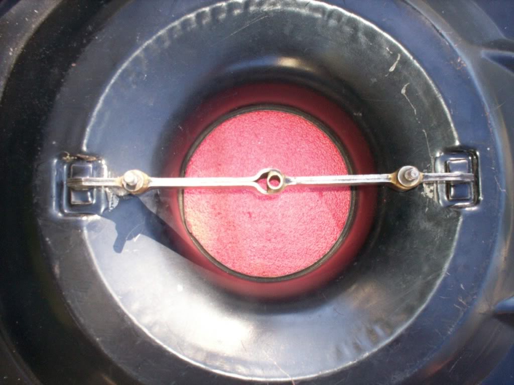

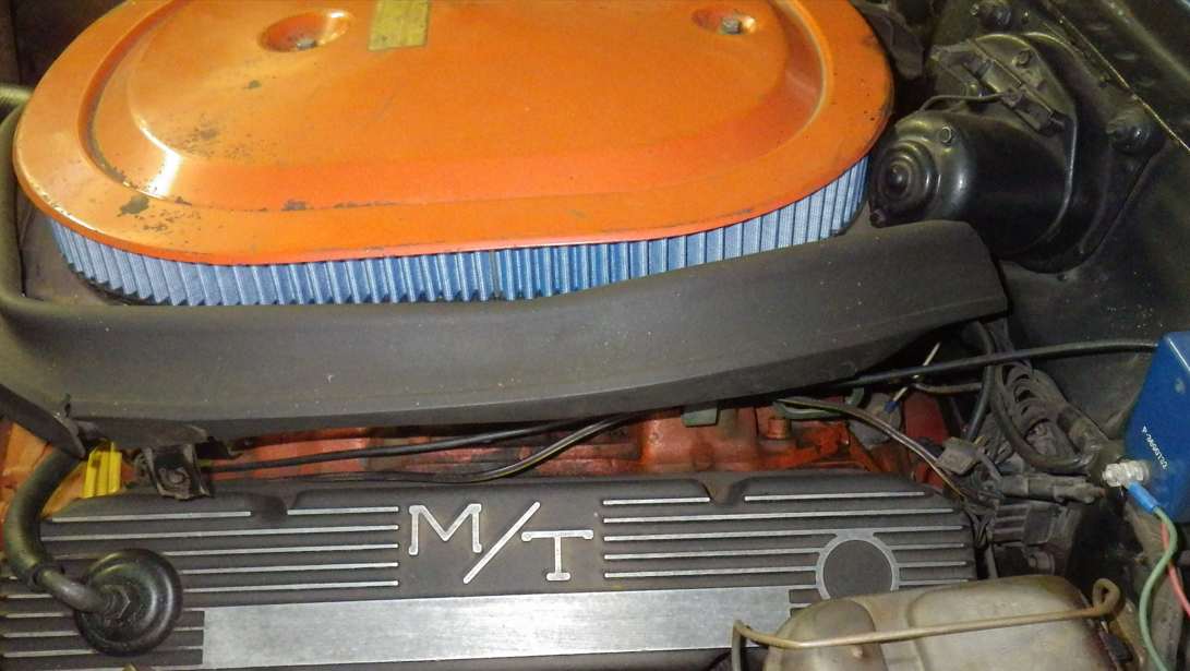

You sure the center bar isn't bent down?
Someone had cut off the center bar on mine.
I found another luckily and epoxied it in. Had to tweak the height to get it right,

I was looking at the center bar and thinking the same thing
Haven’t measured it yet but, did some light messaging on the holes. Right now I have the regular filer in and two nuts started.
Gonna let rest there for a bit.

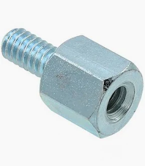

How about bolts? I used them on my '69.

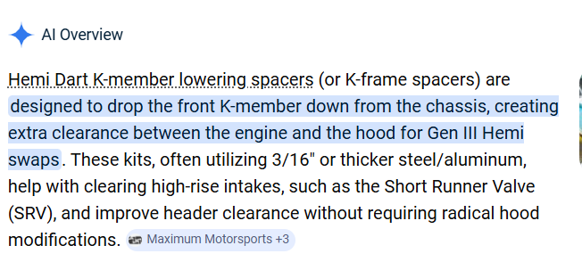

An "out of the box" option might be K-frame spacers, maybe 3/8".

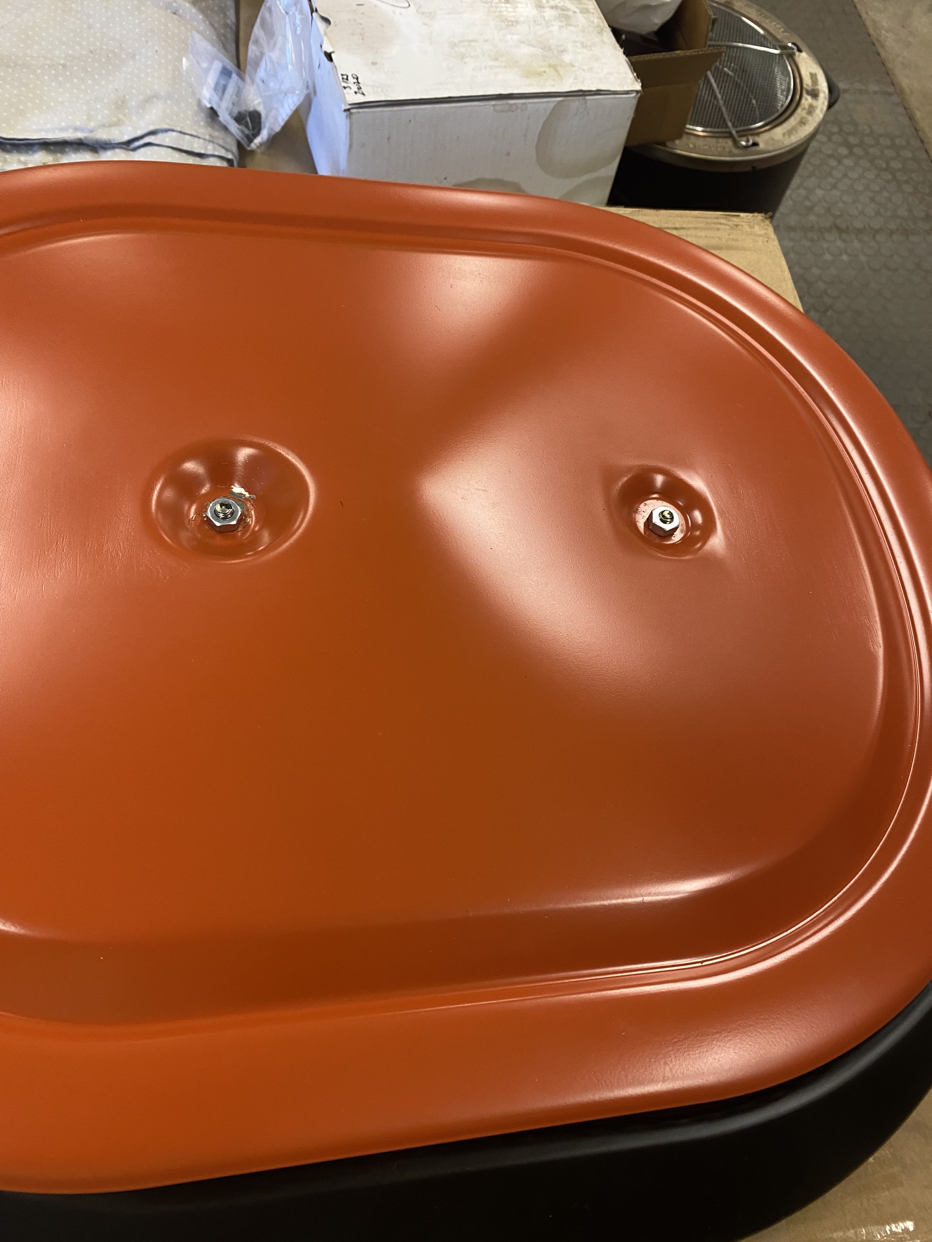

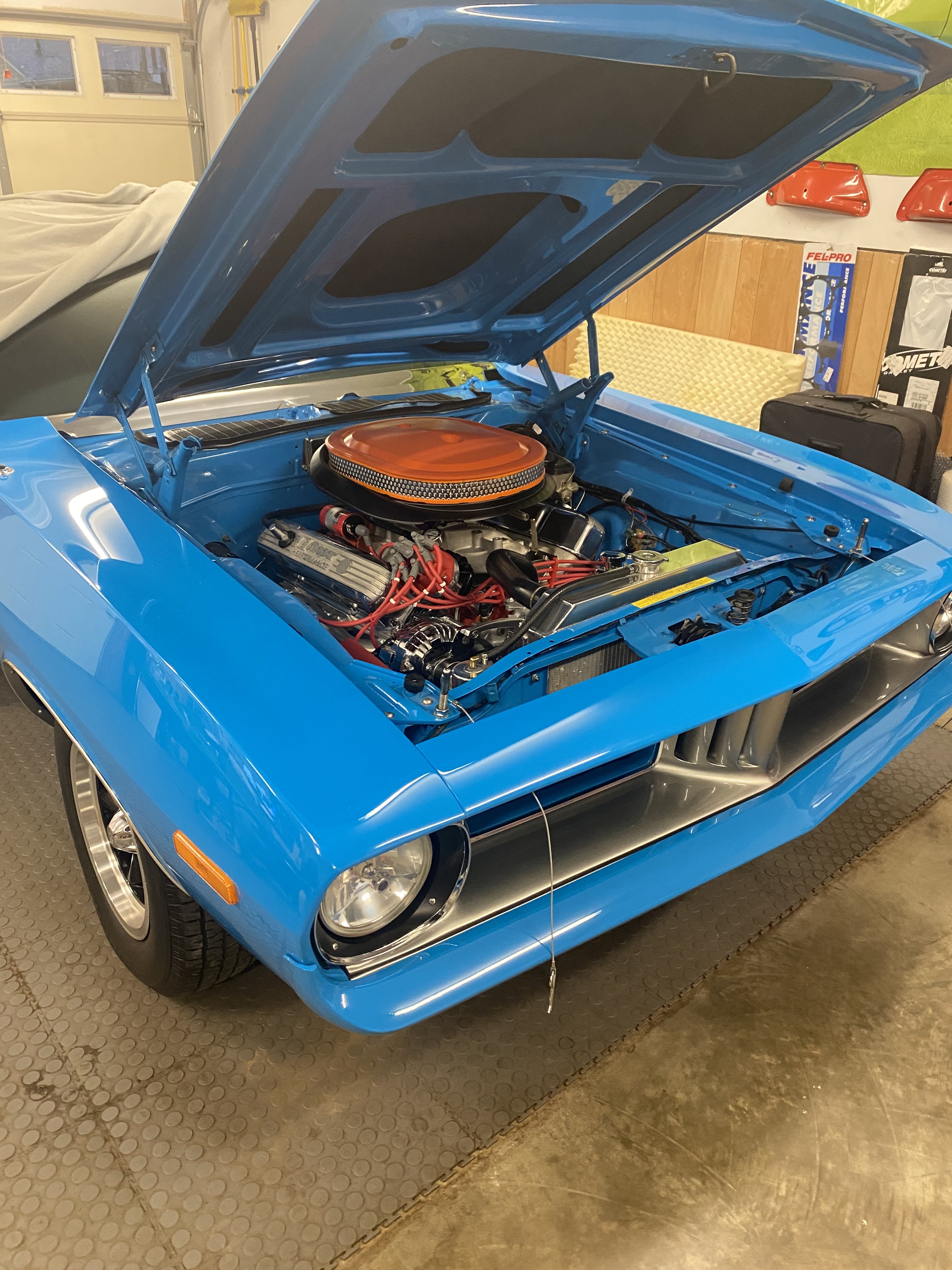

On this situation. It’s just a matter of the studs on the could use a few more threads.
And with it being re-Pop, could be off a little. That 1 3/4 filet would be perfect.
I’ve messaged the holes on the lid slightly and have it together now.
Just be nice to have more than a couple of threads left.
