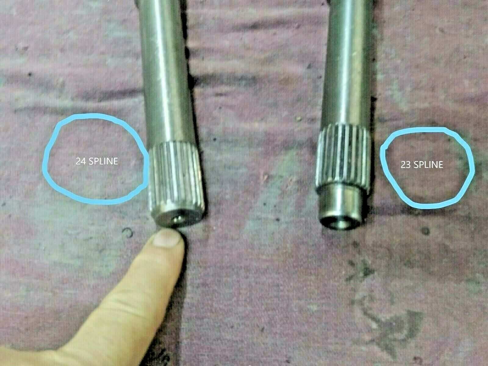

Matt68

@marksmopars you do mean 24 spline, not 23, correct? What's the difference in 23 vs 24 spline applications? How can I know which one I need with dropping the trans?
23:24 spline.jpeg

NOTE: Assuming no changes to original input shafts in the transmission in the following listing.
The 1962-1966 A727 Torqueflite input shaft has 19 splines.
The 1967- 1977 A727 Torqueflite and 1978-1991 A727 Torqueflite with non-lockup converter input shaft has 24 splines.
The 1978-1990 A727 Torqueflite with lockup converter input shaft has 23 splines plus a smooth machined area without splines at the nose of the shaft.
The A518 Torqueflite with overdrive, that replaced the A727, input shaft also has 23 splines.
The 1960-1967 A904 Torqueflite input shaft has 18 splines.
The 1968-1977 A904 Torqueflite input shaft has 27 splines.
The 1978~2002 A904, including A998 and A999, Torqueflite with lockup converter input shaft has 26 splines plus a smooth machined area without splines at the nose of the shaft.
The A500 Torqueflite with overdrive, that replaced the A904, input shaft also has 26 splines.

I think Vaanth put it as clear as possible, it appears he has more information on this than I do so I bow to his expertise and offer my thanks to him for the information.
