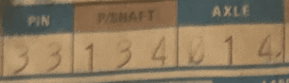

Jul 23, 2025 #1 Kansan Well-Known Member Joined Jul 3, 2025 Messages 240 Reaction score 105 Location Arkansas Can anyone help me ID the original rear end from my 73 Cuda based on the below information? Thanks in advance.
Jul 25, 2025 #2 Xcudame Well-Known Member Joined May 27, 2023 Messages 2,797 Reaction score 2,096 Location Southeast Arizona 8 3/4" Suregrip (489 case - 1 7/8" pinion) with 355 gears. Propeller shaft (drive line) confirms 8 3/4" rear also.
Jul 25, 2025 #3 Kansan Well-Known Member Joined Jul 3, 2025 Messages 240 Reaction score 105 Location Arkansas Xcudame said: 8 3/4" Suregrip (489 case - 1 7/8" pinion) with 355 gears. Propeller shaft (drive line) confirms 8 3/4" rear also. Click to expand... Awesome....Thank you...I can find all kinds of ways to decode 1970 broacast sheets but not so much for 1973. Kansan
