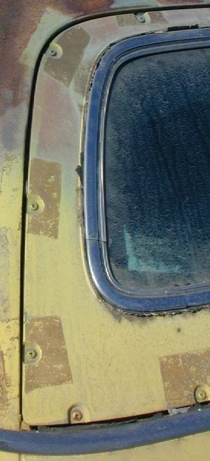

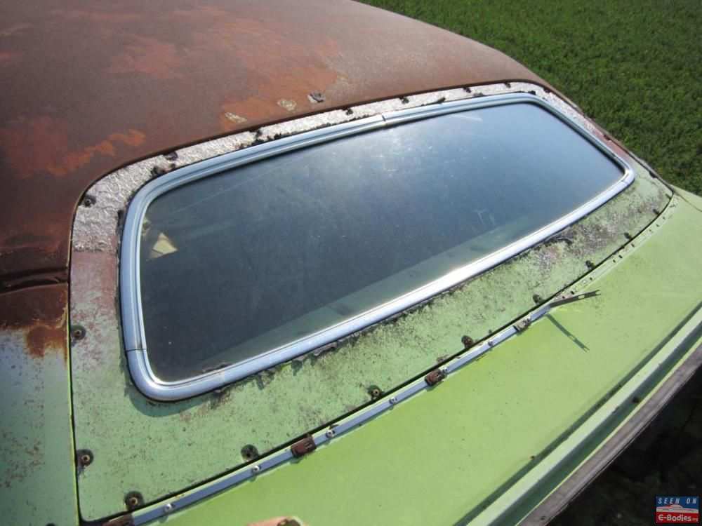

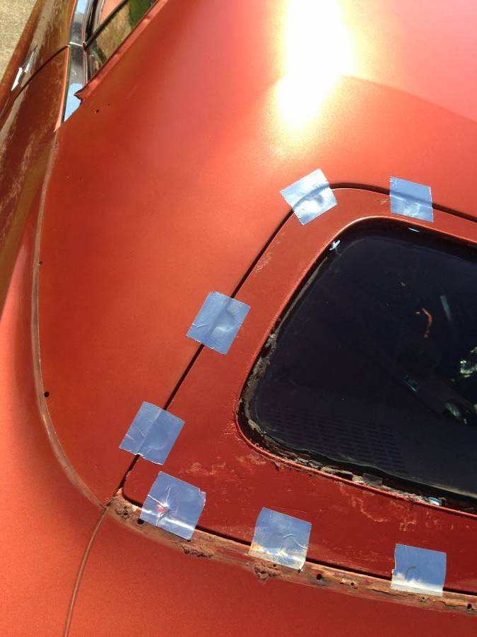

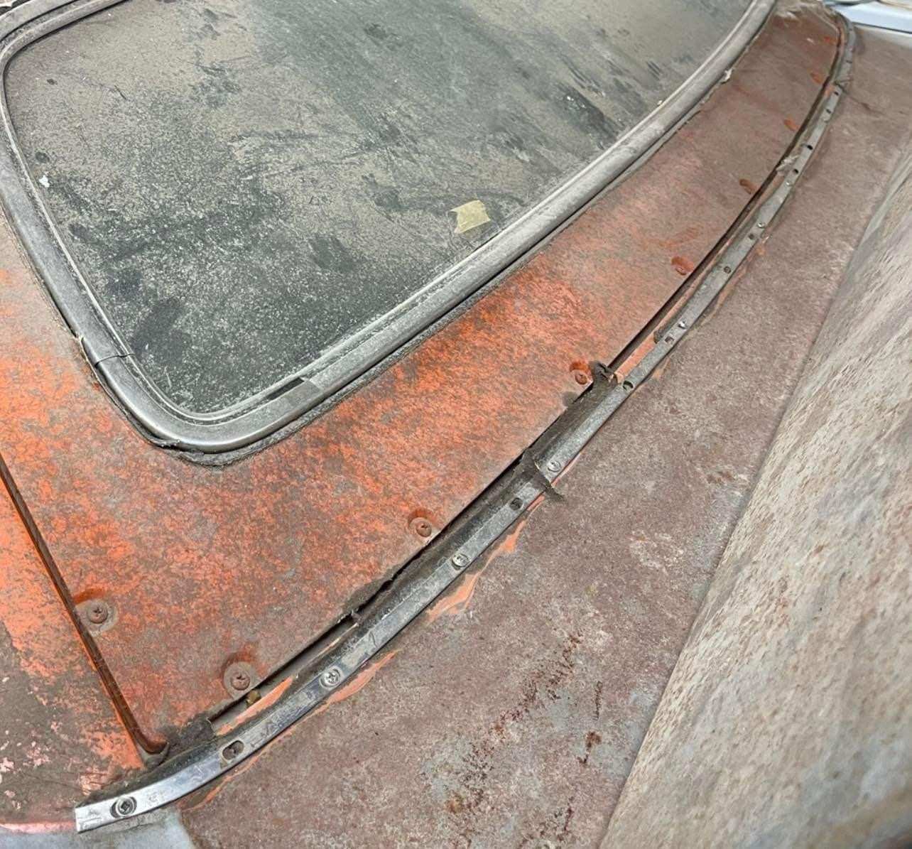

I'm about to put a new top on mine. Here are some pics I've saved for reference. I don't believe seam sealer was used originally between plug and window, but I can't see it being a bad idea. There was padding added around the plug to keep it flush with the rest of the roof, and foil tape was used over the screw holes. And originally there was an extra stainless 'keeper' strip to help hold the top down, under the vinyl top trim.

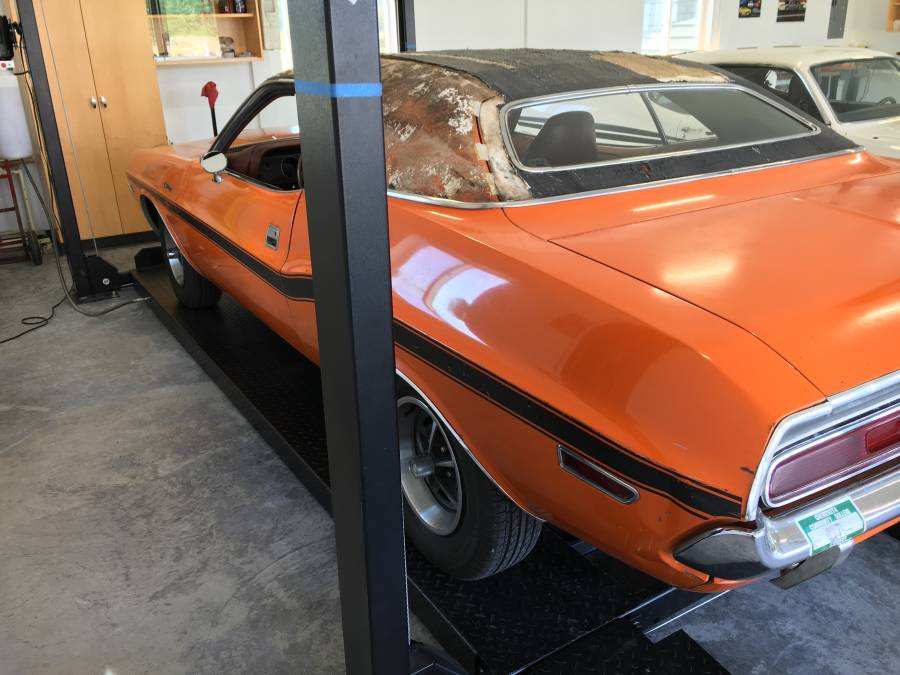

On the orange car and the sublime car above you can just see remnants of the padding. The only other photos I have saved are these, which is what the padding was supposed to look like, I believe. An open cell padding.

I don't have a picture at the moment, but for mine the whole perimeter gap between the plug and the body was tapped over with aluminum duct wrapping tape.
