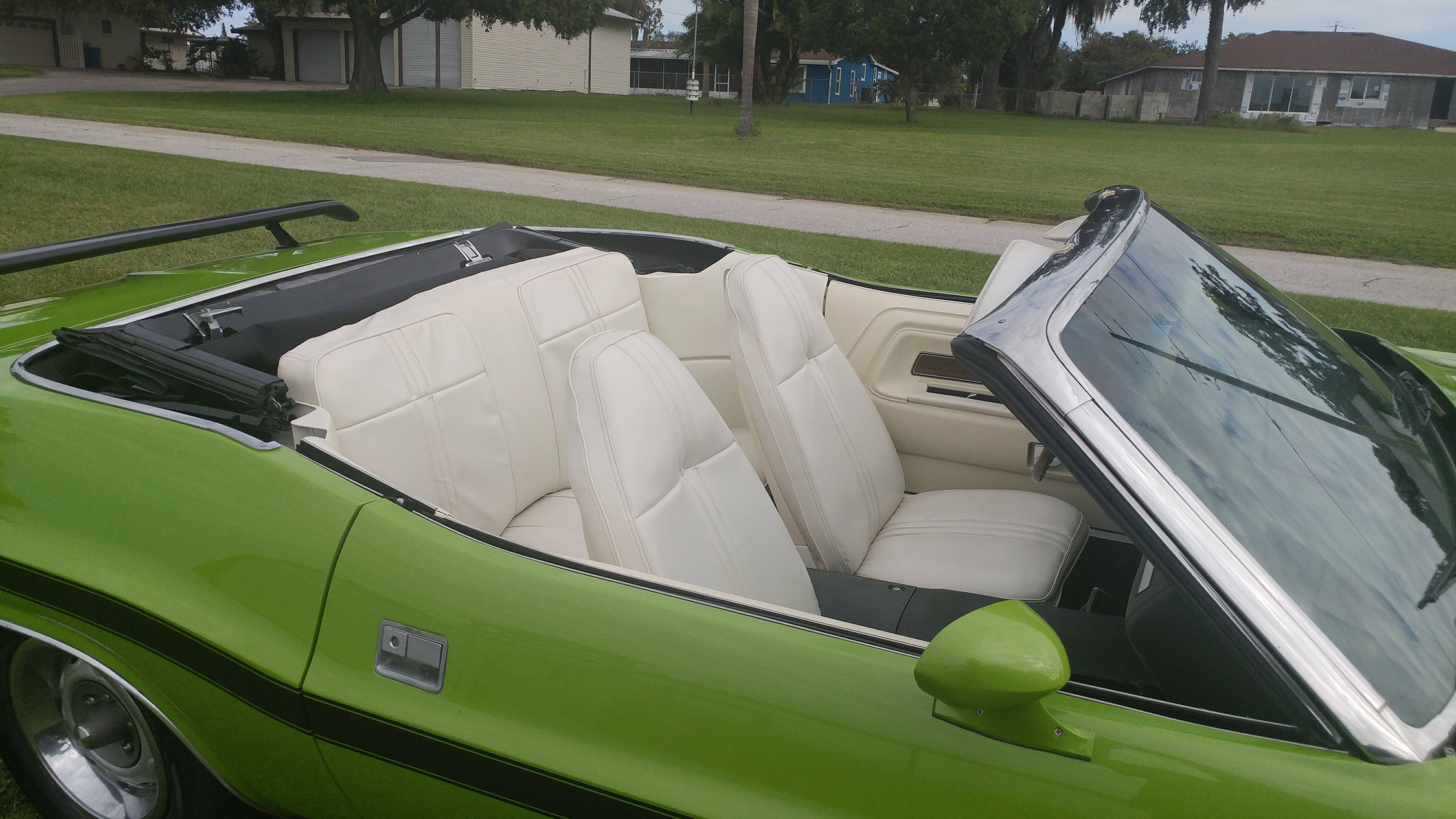

These are the seats in my 71 Challenger convertible. Are these covers the same as the Cuda? Will the deluxe covers work without changing the foam?

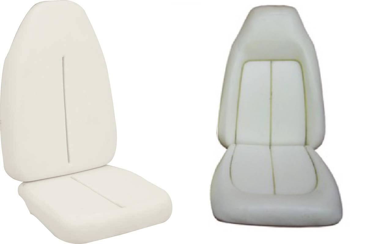

Yes, the foam is completely different on the H6 seat pattern.
