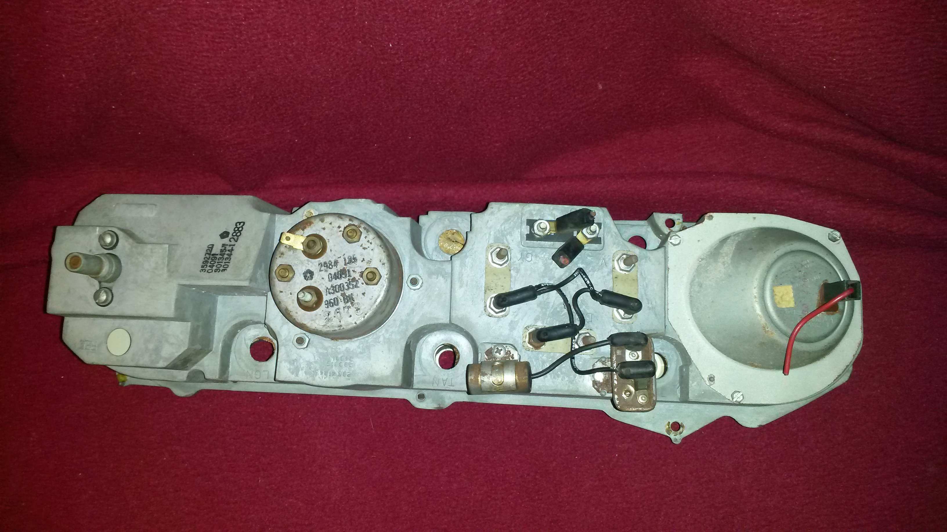

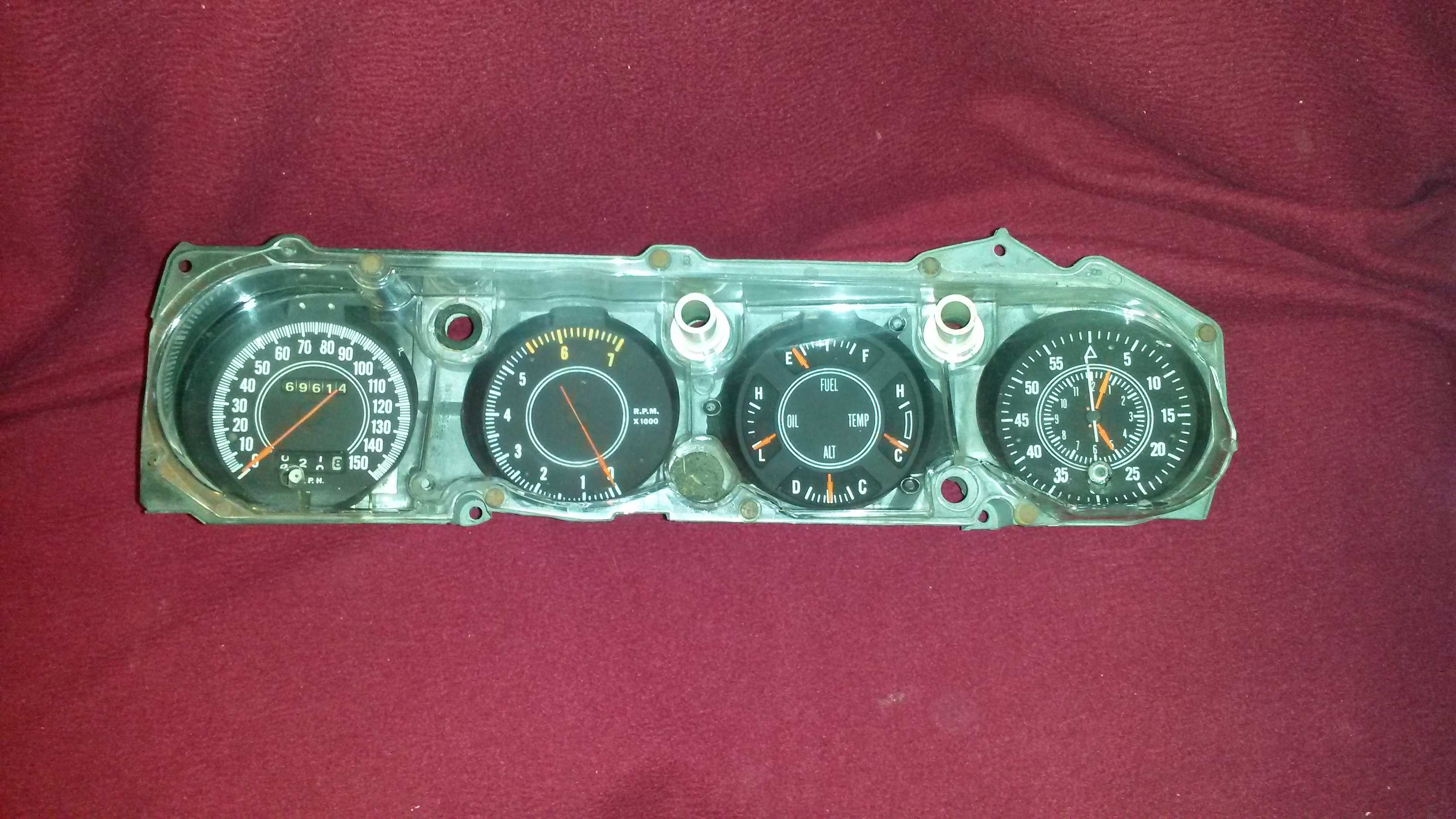

Hi gang - Just put the dash in and noticed the Speedo won't zero out - stuck at 65 MPH. When I spin the cable one way it will move past towards 70, etc....but when I spin the cable the other way it sounds like it's hitting a "stop." Any suggestions on root cause? Dreading taking the dash back out....thanks! TJ

Uh oh! Sounds like you need a new Speedometer gauge! Regardless the issue, you're taking the dash back out! Sorry for the bad news. Take out and see what happens with the needle.

By removing the front cover and the two bolts on the back. The speddo comes right out.

Sounds like the needle spring anchor came loose or shifted.

You nailed it...it shifted then I effed it up. So I bought a new Speedo. And I was able to replace it all by dropping the column and pulling the front of the dash off....
