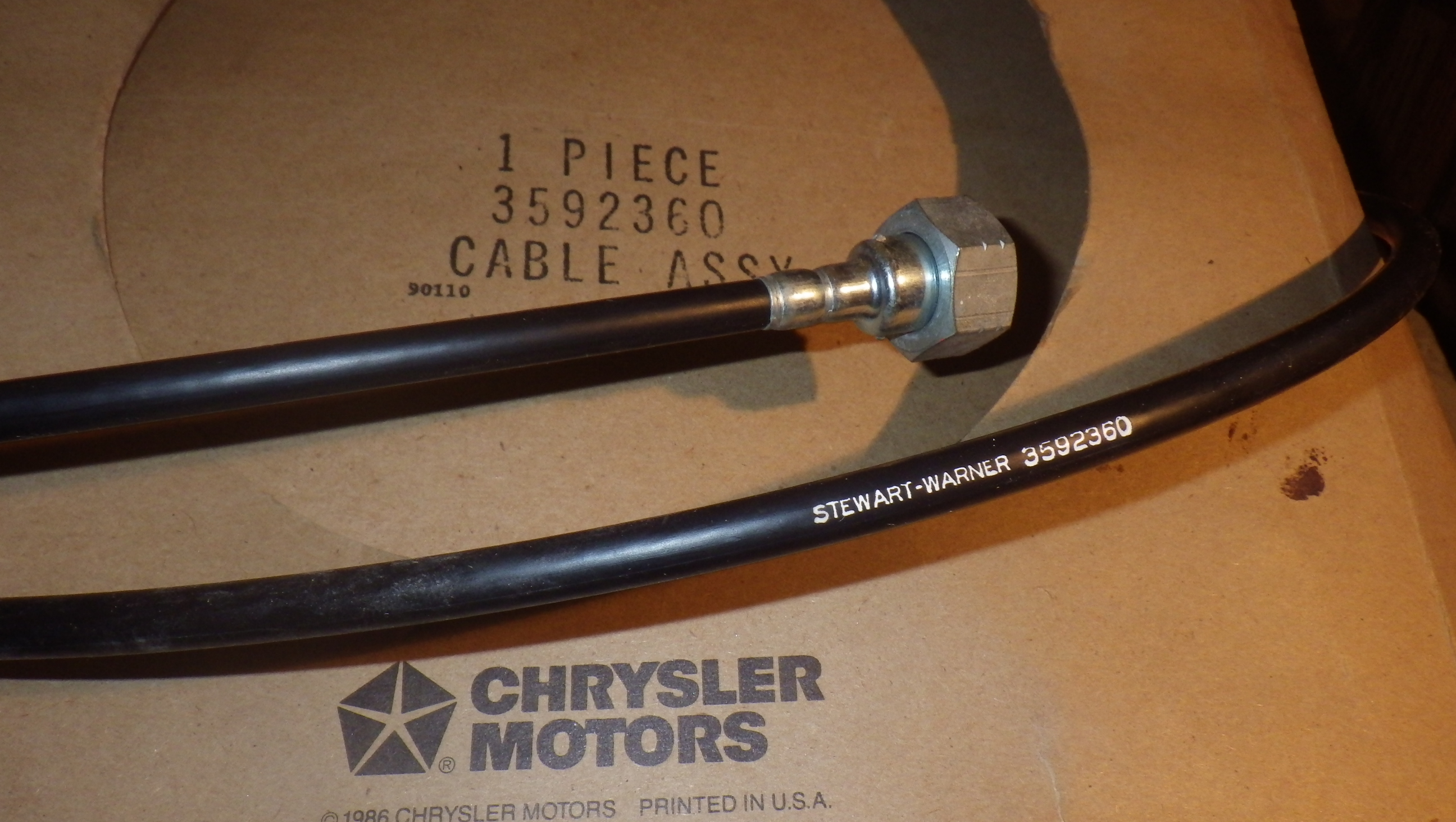

Jul 6, 2026 #2 Vaanth Well-Known Member Joined Aug 30, 2024 Messages 186 Reaction score 417 Location West Georgia cuda426 said: what is the length of the speedometer cable for a 1973 Plymouth Barracuda? I've seen several different lengths listed. Click to expand... The length of the original speedometer cable for a 1973 Barracuda, plus others, Chrysler part number 3592360, is 62 inches.

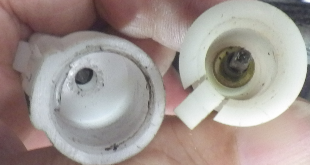

Jul 9, 2026 #3 D Daves69 Well-Known Member Joined Feb 4, 2014 Messages 387 Reaction score 151 Location ChiWest FWIW, I went with this on my A body Barracuda as it had the correct speedometer clip end but a finger grip trans end........ https://www.ebay.com/itm/225927399401 If you're looking on E-bay make sure you know the speedometer end. I needed the smaller one on the right........ This cable I bought at Chrysler way back measures just over 63" and has the small clip end on the speedometer end..............
