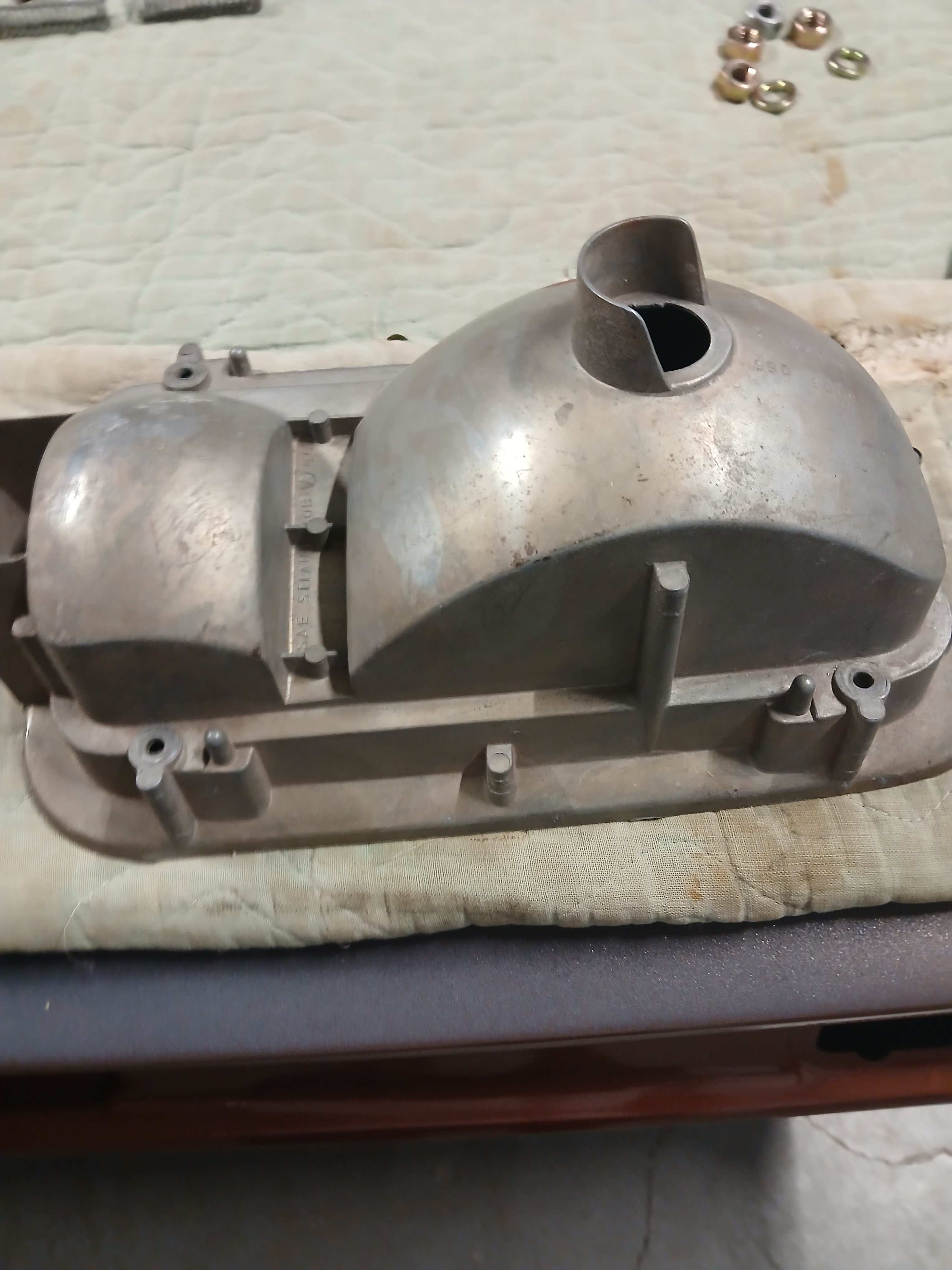

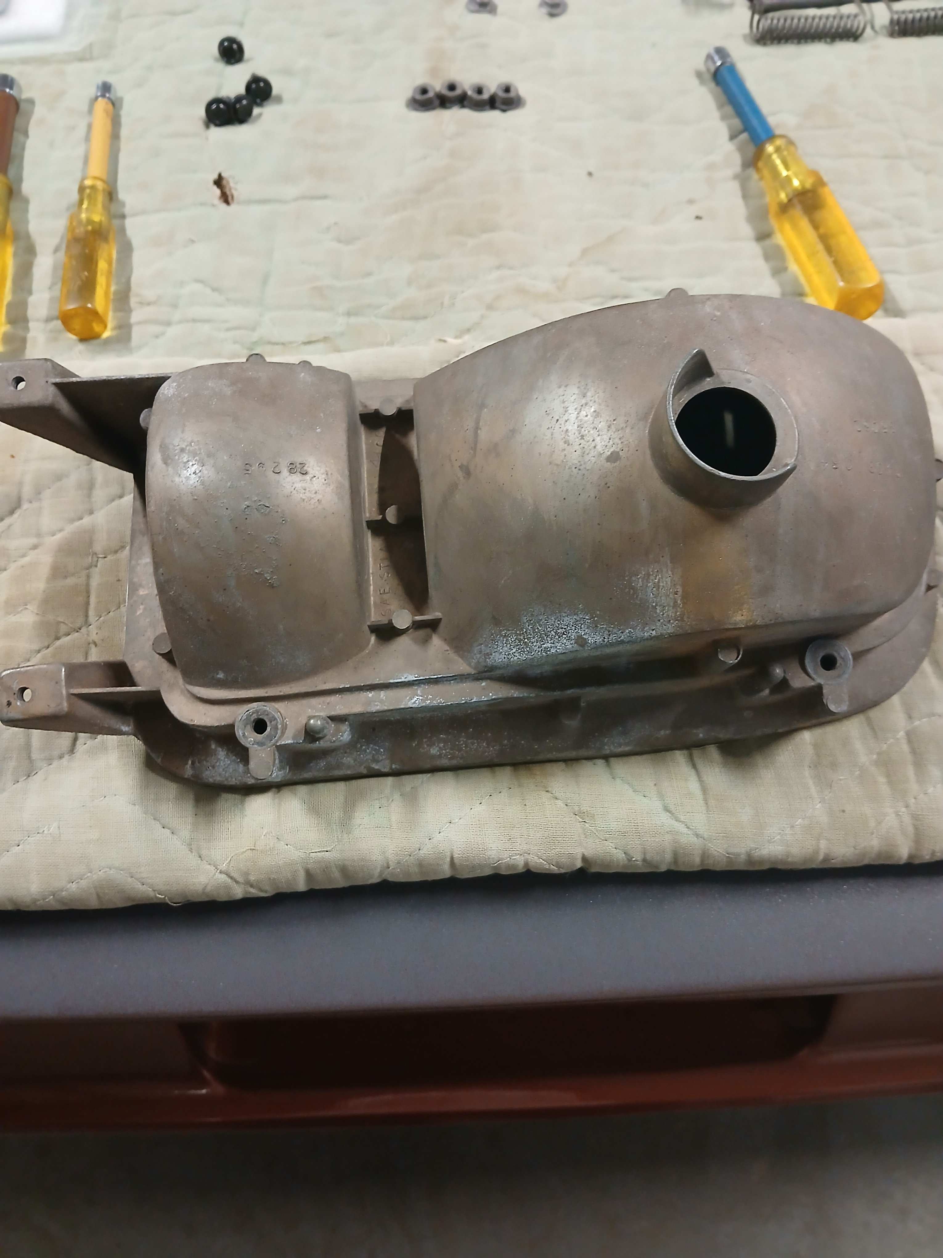

Wanted to make these look better, but not sure what to paint them? Any suggestions?

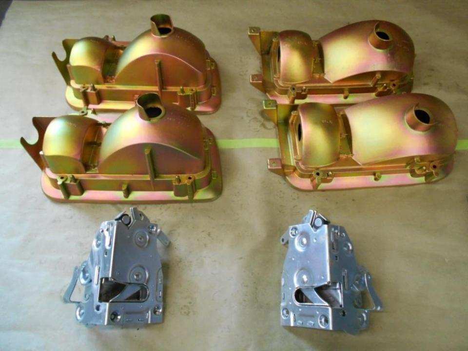

Mine were replated zinc dichromate and I've always thought they came out way too yellow. Survivor cars seem like they are closer to a grey color like the ones John shows.

I believe the ones I pictured were dichromate, just can't tell with that pic.There still is yellow plating on them.

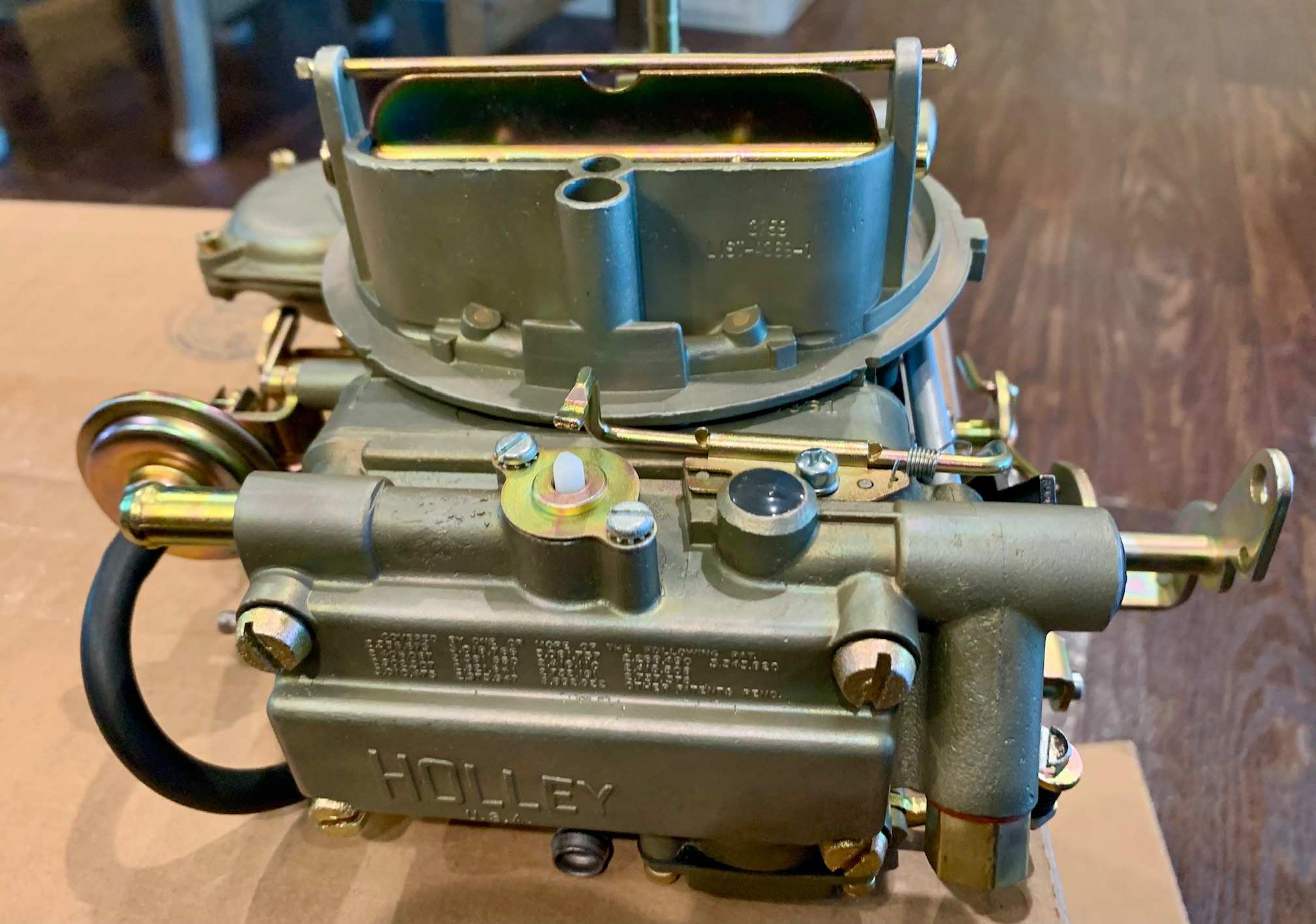

This is a Holley 4369 that I had redone at All American, I believe the finish on the body of the carb is what the tail lights should have as well.
I don’t believe they were Zinc Plated but they sure look nice! And who else will see them? The door locks but those are correct. I did all the metal parts on my 1966 Charger. Sure made the parts look better and were much cleaner!
