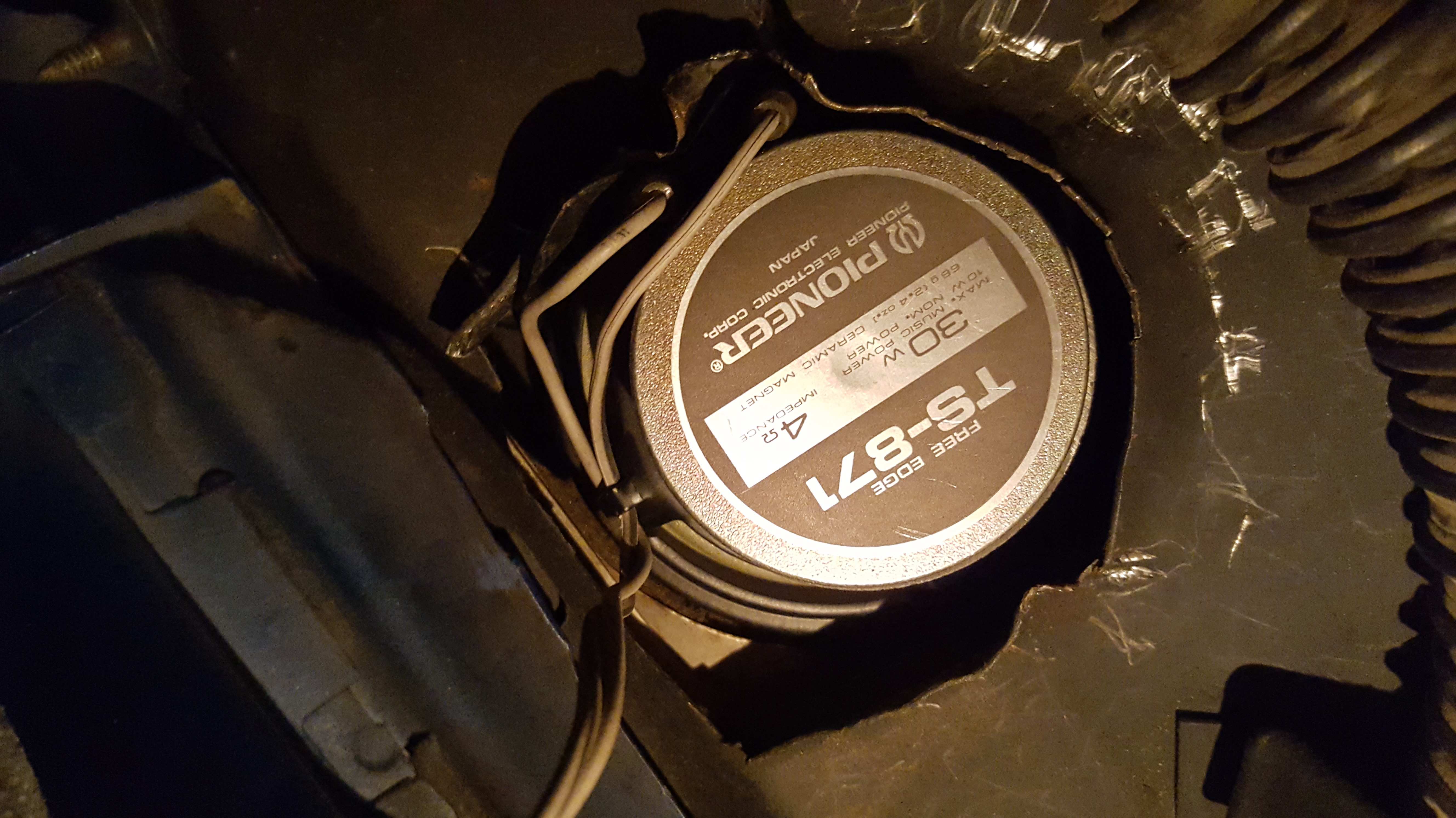

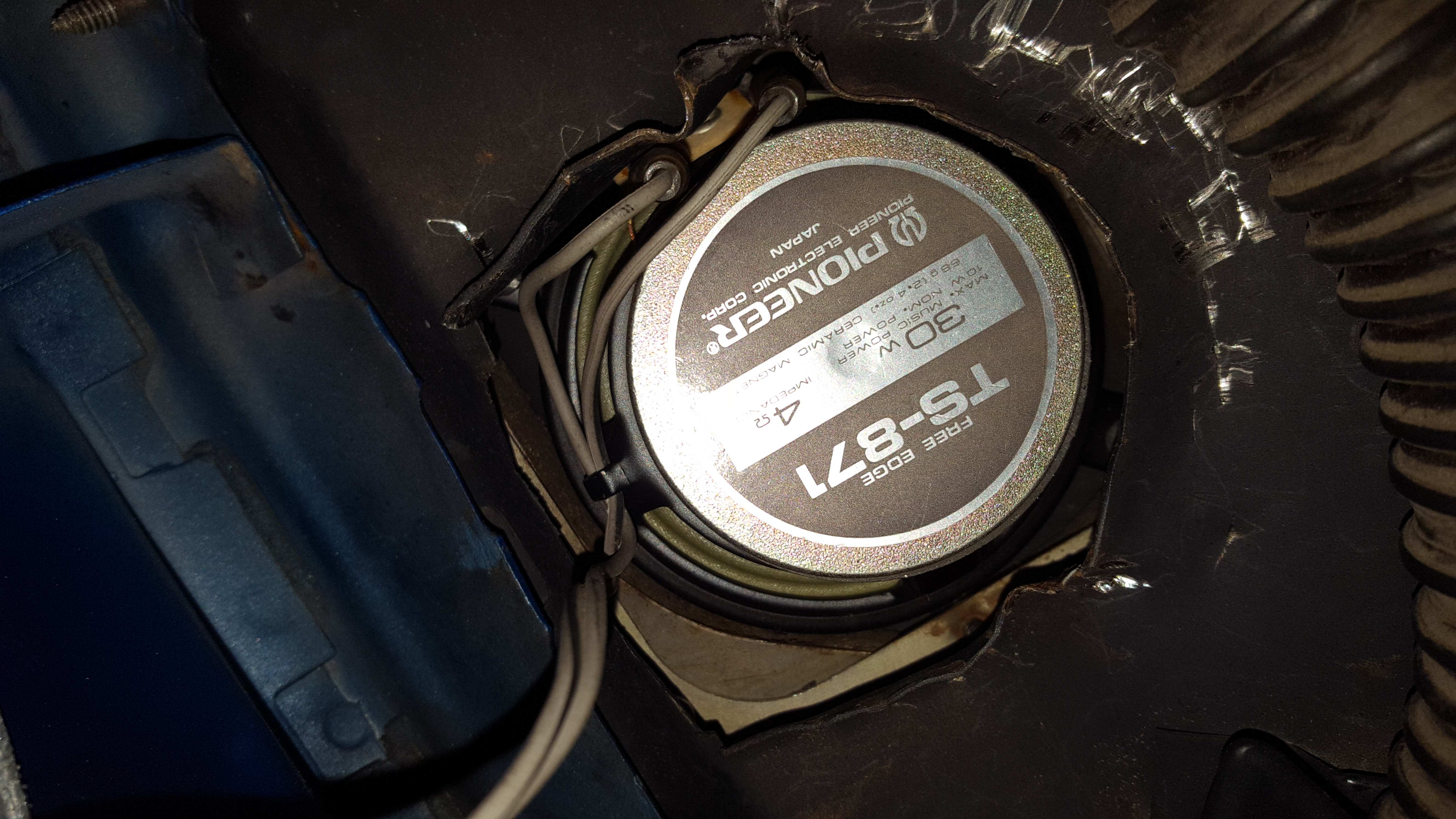

When I first put aftermarket speakers in mine years ago I had to get in there with a rotary file in a drill and open up the substructure quite a bit to clear the magnets on the speakers. It was not an easy task! When I replaced my dashpad a couple of years ago the cones were shot in the speakers so I replaced them with some speakers from a late model Chrysler mini van. The fit just fine and had smaller magnets, but still not as small as the original factory speakers.

I was tying to find the picture of what I did to get them in. It wasn't to bad. They bolt up. Then a cut and a bend if I remember right?
I had pretty much the same size and I definitely remember it was more than a "cut and a bend"! It took considerable grinding to get enough clearance for those magnets!

Made a cut where the wires are and rolled the edge down.
They where going in one way or an other.
