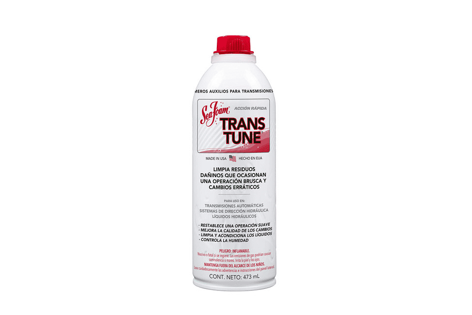

Third, the seals in the high speed clutch are prone to get hard and not seal well as they age or have experienced excess heat. Some good trans medic product MIGHT soften and swell them enough to give them some extra life IF they are not already too far gone and the clutches are still in good condition. SeaFoam TransTune seems to get good reviews. But, it is likely just a matter of time before the seals and clutches have to be changed.

Ok I'm not a trans type of guy. Very good info above. I had a number of experiences with them. My brother had a problem with a Caravan. late 80', I have 2 dodge Dakota's. No! wait 3 now but any how. Well 4 actually the fist one is gone. Bad frame broke my hart. Actually the the second one I bought (2010?) just for the use of the snow plow (White). Put a transmission in. The yard where I bought it from said they would only guarantee it if I put a new radiator in. Did so. A few months later I was acting up. Call the yard and they said change the filter and fluid and save receipts. We will give your money back plus. If it doesn't fix it. Did so!
At that time same I also bought another Dakota ( black) the seller said the transmission was bad. My son was helping me. So for a fitter $6 change and fluid we did both. The plow truck was shifting a lot better but would act up now and them for a short time. The third truck (Black) was moving but just not quite right. It would slip.
Contacted the yard again and they said they will extend the warranty. But they said drive it. And change the filter again. Did so in a few hundred miles it got a little better.
I'm not a snake oil person but this fixed both trucks and my brothers Caravan years back.
I was talking to my brother about it. He said it fix his Caravan until the day he got rid of it. Years.
Both Dakotas run to this day with no Transmission problem.
This is what fixed it. Sea Foam Trans Tune. So before I would go wrenching I would do a filter a filter change. As The yard said. " The transmissions gum and varnish up from sitting."
Here again. My son was having trouble with his SUV. 130 mi. Told him change the filter and use trans tune. 6mo latter not a problem!
Just to be clear: I don't normally recommend any kind of repair in a bottle. But, it is quite common for the clutch pack seals to harden for the reasons I mentioned. And SOMETIMES the solvents in the bottled repairs will soften them enough to show improvement. SOMETIMES.
And the possibility of the seals being softened is the ONLY reason I mentioned it.
