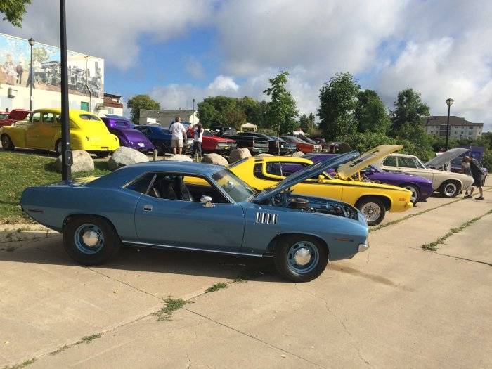

Since your car is already getting painted, I would expect all suspension components will be bolt on only. No welding.
My Cuda has poly bushings, stock UCA and LCA, steel strut rods, big block torsion bars, QA1 shocks. If the K member is not detailed yet, some guys weld all the seams to stiffen. My rear suspension is EPSO 1" over HD springs, offset kit, caltracs, and QA1 shocks.
