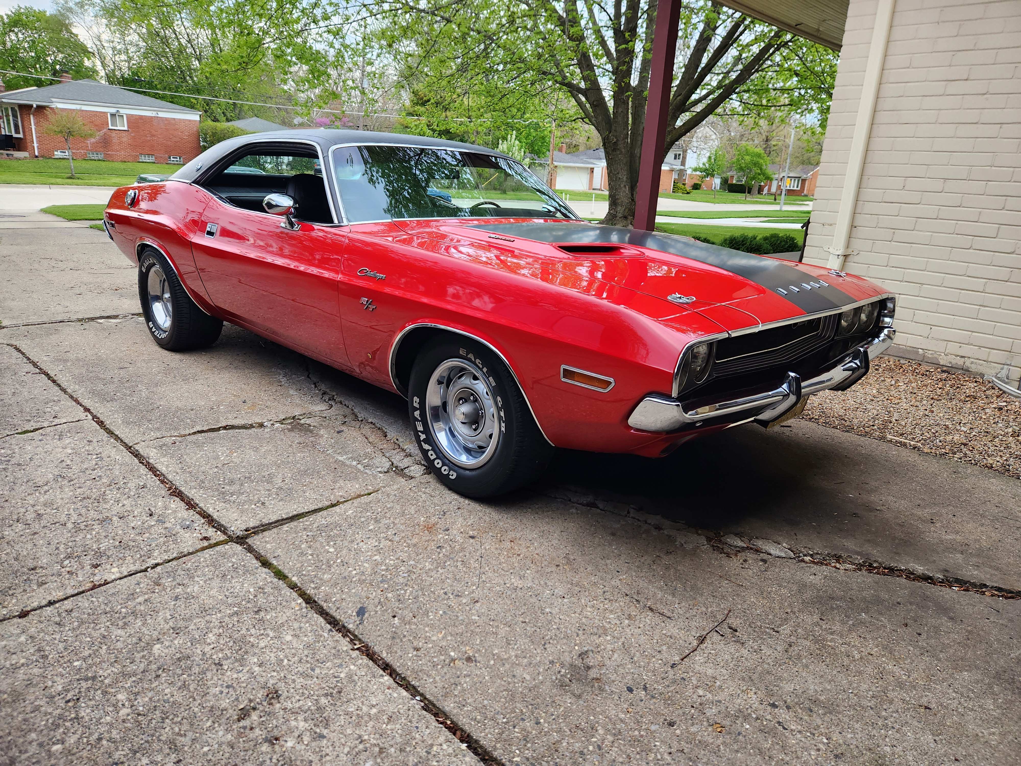

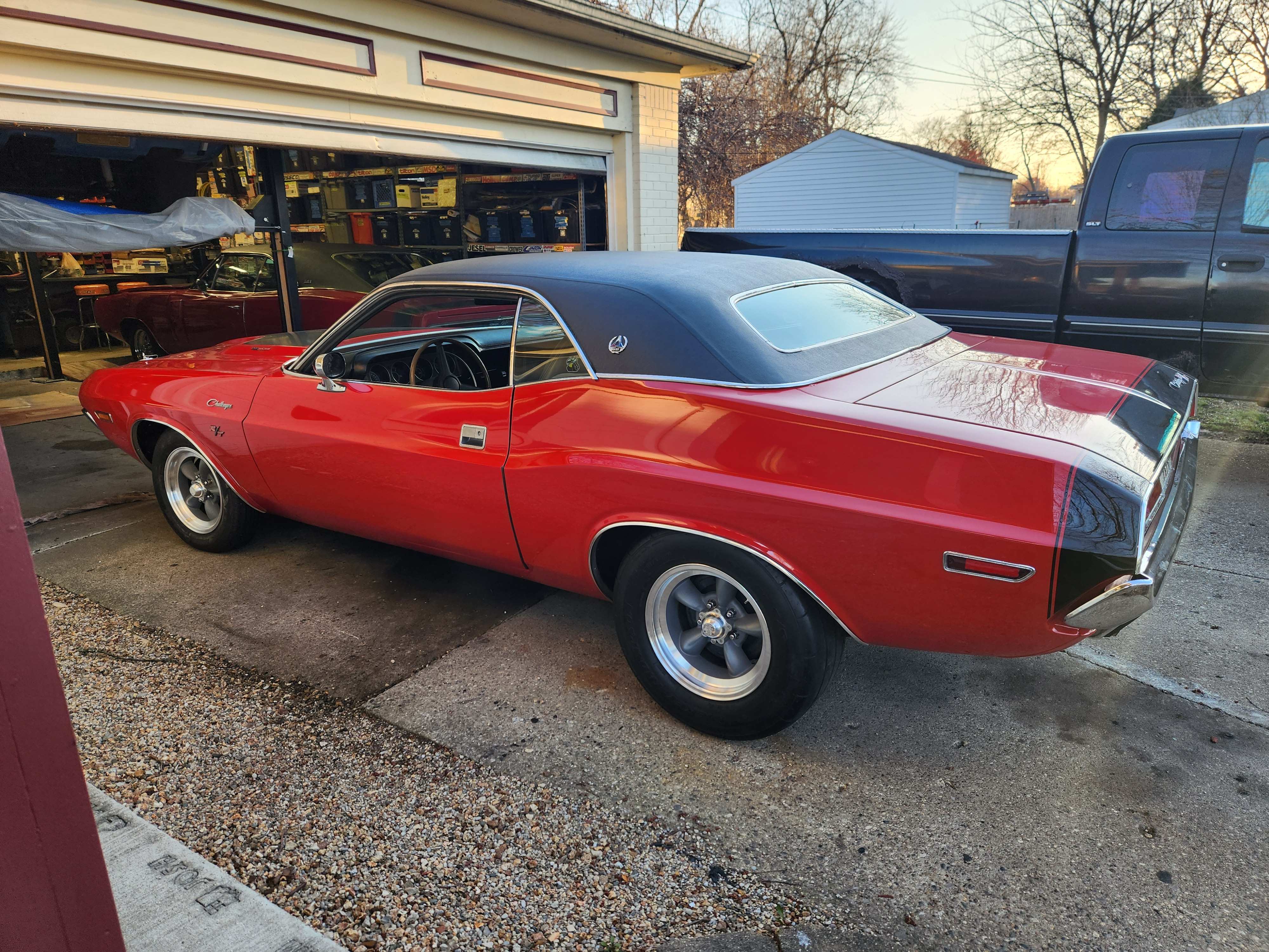

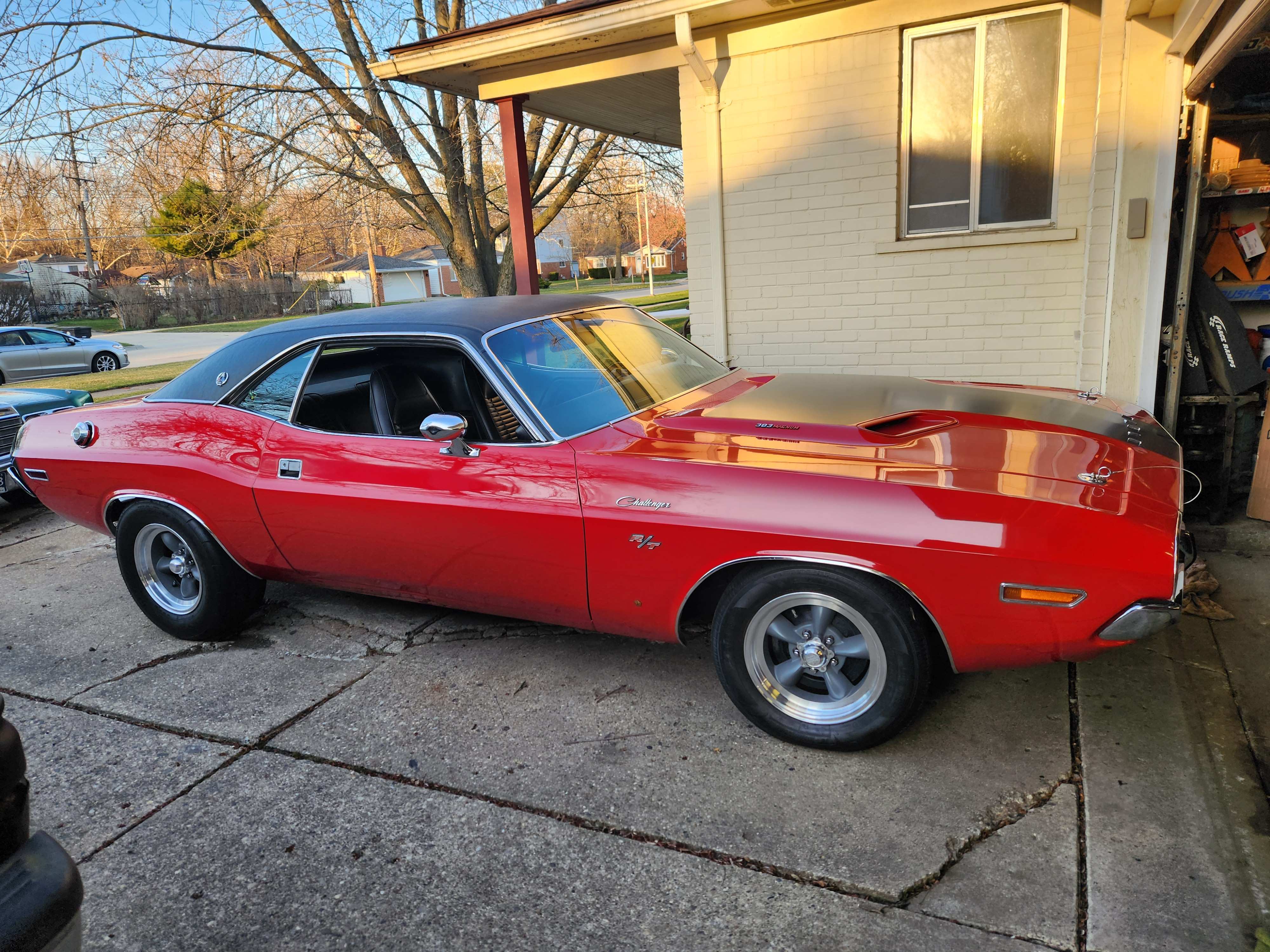

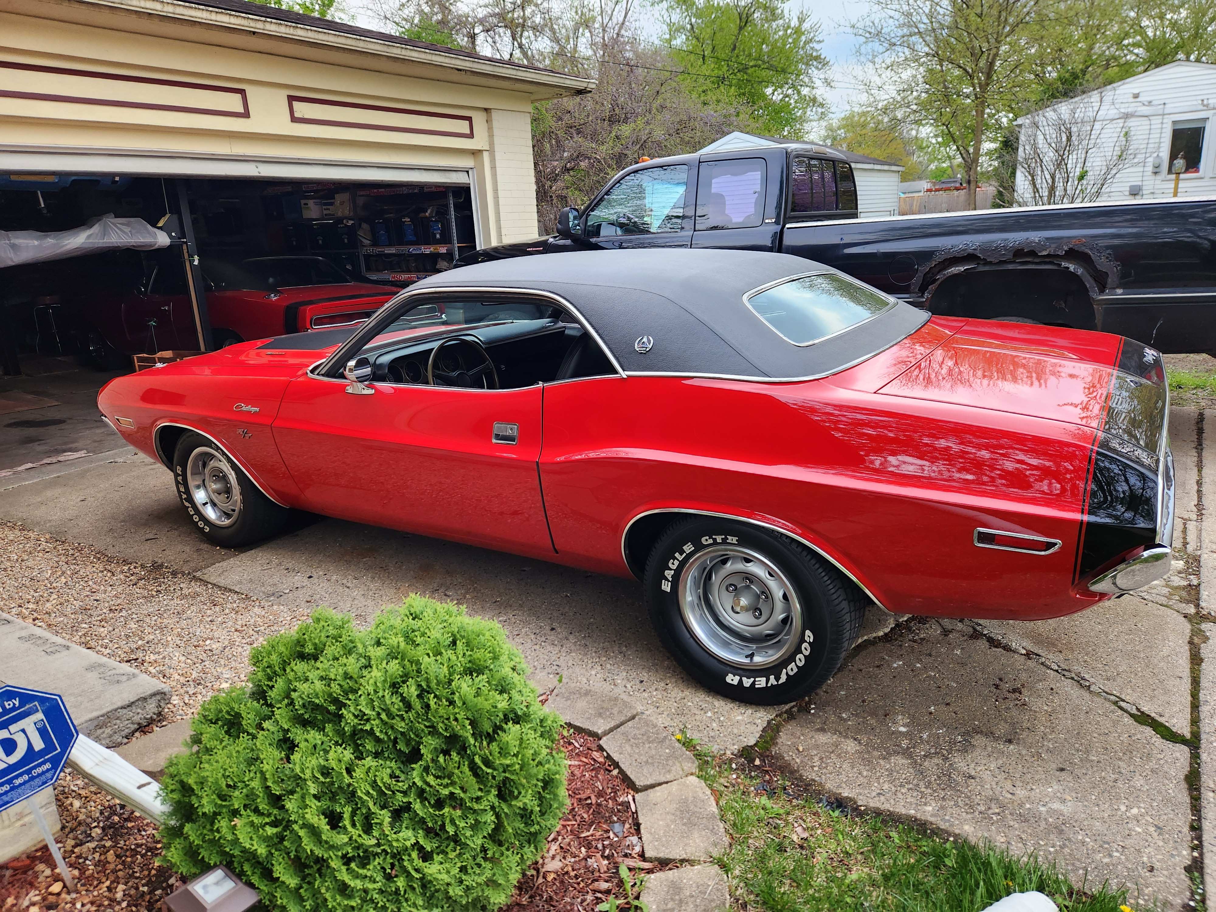

I've 255/60-15 all around on my 70 Challenger. That's about as wide as you want on the front. Can definitely go 275/60-15 on the rear with 295/50-15 possible if there's equal distance inside both rear quarter wheel housings. I mention this because some cars have a lot of difference side to side.
