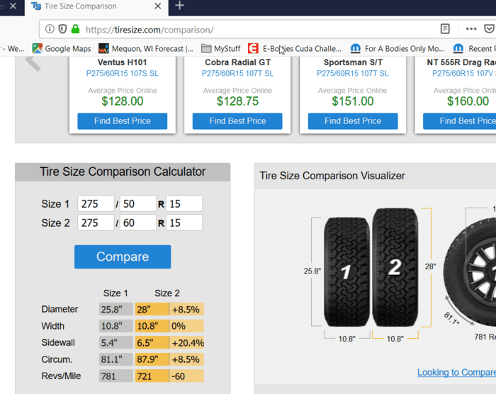

There are lots of onlinebackspace calculators that help you figure out what will fit based off what you currently have.
What is your rear gear ratio? If 3.23, for example, a 25.8" diameter will increase (theoretical) final drive to about 3.35 - - while a 28" diameter will reduce it to about 3.10. You can also consider same size wheels on all four corners - such as 15 by 8?
