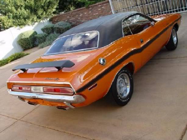

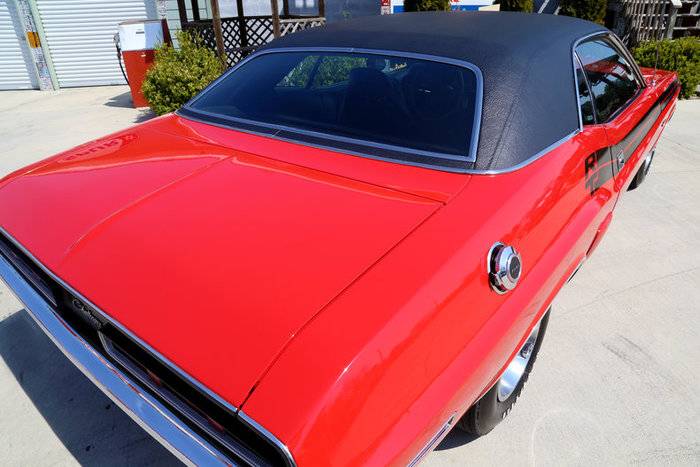

Just to get this thread going,
70-74 Cuda's had narrow seam.
70-71 Chally's had wide seam.
I think 72 Chally's either continued wide or transitioned to narrow, someone pipe in.
73-74 Chally's carried on narrow.

good to know - does anyone have photos showing a side by side difference between the wide and narrow seams?

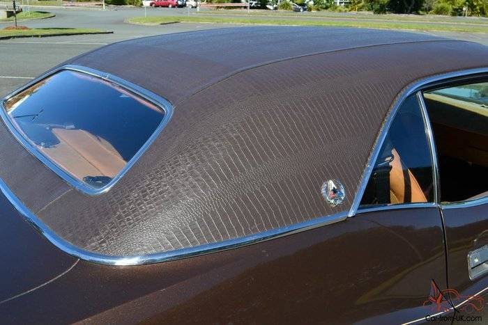

wide, narrow, and gator grain for fun
