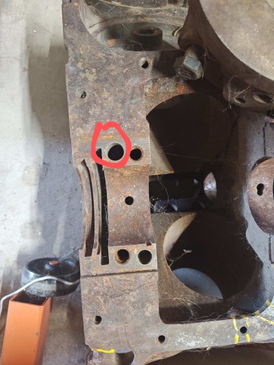

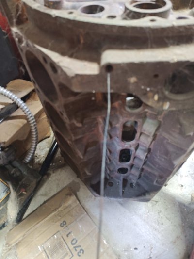

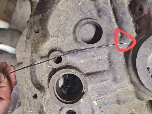

    If I remember right the hole that the oil sending unit lives in is a the top of that rear oil gallery and if you put a clean rod in...

    OK, I went out to the barn and drug out a bare 340 block. Please ignore the cat hair on everything! It's much better that mice and rat...

    No problem. One time I had a vehicle that used a sending unit for an electric factory oil pressure light and I used teflon tape on the...

    I totally agree about using an oil accumulator, especially if it can be plumbed in on the back of the block on the drivers side so the...

    Just read your message and I'm relieved to learn you had a similar issue that is somewhat normal. Thanks! Chryco also suggested an oil...
