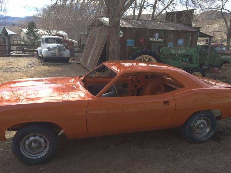

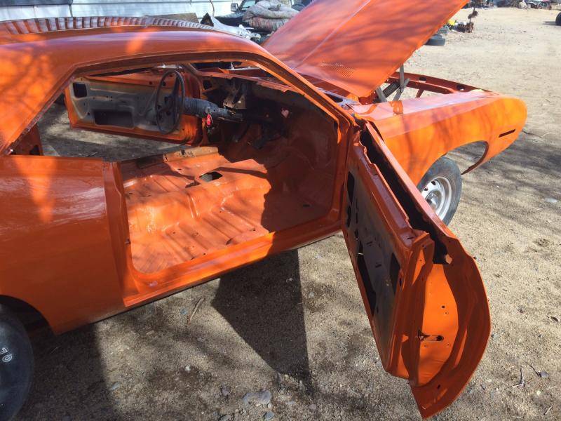

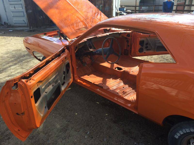

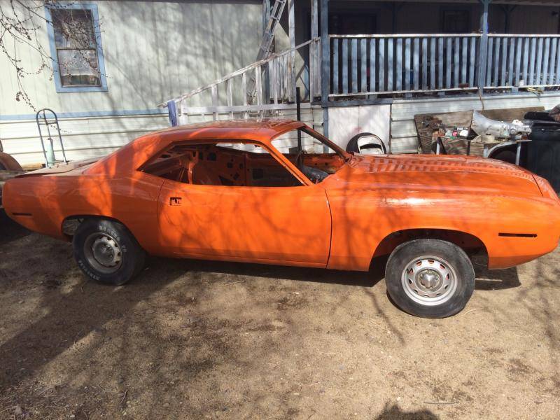

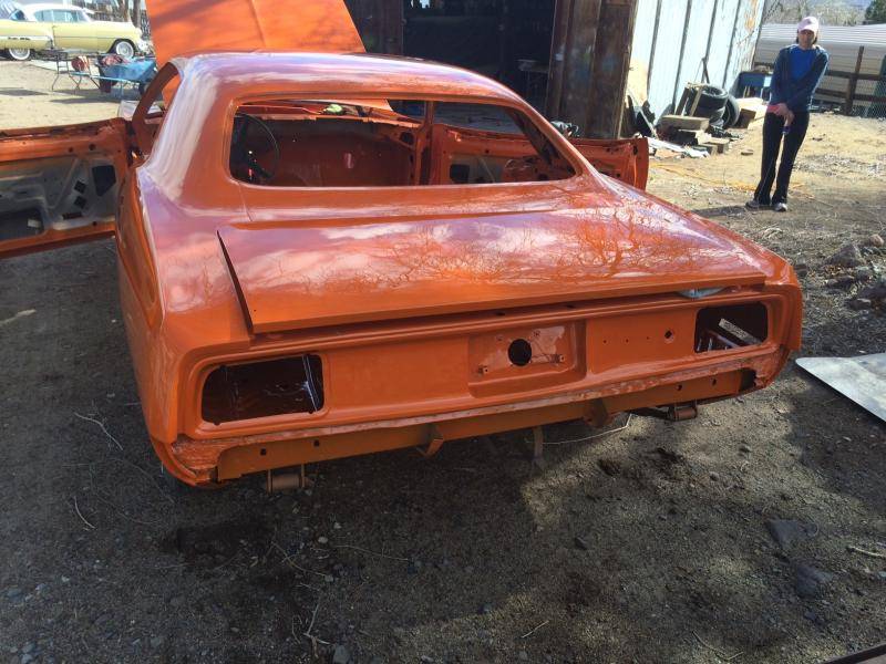

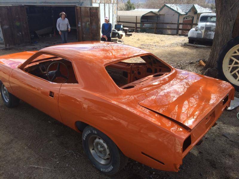

Hello - Well I purchased this 1970 Barracuda Go Mango, factory 4 speed 318 car nearly 18 months ago. By the time I stripped it out I realized it was in a bit more need of work than I anticipated. Once stripped it out, blasted it and bought the new parts. I found a gentlemen close who could do all the work. After 10 + months, I have received the car back painted and ready to go. At this time I have the TKO 600, 451 (awaiting dyno) and the car.
I am currently into a 70 Duster 4speed/360 car, so funds are a bit dicey, oh and a kid wanting to go to College. This will be a slow go, but looking forward to the build. Just thought I would share, I am very happy with the paint. Plans are to build to a AAR style body, this has an AAR deck lid and rear spoiler. Eventually it will have the argent black and AAR hood.
Nothing was original on the car when I bought it except fender tag, body (most) and rear end. Hope you all like it as much as I do.

Nice car and plan there.
Are you sure those are new pictures? From the look of all the background cars I am guessing we have entered into the 50s...

74chllngr - He has a bunch of 40's and 50's cars, some AFX's etc.he's a pretty cool hot-rod guy, kind of like stepping back a bit.

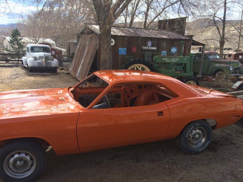

That's a great looking Cuda you have there. As your priorities sort out it will be a fun project to finish up. Those background pics are awesome with the cool rides and John Deere tractor.
Cazbah362
Feb 3, 2012
218
27
Thanks for the compliments gentlemen! That is my painters yard, very eclectic - I would imagine his neighbors are not fans.

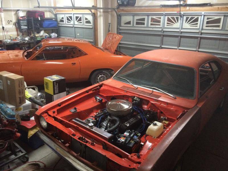

Sold my 70 Duster this week! means I have cash, time and energy to spend on the Cuda. 451 is about ready to be dynoed, need to order my TTI's, flywheel and fuel system. Waiting so I can purchase this tank setup: http://www.tanksinc.com/index.cfm/p...t_id=477/category_id=146/mode=prod/prd477.htm
The plan is to build all the fuel infrastructure for EFI, starting of with a carburetor, then will go with either a FAST or one of the new Holley systems in the long run.
Once the Duster is out of the garage, going to drop the K-frame and start powder coating and rebuilding.Garage.jpg

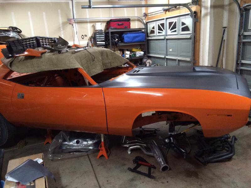

Updates -

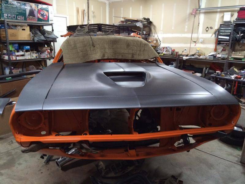

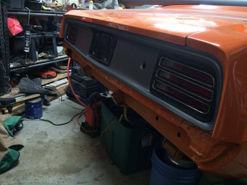

Have made a bit of progress here on the Cuda. My plan was to do all the AAR graphics and black areas in a carbon fiber wrap. To date have finished up the tail panel, hood and fender to doors. This really came out very nice. Also received the Tanks EFI system, I ended up going with the 6GLP pump which is good from 500/1000 HP. It arrived this week and will be going in within the next few weekends. Lots of home life and working on a Masters to boot, so priorities.
Hold ups right now is my engine builder. Too long of story for the forum, bottom line is I am not his priority. Motor should be nice when finally dynoed, looking for about 700 HP. 451, Eddy Victors and an Erson grind roller with T&D's. The will go behind a TKO600 and eventually a FAST system or something close. The TTI's have been in my garage for a few months, so.
This car started as a basket case with many of the parts there, but the small items missing, such a trunk lock, pass bumper brackets, etc. These small pieces are a PITA and costly to buy. This is not a restoration and trying not to make a clone, making my own hybrid. With that said, bumpers are off to the chromers, seems to be cheaper than buying new ones. Thought of going fiberglass modifieds, but I like the chrome.
Thanks for the morning rant -

where did you get your hood? i have an aar and the hood is original and worse for wear. just wondering about aftermarket hood quality

Plumbgtx - I bought this one from Stinger/AAR, little pricey with shipping however seems to pretty nice quality. I wanted a bolt on, so this was the best one I could find for the price.

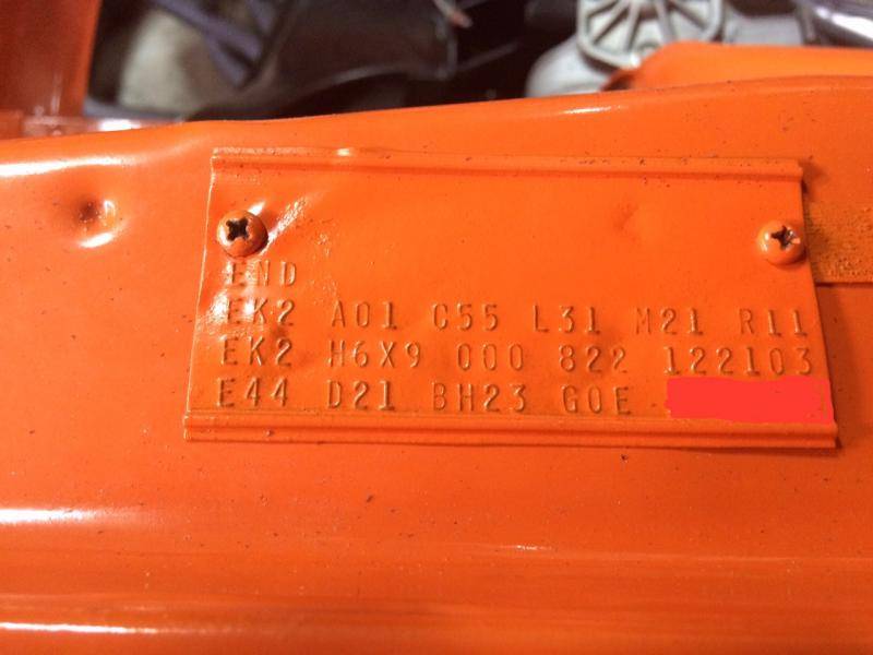

Fender Tags
Cuda Hunter - Yes, professionally completed.
Cuda Hunter
3,030
1,074
high mountains Colorado
Wow! I really like your car. Bare bones with the exception of the light group and buckets. 4 speed as well. Cool ride. And EK2 !!
That's one cool Barracuda !!
Did you happen to retain a build sheet? I know you didn't mention it and said this was all that came with the shell but I thought I would ask. LA car and all.
