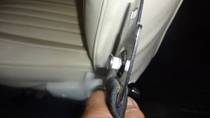

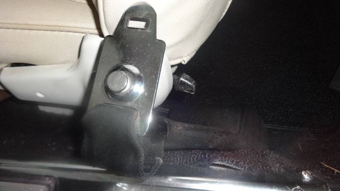

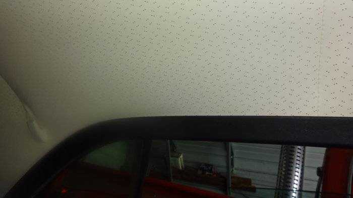

The front lap belts have a button on the male clip that I assume was probably for a shoulder belt. Can someone tell me if my car should have 2 point belts or 3 point belts? There are no holes in my headline that would indicate there ever was a shoulder belt so I don't know if the lap belt is wrong for my car or if the shoulder portion is missing.
