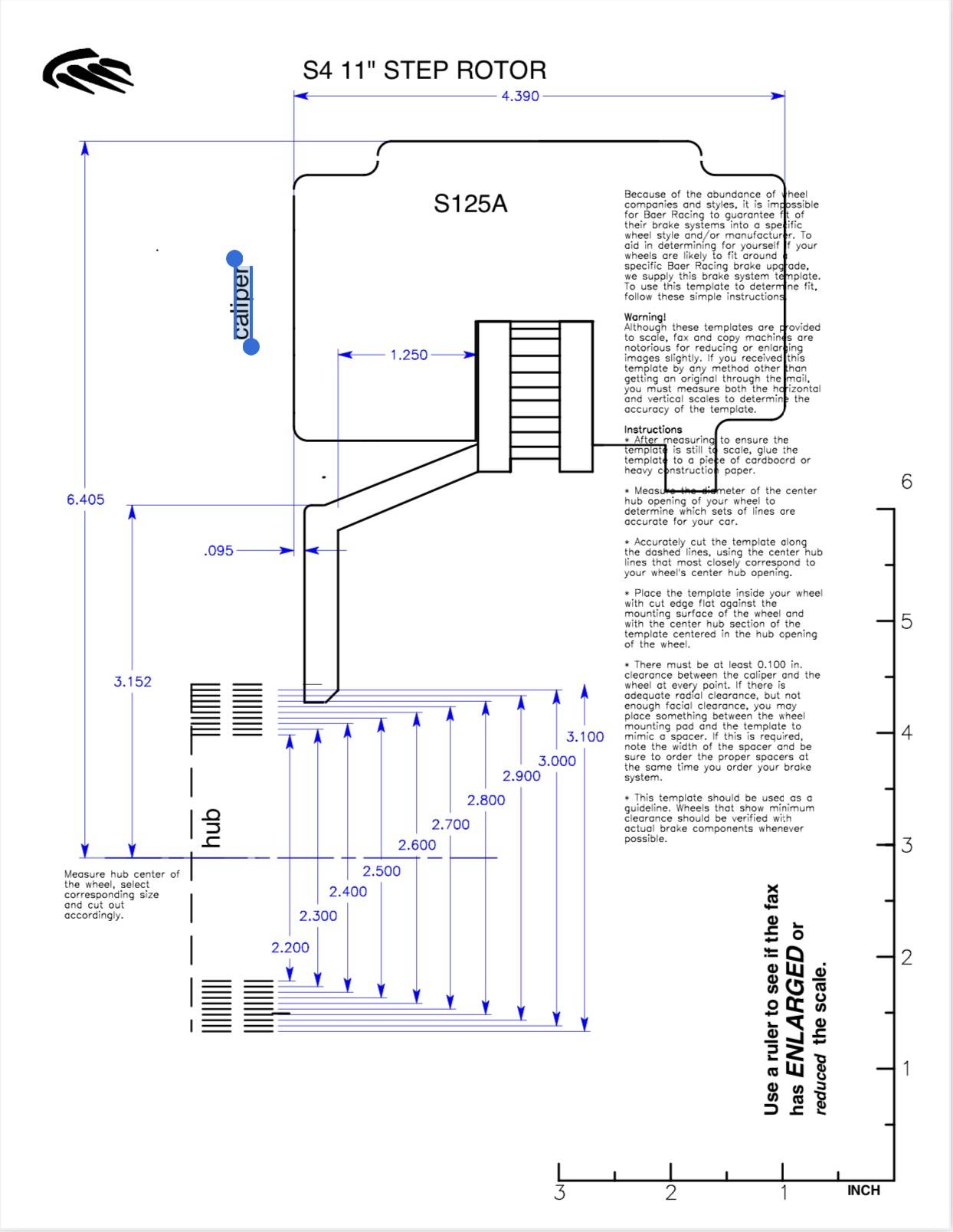

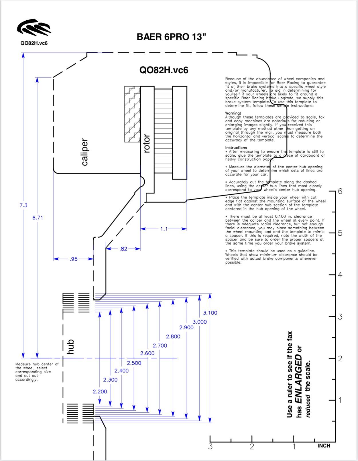

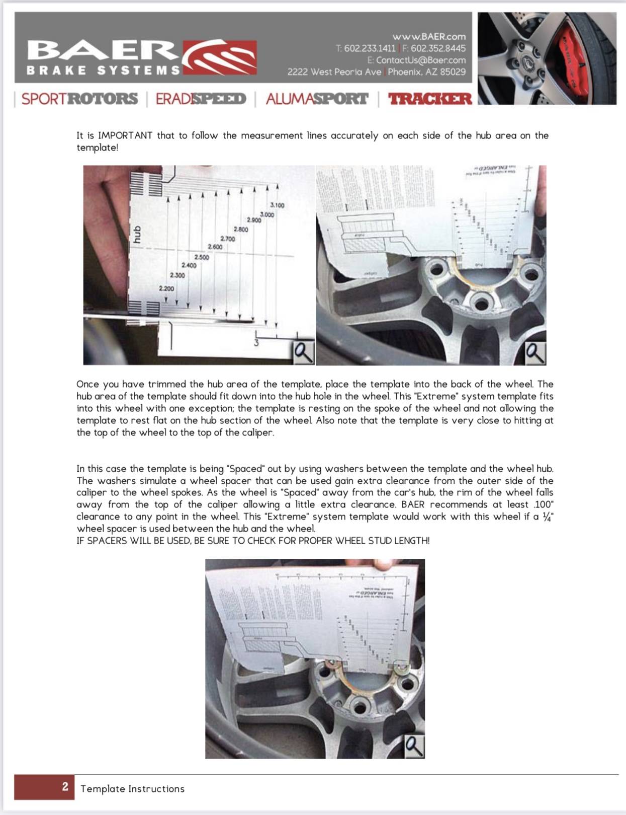

Bear brakes has a rim template on their website, you download it and print it off, use paper to cut out. Use that to match up to the rim that you’re buying. Your brake kit will probably take about six weeks to two months to ship to you. Those rims will probably get to you sooner, call Baer brakes and ask to put a hold on your brakes. You won’t be disappointed with those brakes. I have the smaller version, and they stop perfect.

You’ll need at least 15 inches inside your rim.

Tip: Also consider the thickness of inside rim tape weights... if you have them. They could possibly hit the caliper. Solution would be to get thinner tape-on weights, or else, to additionally file/grind the caliper for clearance to the rim, etc.

I appreciate all the replies ! Well the rims just turned up and using the template I can report that the brakes fit so all is good 👍🏻

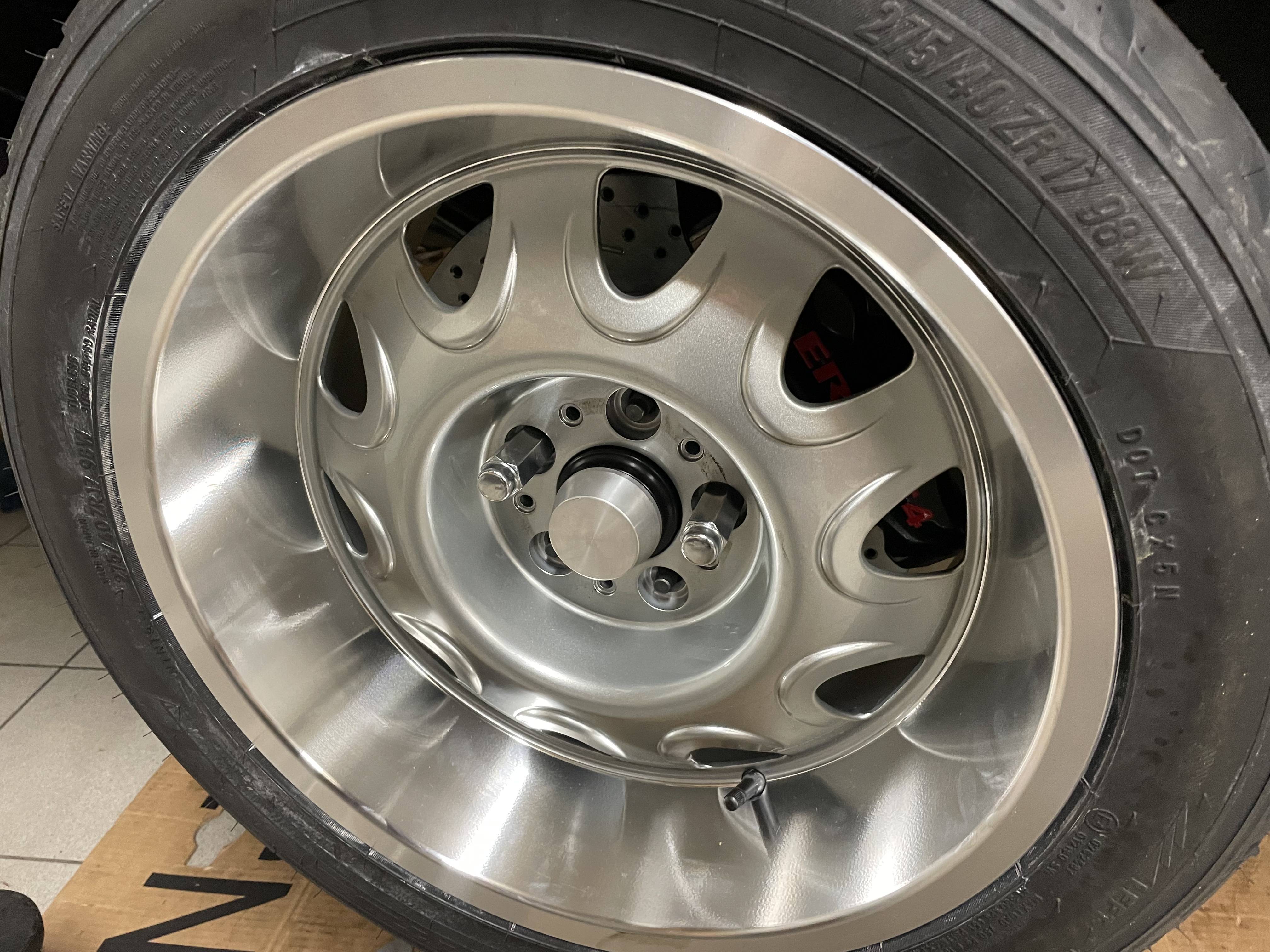

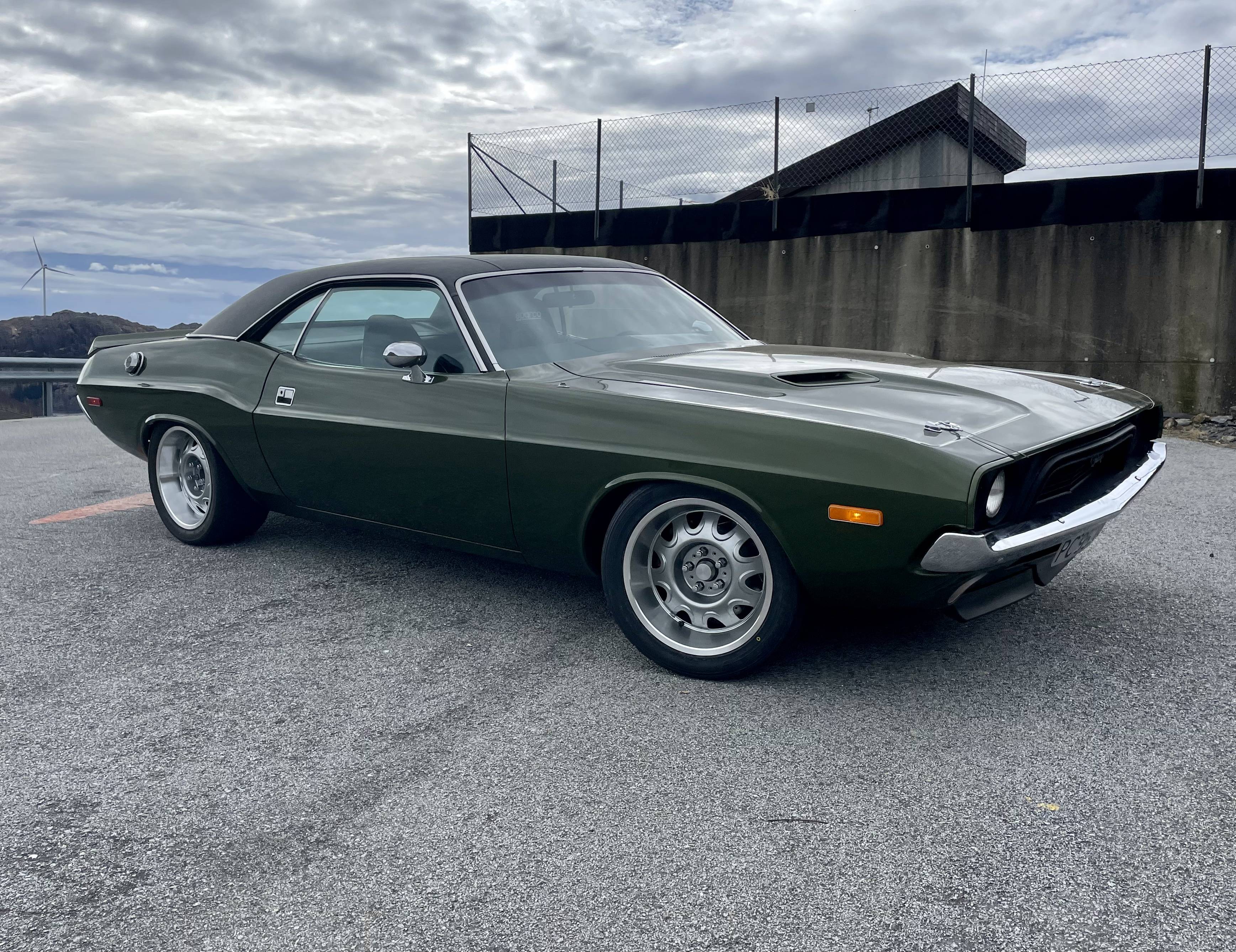

Thanks for the replies ! Some fantastic looking machines here 😀 As luck would have it my rims arrived in the last few days so I was able to do a test fit on the car with no issues. I’m planning to use the acorn center caps from the original rims. Next job for the winter is to upgrade the suspension and brakes. I’ve gone for a mix of Hotchkis (torsion bars, leafs, subframe connection and shocks), PST (upper + lower (reinforcement kit) control arms and sway bars) Baer T4 brakes. Looking forward to spring !

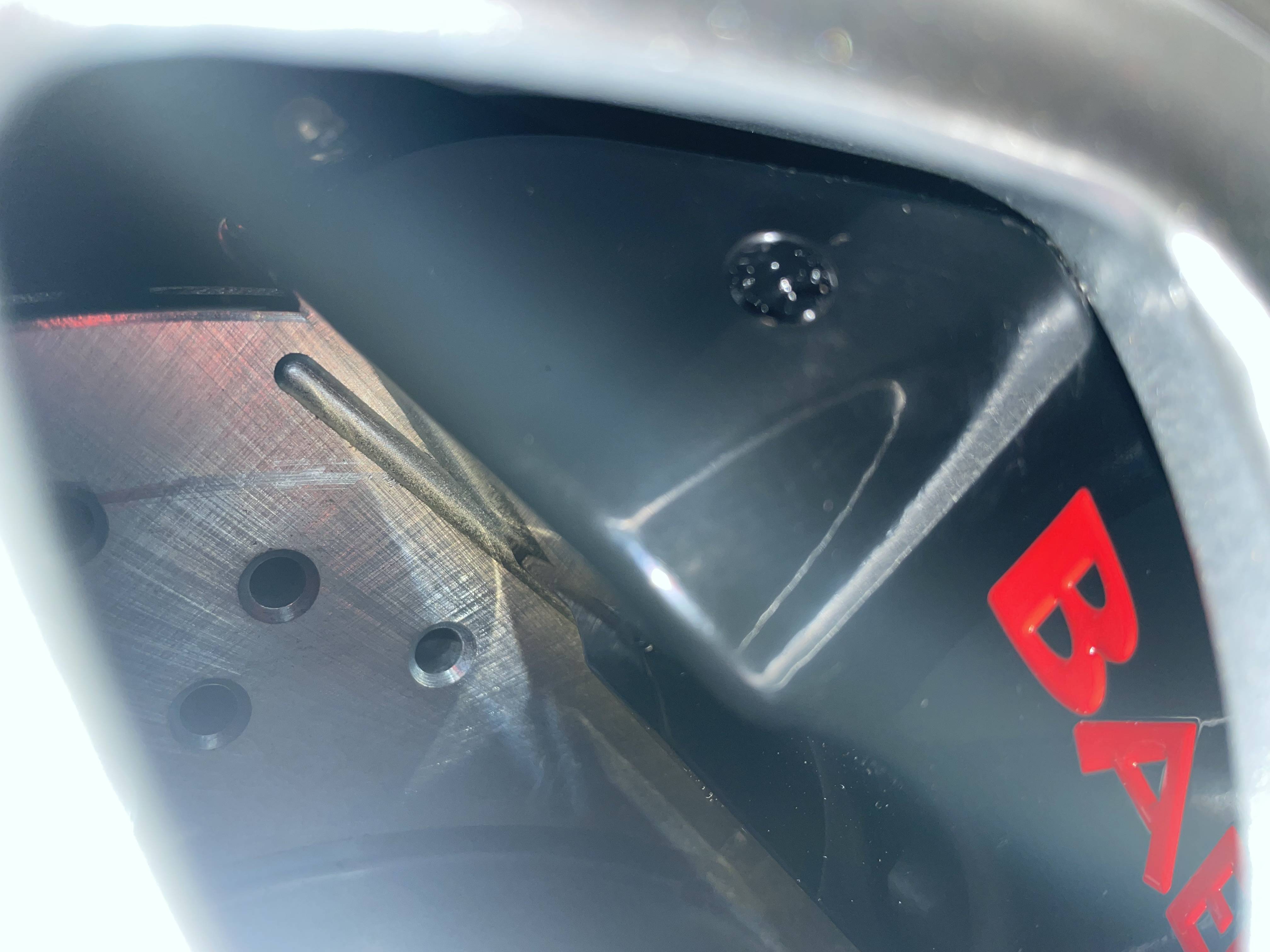

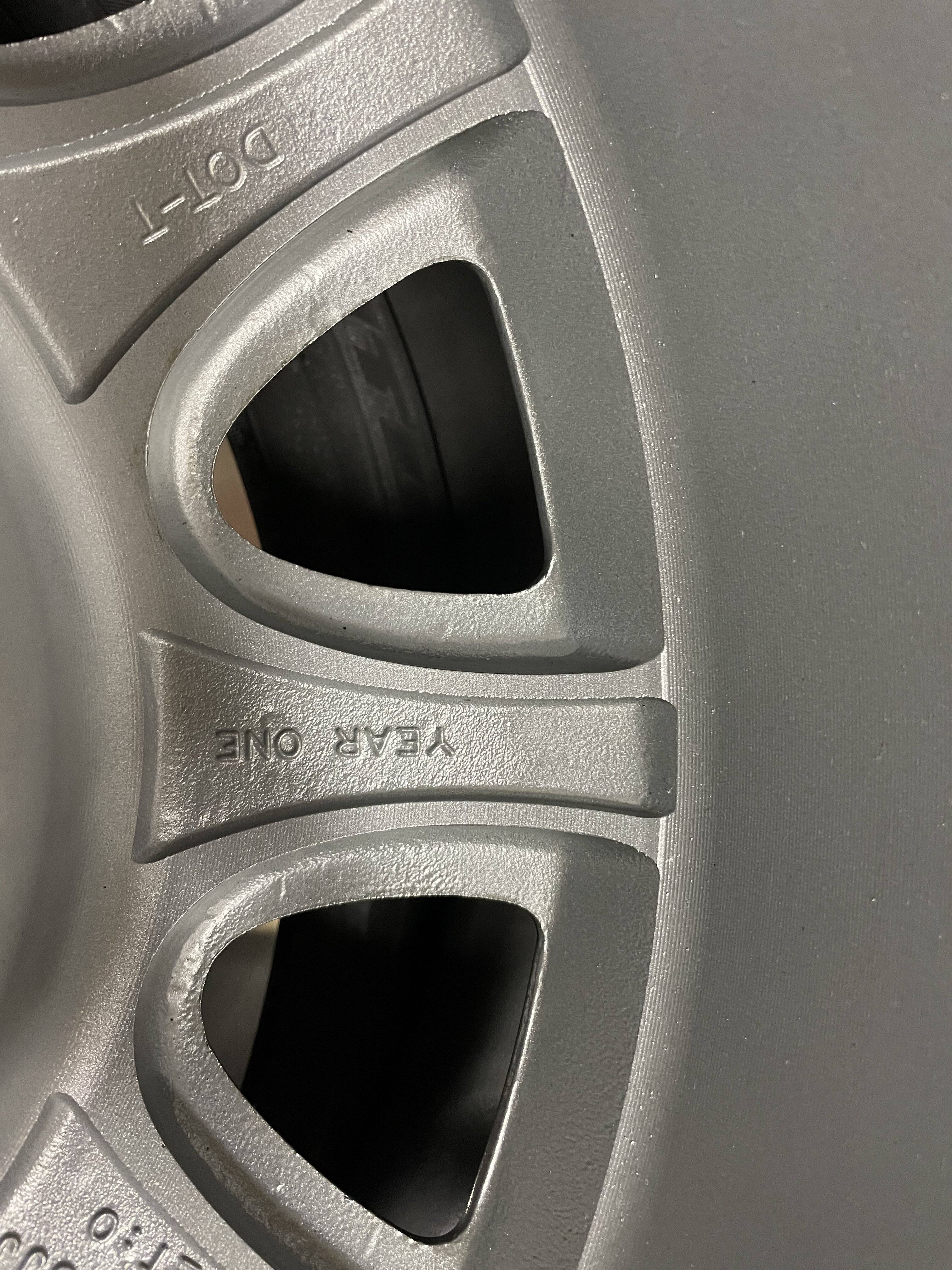

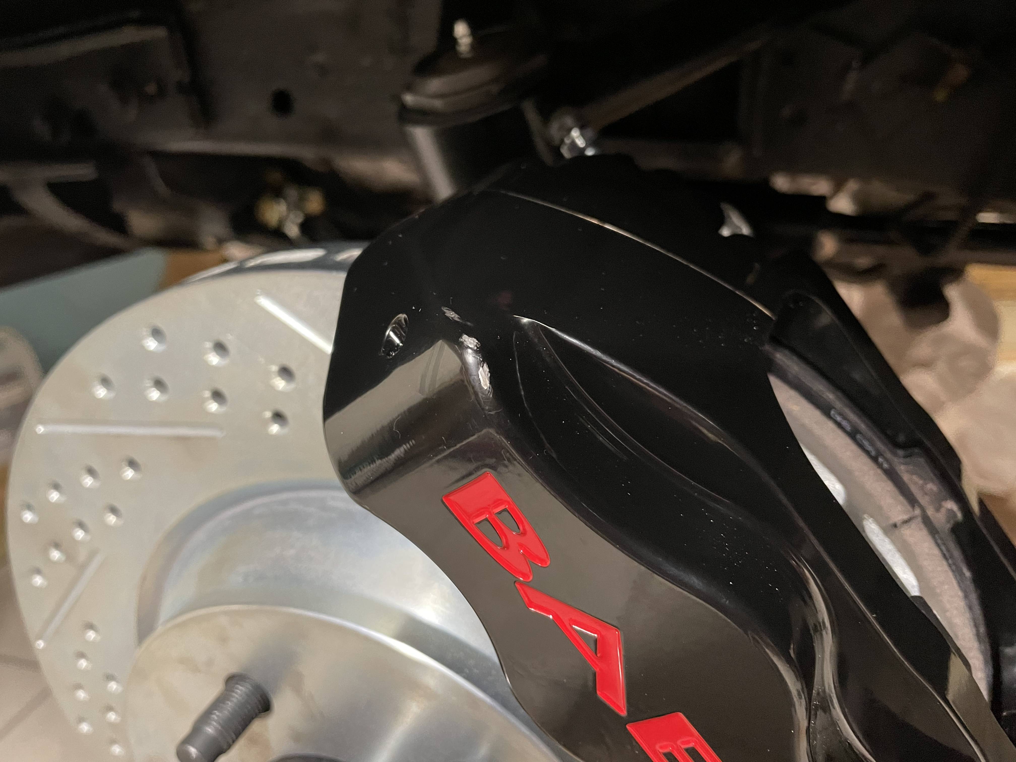

I finally got round to fitting the new front suspension and brakes but frustratingly I have a minor clearance issue between the brake caliper and the rim. The template clears fine (I checked the scaling). On the car though I have interference on the rim spoke. With a 3/16” spacer clearance is fine except for the inner wheel weights. The only issue is I probably have to move the caliper further out another 1/16” to center it. Thinking I could grind the inside of the rim spoke flush with the casting at the interference point. Any thoughts other than new wheels (which I really want to avoid if I can help it)

Regarding the design/shape of the wheels, that's a common physical interference problem even with 15" rallye rims and slightly larger aftermarket rotors/calipers. Too bad the 17" don't clear that radius of the inner shaped rims vs the caliper. Possibly, you could file/grind down the calipers to clear the rims... not uncommon pending the amount of interference. I'm pretty certain the Magnum style (5-spoke) Year One 17" rims would clear the calipers.
Caution: DO NOT file or grind the the rims... that curved inner shape is a weak point of design of the rims... they will fatigue and break (I know ... even the factory steel design will eventually break from fatigue... happened to me!).

Appreciate your advice Mitch! Possible I could shave a hair off the corner of the caliper. I’m playing around with spacers as well to see what I can get away with.

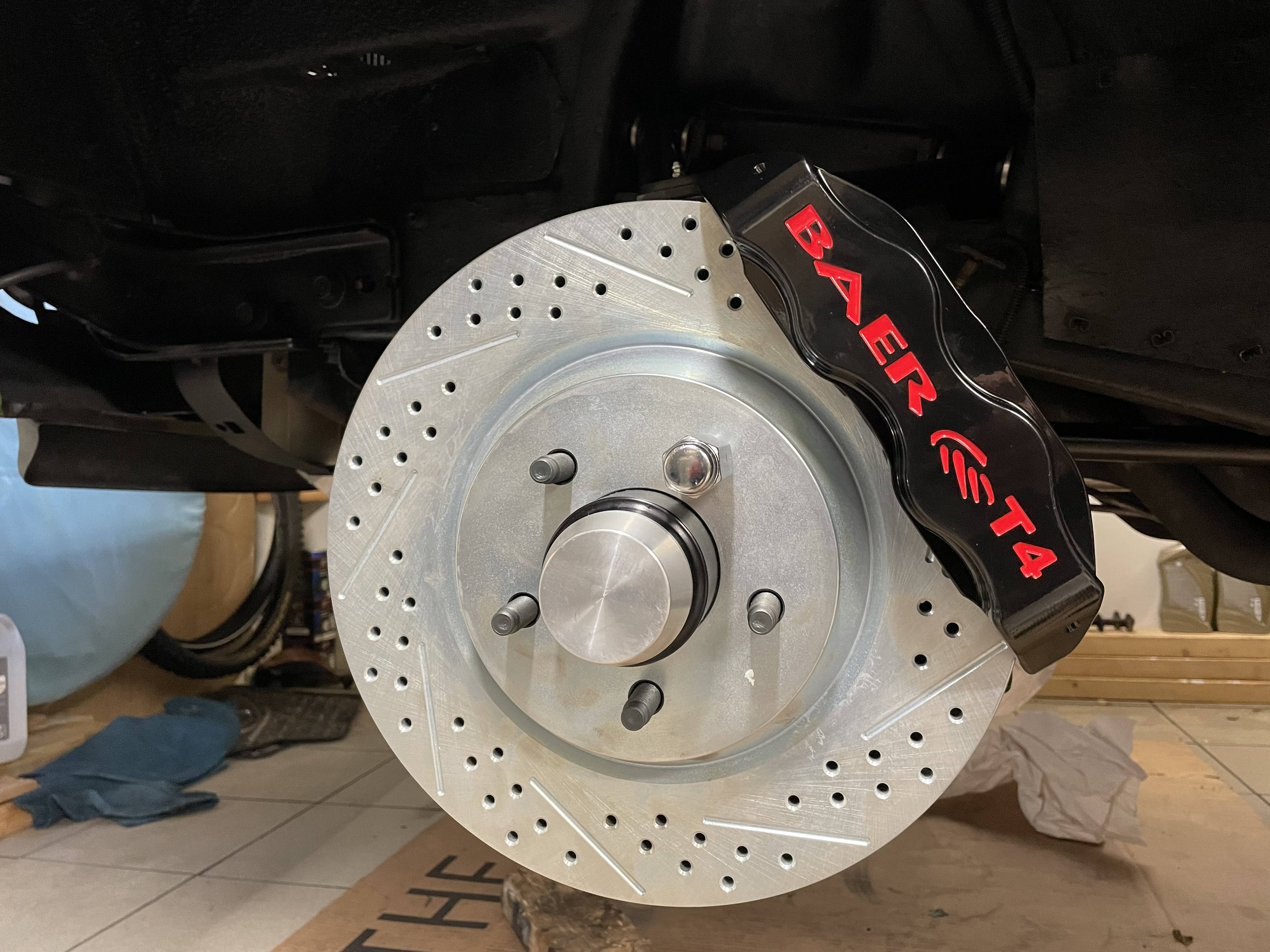

Status update - got the car on the road today! Ended up with 1/4” spacers / longer studs, a hair shaved off the caliper corners so have +1/8” clearance now. Also had to bring the balancing weight inboard and roll the arches to get everything to clear but I’m really pleased with the results and no rubbing at full lock on the bump stops. Just need to get the center caps fitted. I kinda like the raw look without though 🙂 Suspension rides sweet, firm but not jarring.
