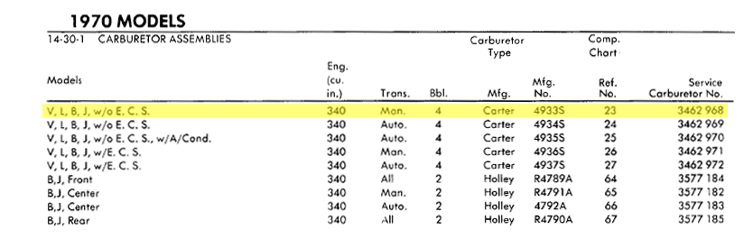

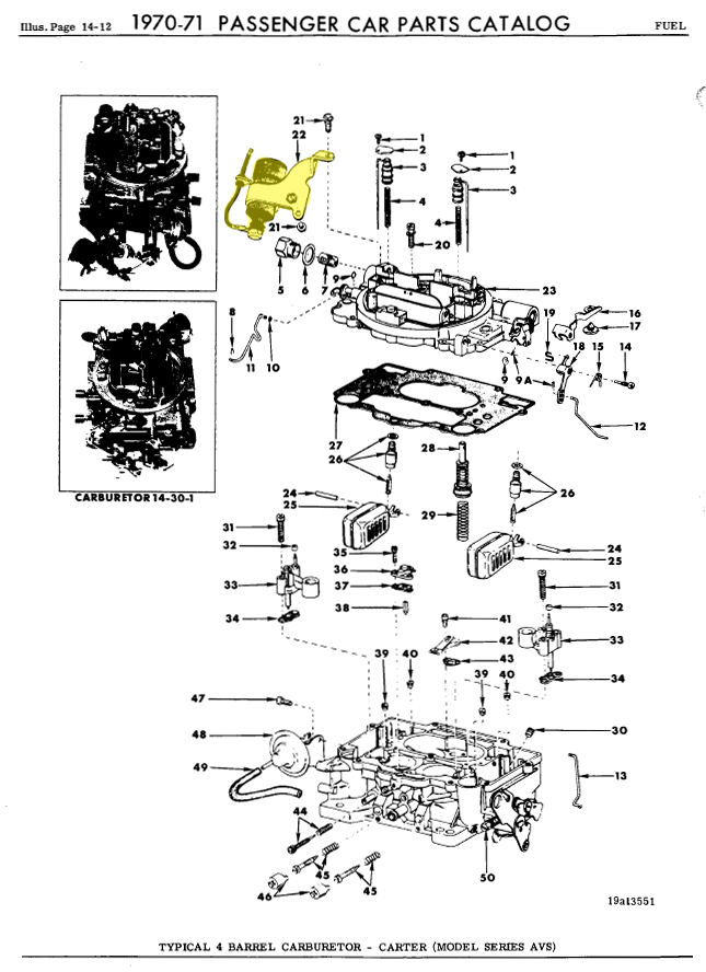

The carb was MIA on my car when I got it. My car a 340, manual trans, with A/C.

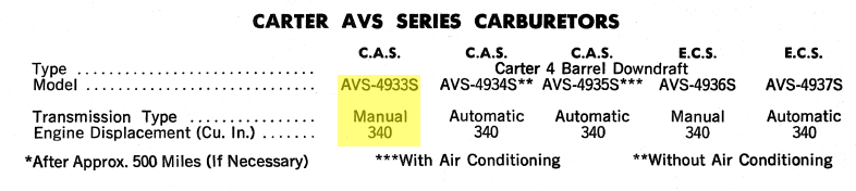

Page 14-50 states
"The Carter four barrel carburetor models C.A.S. (Cleaner Air System) AVS-4933S, AVS-4934S, and AVS-4935S are used on the 340 cu. in. engines, when the vehicles are equipped with manual or automatic transmission respectively. AVS-4935S is used with vehicles with air conditioning only, and has a hot idle commentator valve."
and Page 14-124
It looks like the AVS-4933S would be the correct carb for my set up, if I'm reading this right.

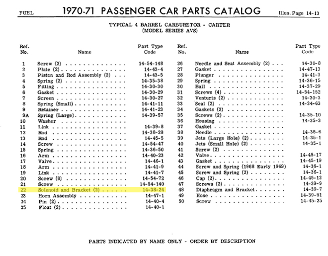

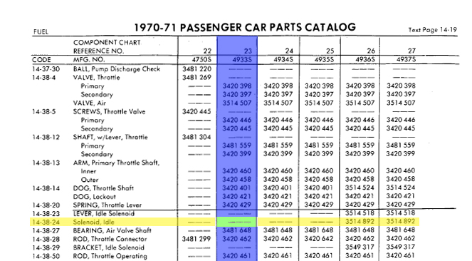

So my question would be is if I follow the parts catalog correctly it looks like there should not be an idle solenoid on this carb, any confirmation would be appreciated.
Agreed, the parts catalog is NOT showing there is an idle speed solenoid in your 4933S application.

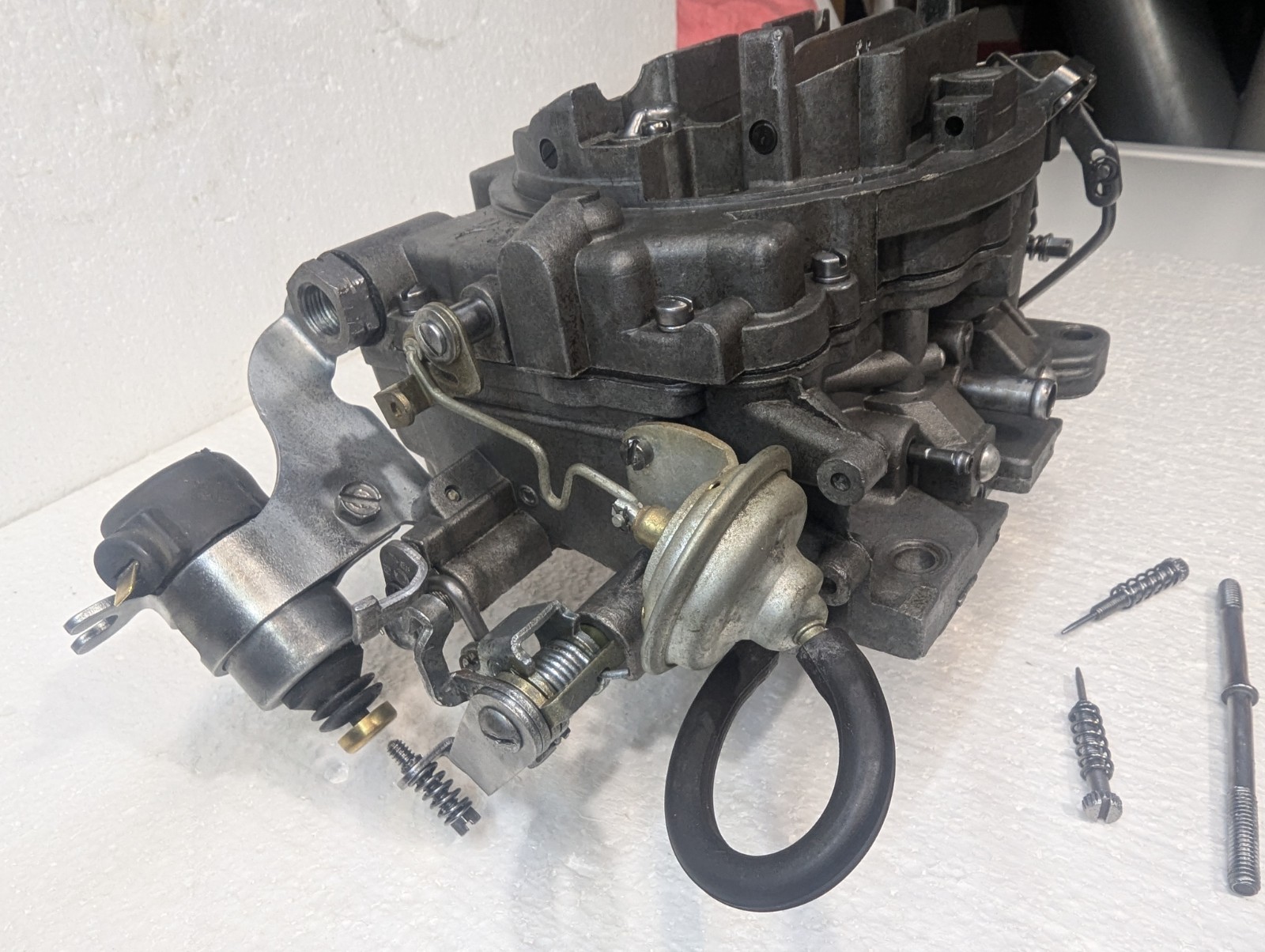

Thanks for the clarification, kind of had me scratching my head when I cam across one listed on ebay that does have it.

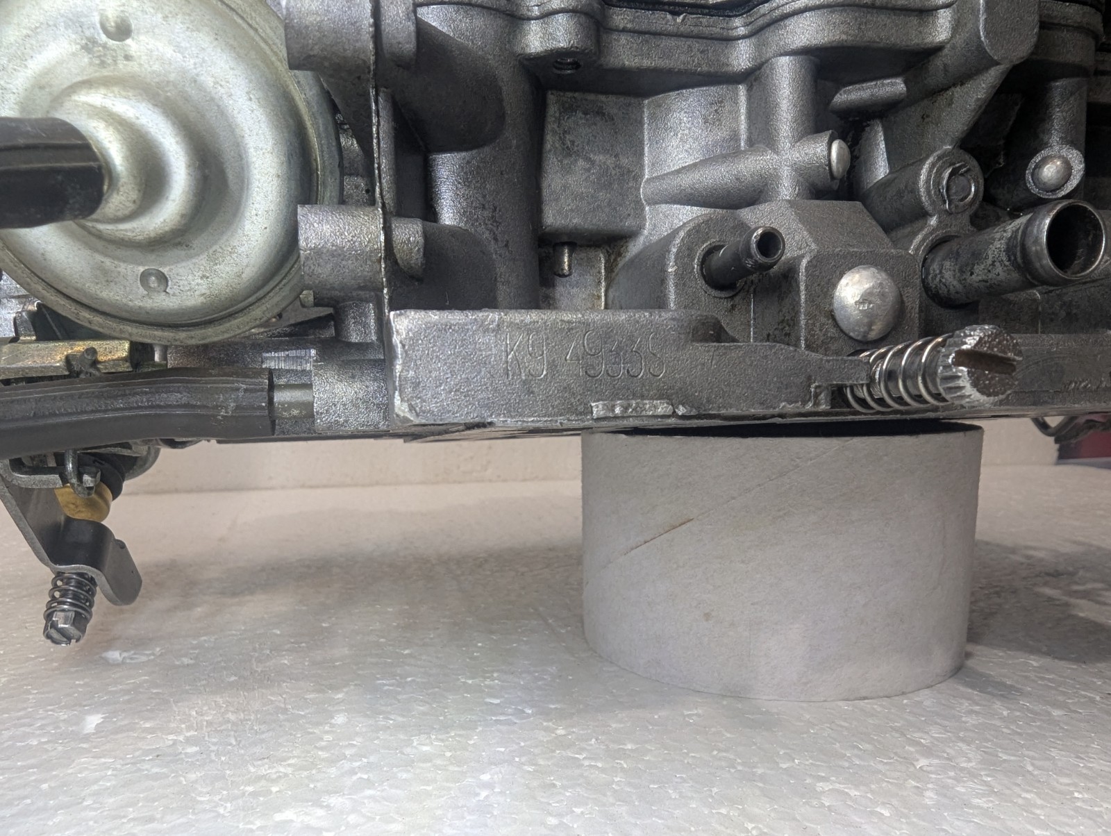

this looks like a K9 or Nov of 69 if I am reading that right, the one I have sourced is a E0 or May of 70 manufacture date which does not have the solenoid.
The parts books shows the AVS carbs issued with the 340-4 was absent on CAS cars, present on ECS.
That said, my observation is the majority of vintage AVS carburetors originally equipped with these solenoids will be missing them. It's on the rare side, the used carb is sold with the solenoid. The majority of the solenoids get removed over the years as unnecessary, by tinkering owners.
If you're looking at the date code, just make sure its a month or two before the production date on the door sticker. I looked at that carb on ebay, and it looks like someone spent a lot of time cleaning it up and making it look nice(r)

It show the 4935S is for a/c only.
GENERAL INFORMATION 340 Cubic Inch Engine The Carter four barrel carburetor models C.A.S.(Cleaner Air System) AVS-4933S, AVS-4934S and AVS4935S are used on the 340 cu. in. engines, when the vehicles are equipped with manual or automatic transmissions respectively. *** AVS-4935S is used with vehicles equipped with air conditioning only, and has a hot idle compensator valve. This valve is a thermostatically operated air bleed, to relieve an overrich condition at idle. This condition is the result of excessive heat and resultant overrich mixtures.*** (Fig. 2).The Carter four barrel carburetor models E.C.S.(Evaporation Control System) AVS-4936S and AVS4937S are also used on the 340 cu. in. engines when the vehicles are equipped with a manual or automatic transmission respectively. These two carburetors are also equipped with a hot idle compensator valve as is AVS-4935S above. (Fig. 1).All of these carburetors have a fast curb idle speed solenoid mounted on the carburetor opposite the throttle lever side. (Fig. 1). This solenoid is used to maintain a higher idle speed when the vehicle is running and allows the throttle to close to a low idle speed position when the ignition key is turned off, to prevent "after running."
This a direct reprinting from the 1970 Dodge Challenger Factory Service Manual section 14 pages 50,51 .

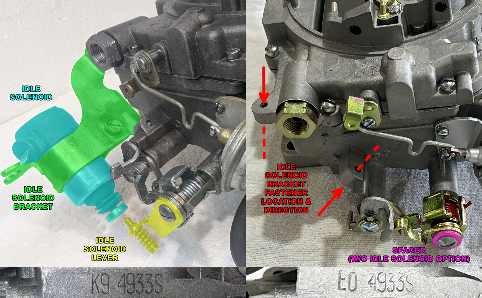

Thanks @moparleo that is what I was referring to above but was more curious if there was a change in specifications or and error in the manual which I have run into in the past. I suppose the example carb I posted from above could have been used in a different model of car with A/C and manual that could have required it. Its hard to imaging someone would add the solenoid after the fact.
Below is an image explaining the differences between the two different carb setups with and without the solenoid.
