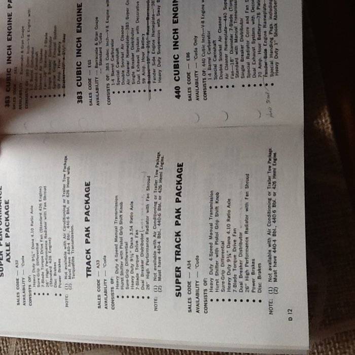

There was only one option to get a Dana in a Torqueflite 440 or Hemi car that was the Super Performance Axle Package and it was only available with the 4.10 ratio so the only way to get 3.54 would be to order this axle then get the dealership workshop to change it.

I just came across this book in my stash it's for a Cuda but might supply some answers about Dana's and option packages. I forgot I had it makes interesting reading!
