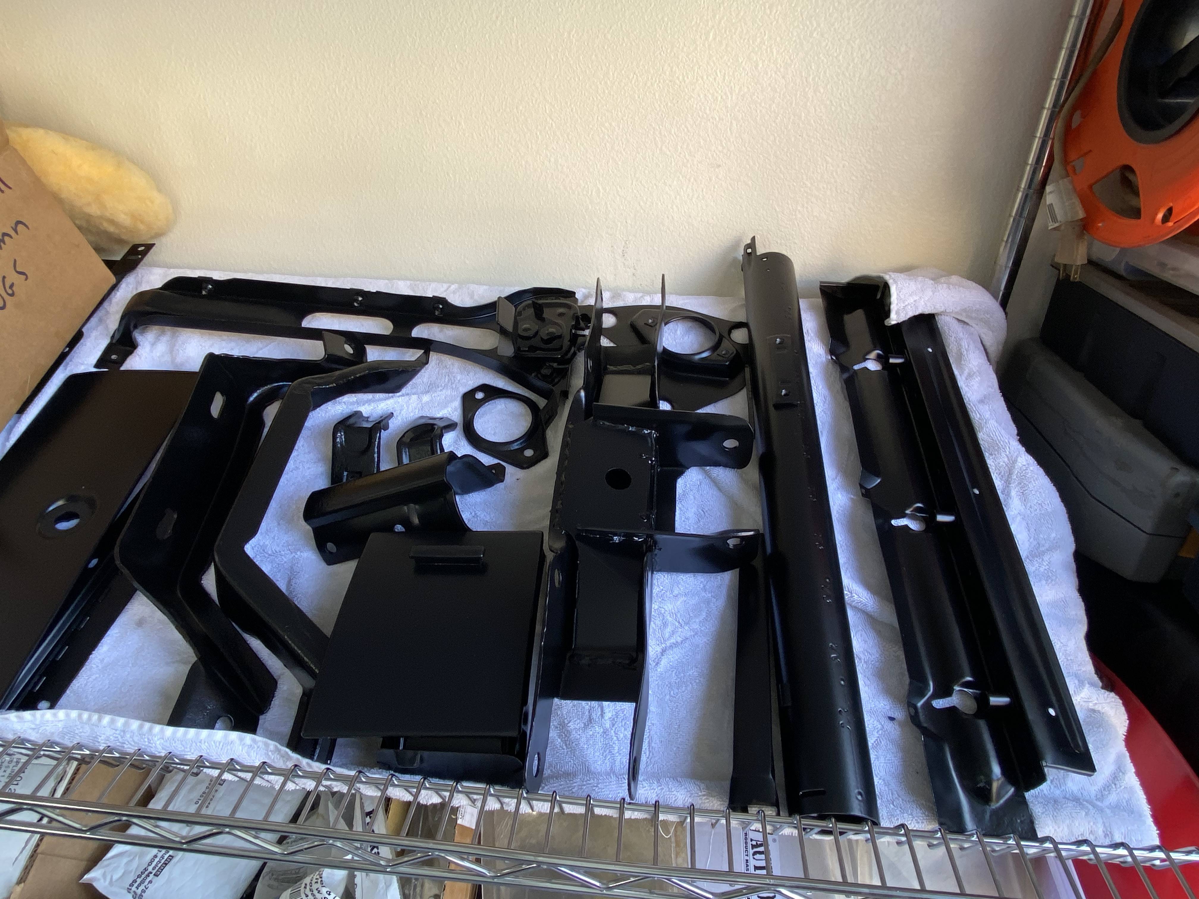

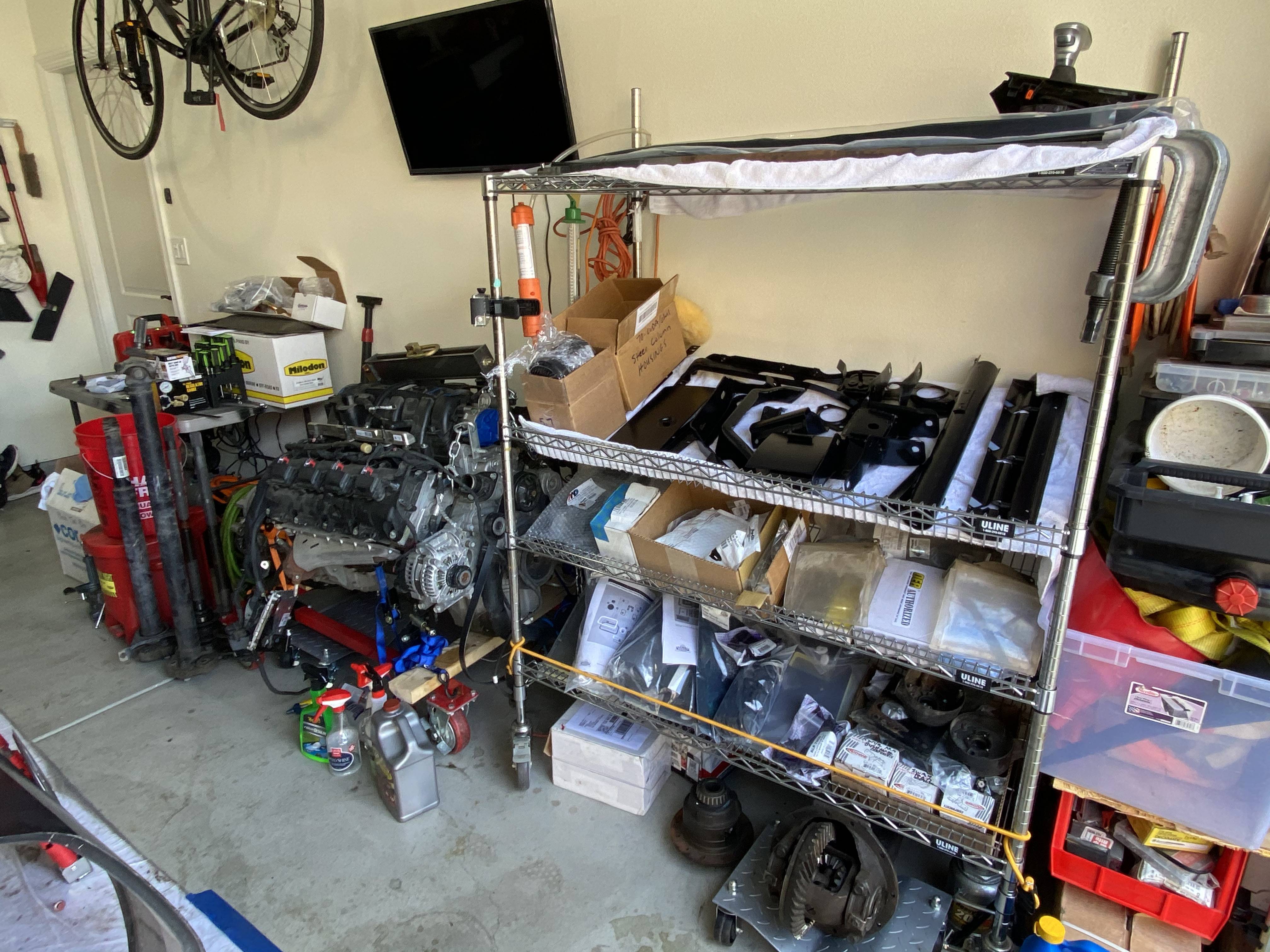

Hey folks, just a quick update, since my car wont go to paint anytime soon, I am trying to restore the rust filled metal items. Shoot man, this car was 10 times worse than i could have imagined. Here is some of the parts old restored and some new stuff to go with with the 5.7 and NAG1 trans. Also stocking up on all the little stuff new lie seals and fastners.

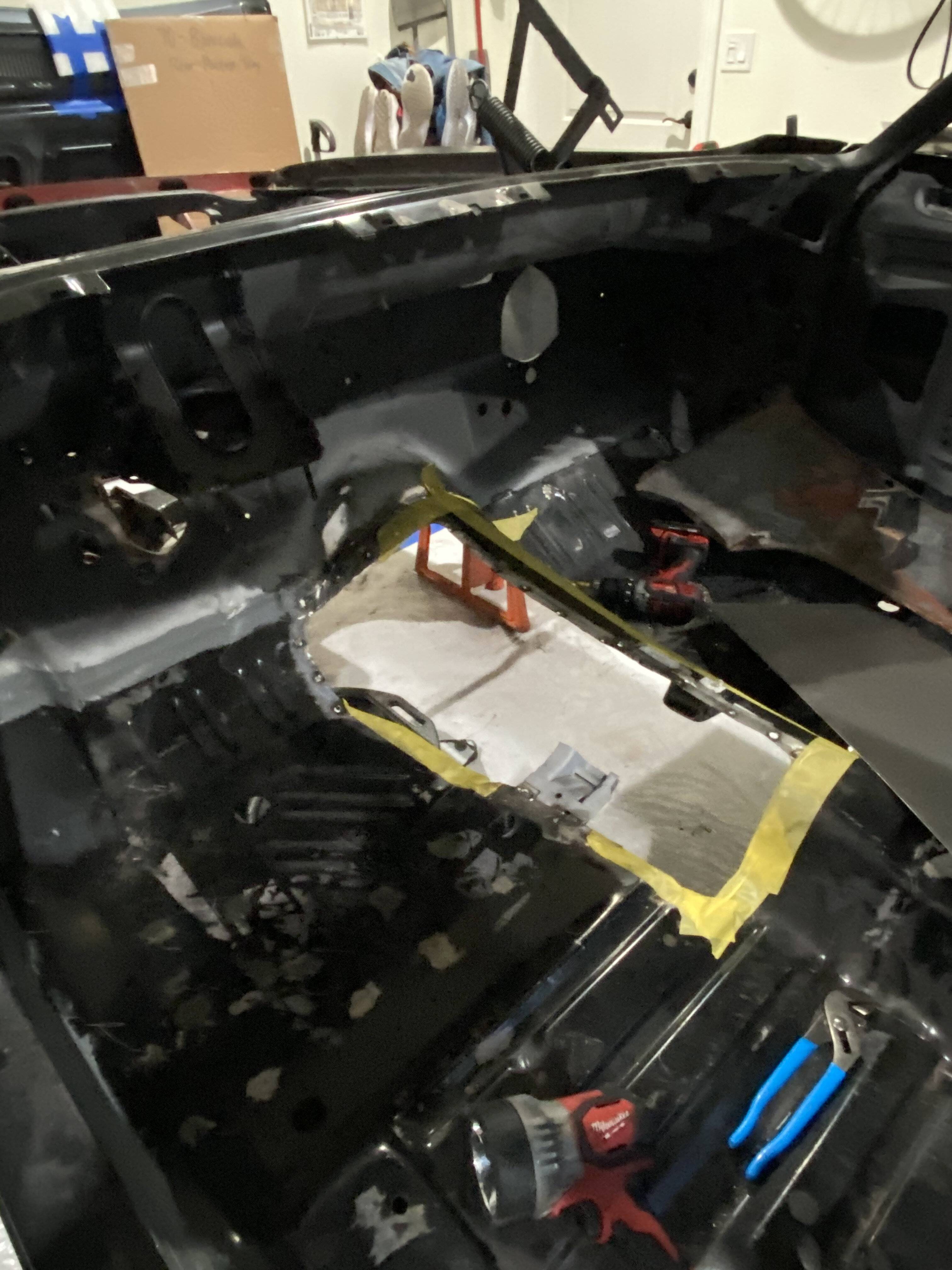

Have to cut the Trans tunnel as previous owner just welded in a new 4 Speed tunnel...... ( hope I can save it )

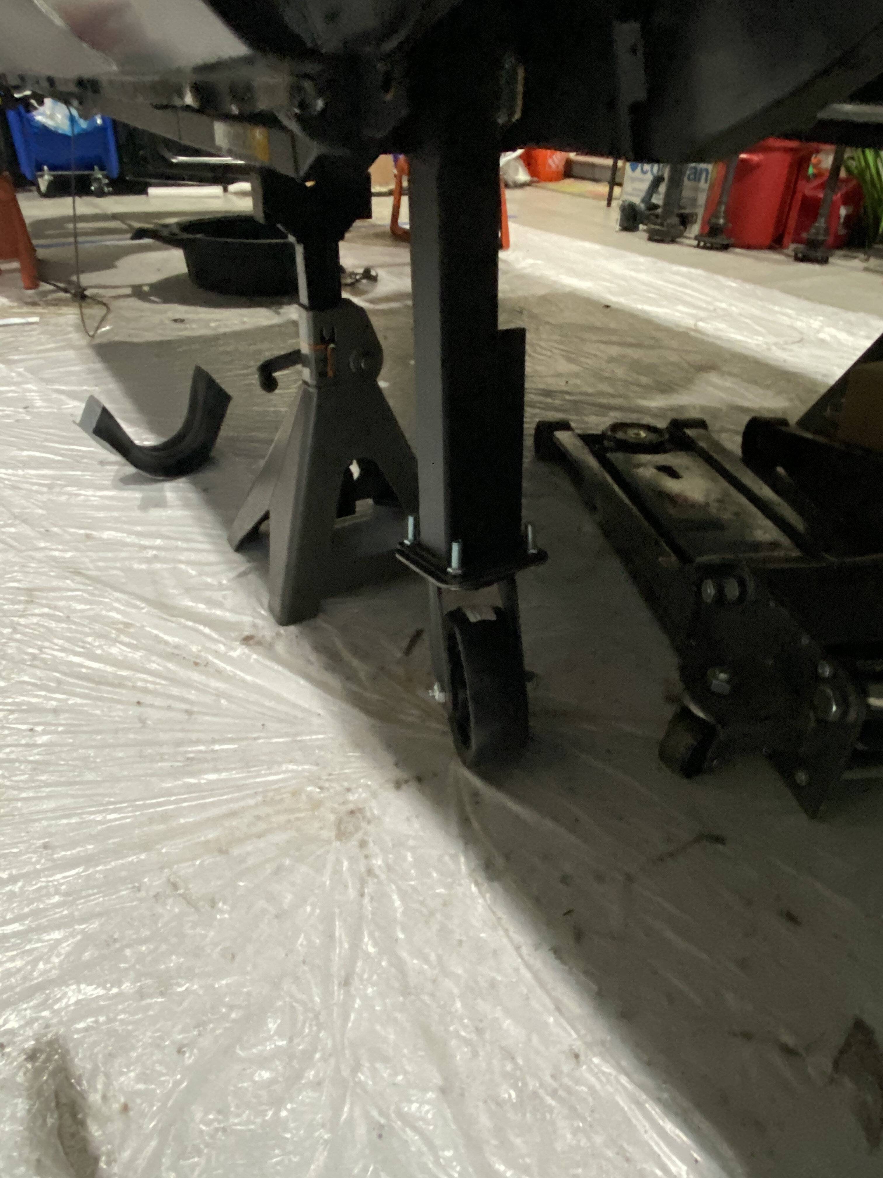

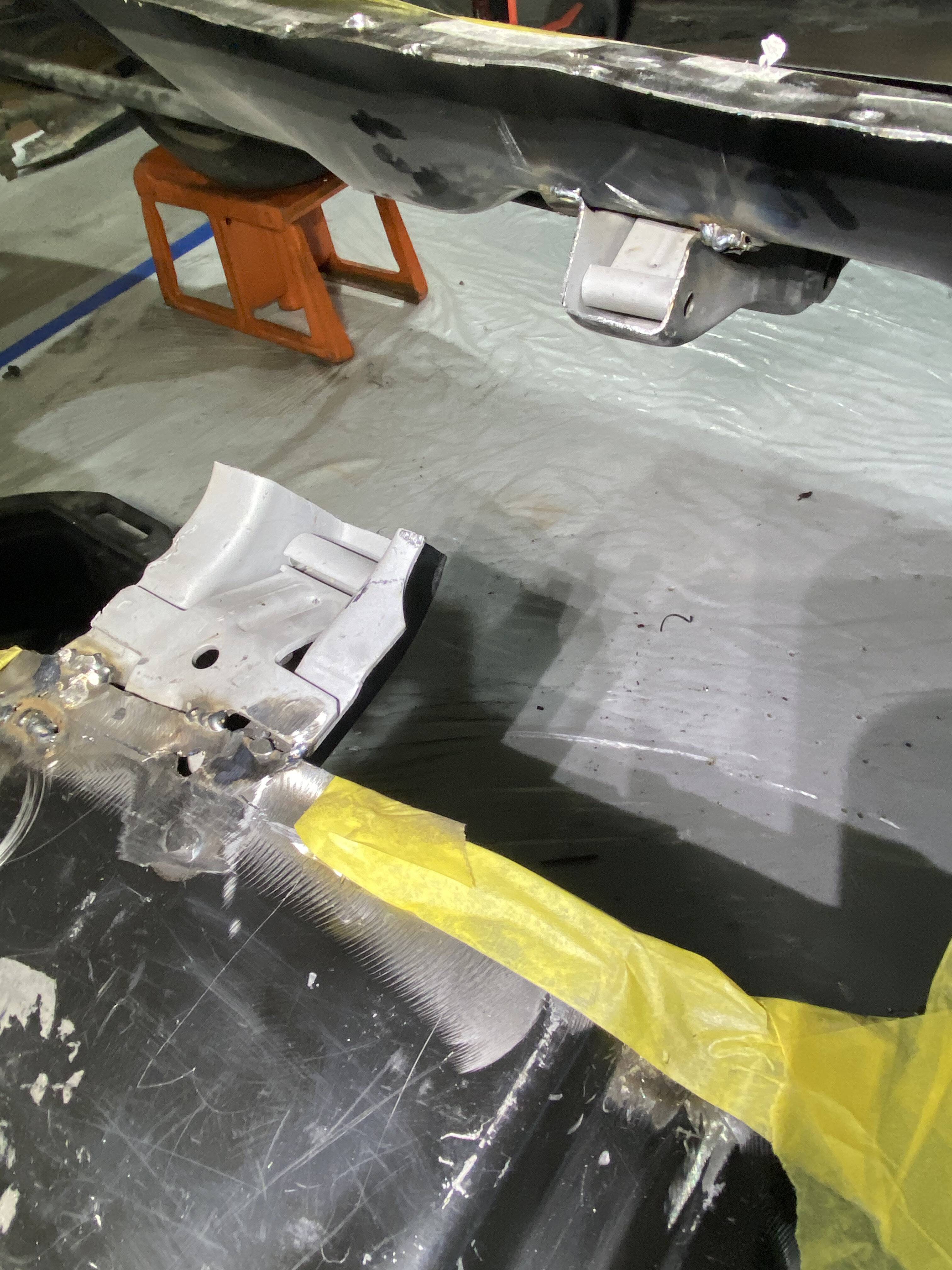

Ok, broke my heart to cut out the 4 speed trans tunnel and crossmember to make room for the 8 speed but the deed is done! Also pulled the rear leafs and fabricated a set of casters to push it around.

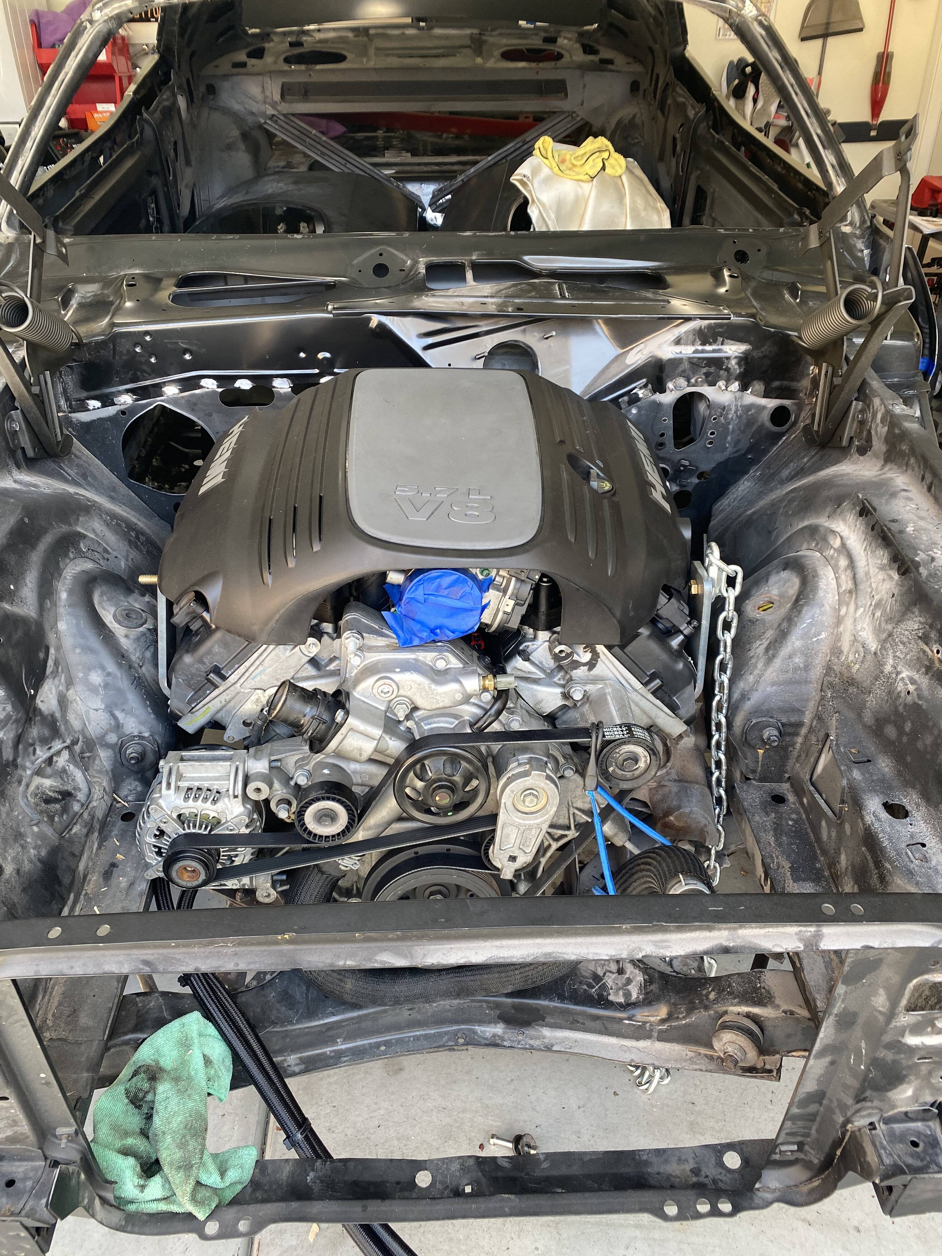

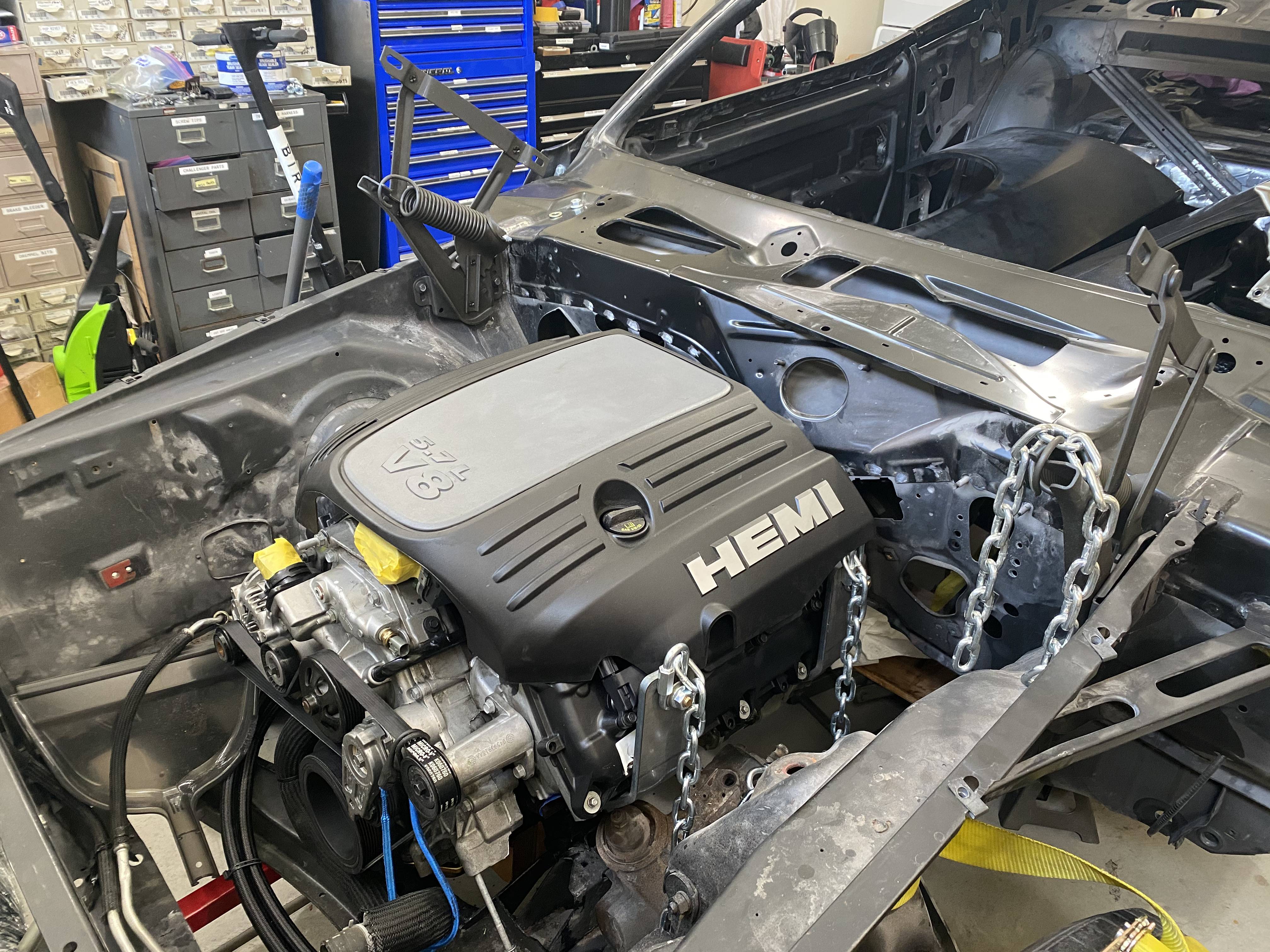

Update today, did the test fit of the 5.7 and 8 speed AT. Went in quite easily. Waiting on the trans mount from USCartool, Will be here this week.

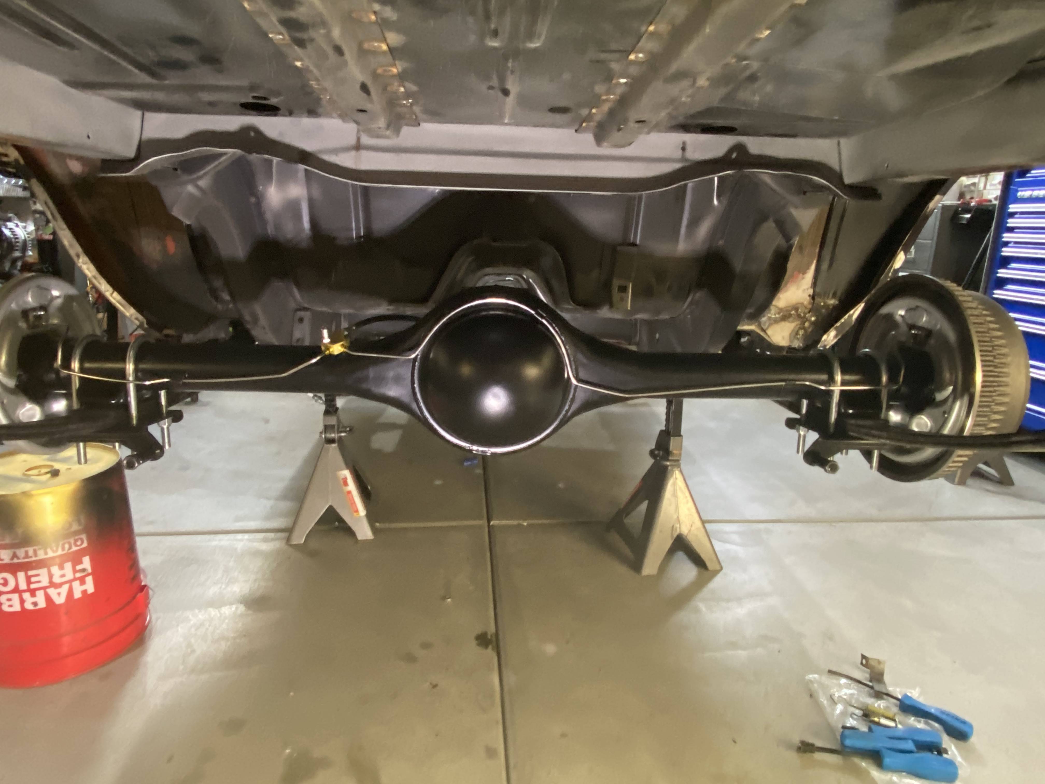

Hey folks, not a lot of progress. lately, I did rebuild the 8-3/4 rear end, put a posi, as well as a new (323) ring and pinion. Hotchkis springs. and subframe connectors. I am hoping 323 this isn't too high for the Automatic 8 speed transmission. I hear that 273 gears are recommended with this setup. Anyone have experience with the gear. ratio?

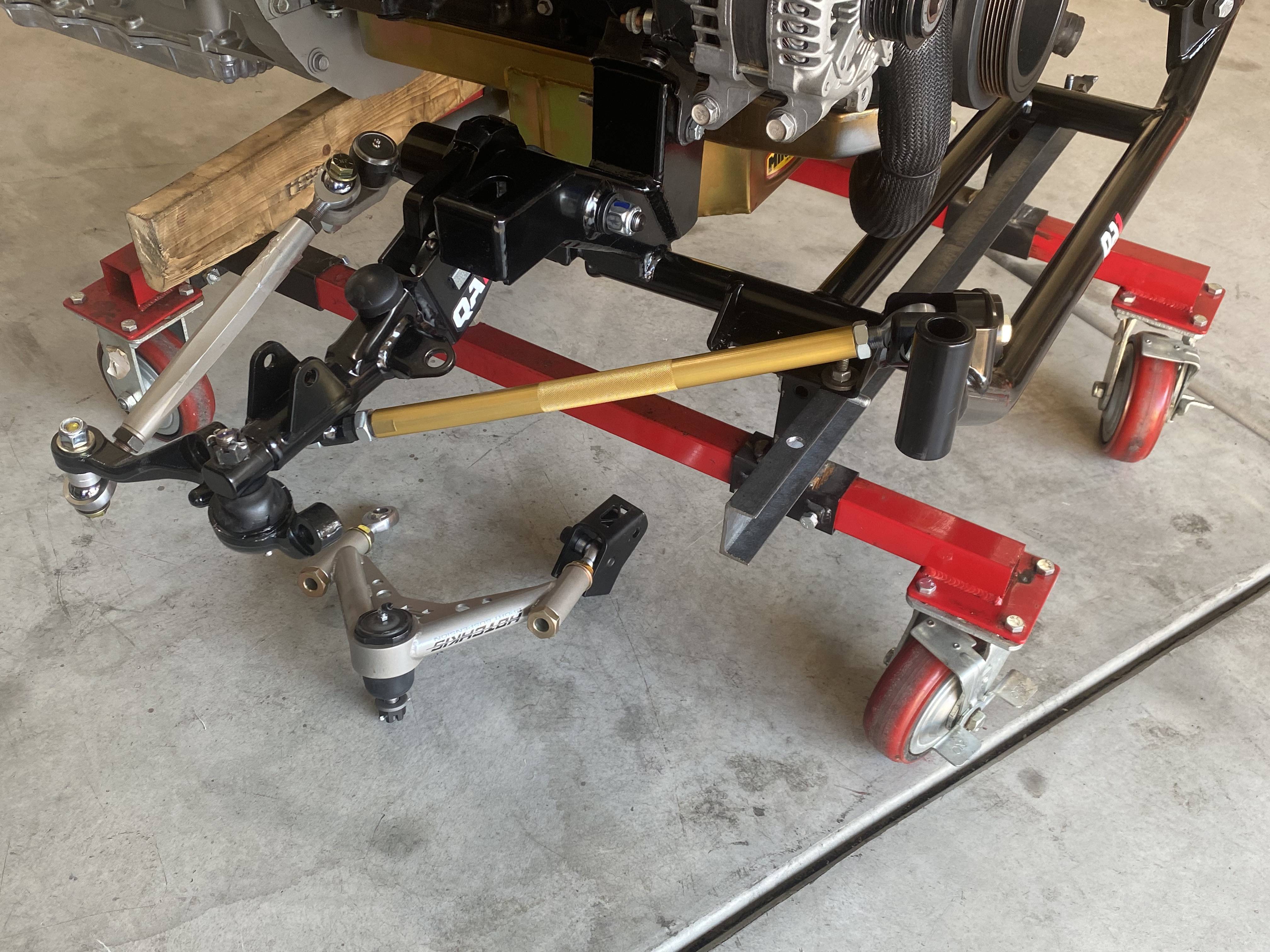

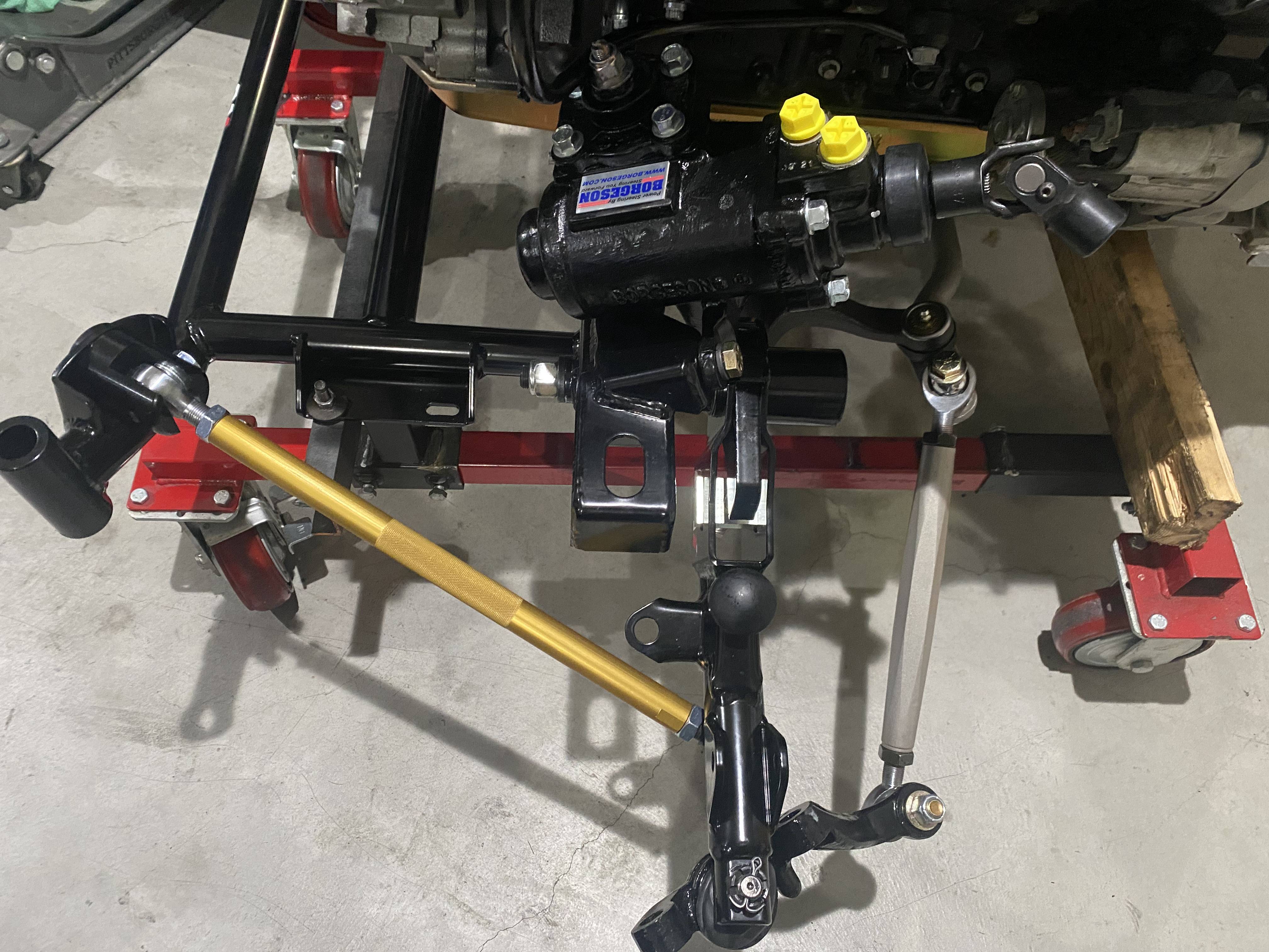

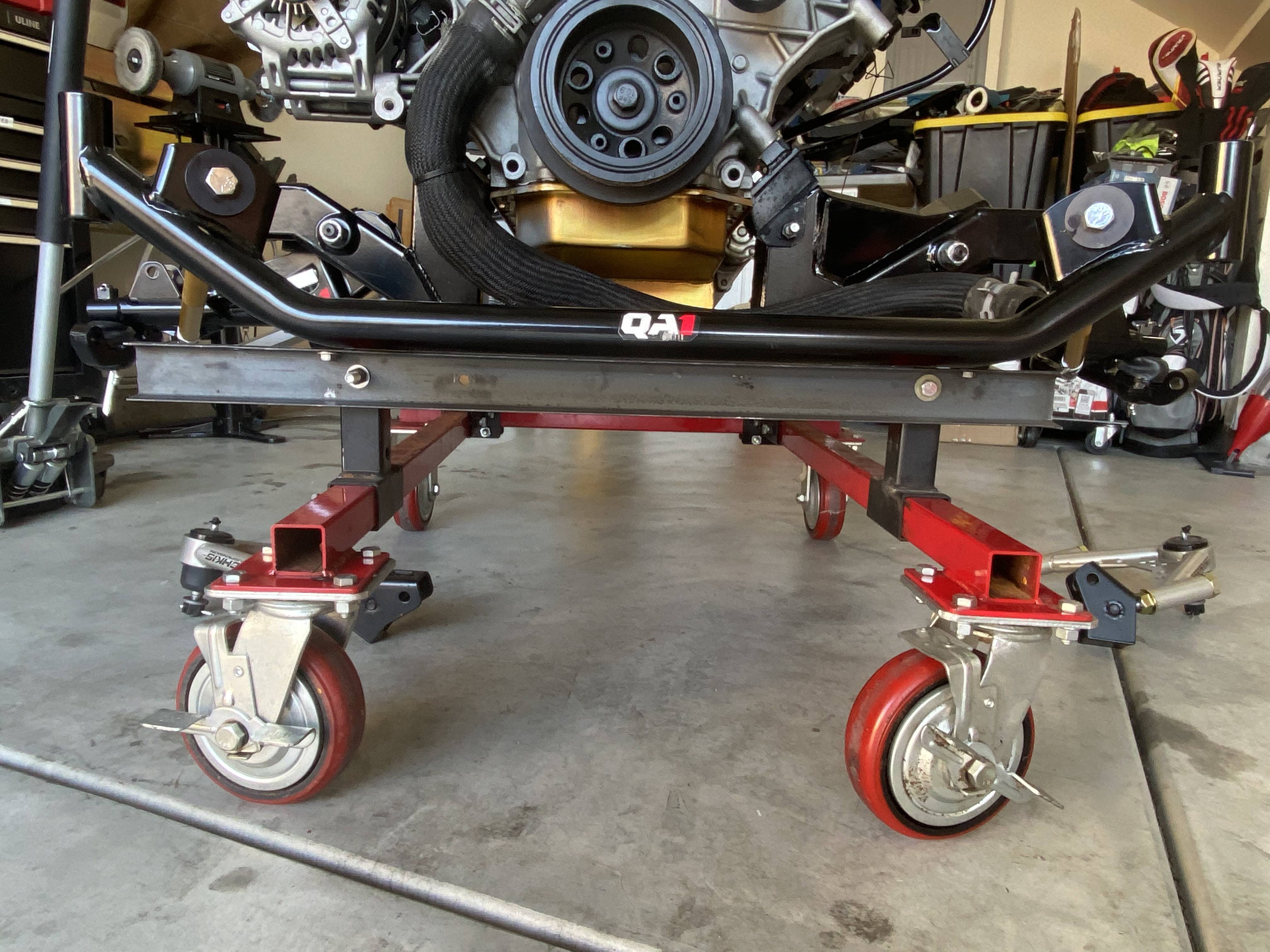

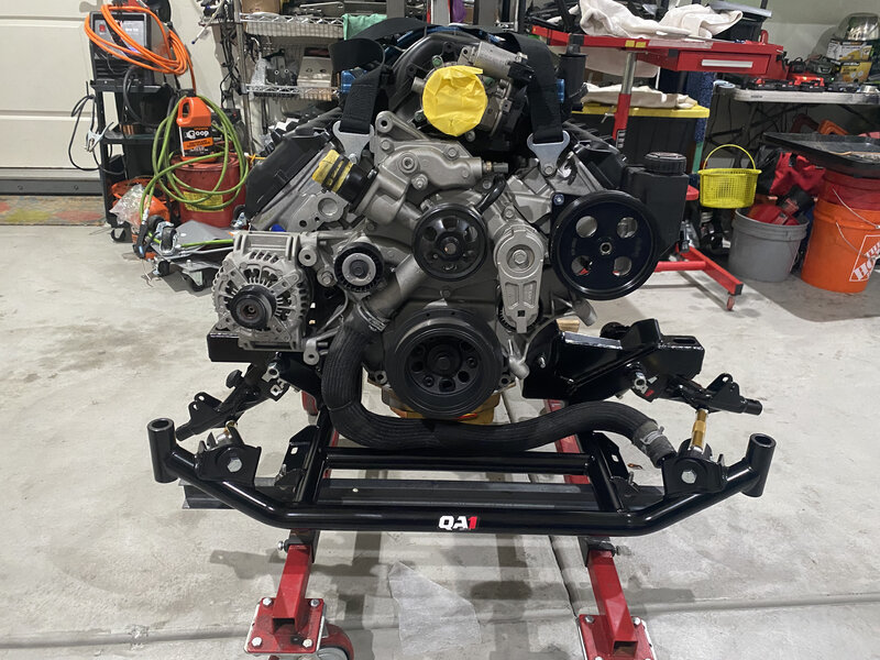

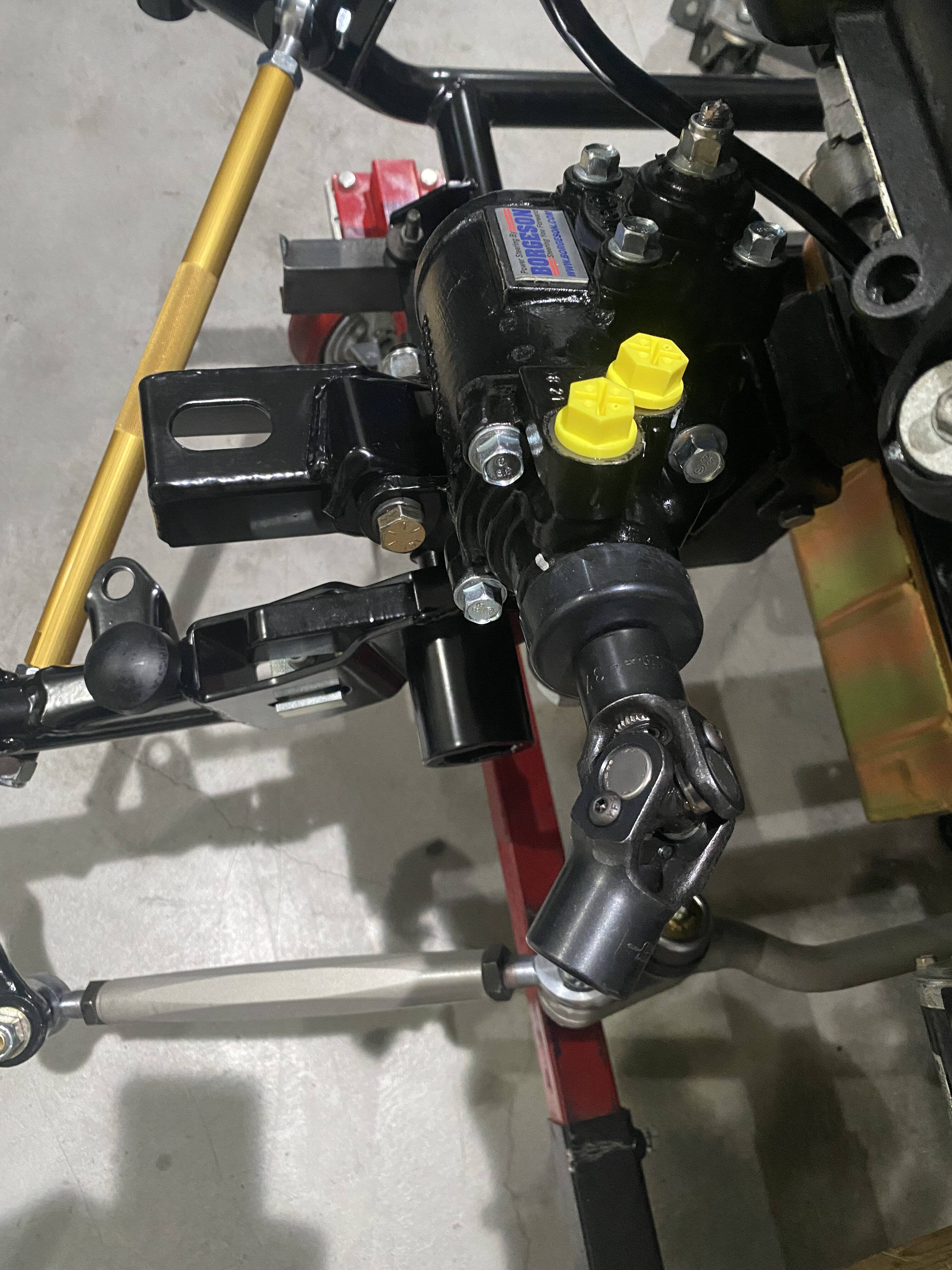

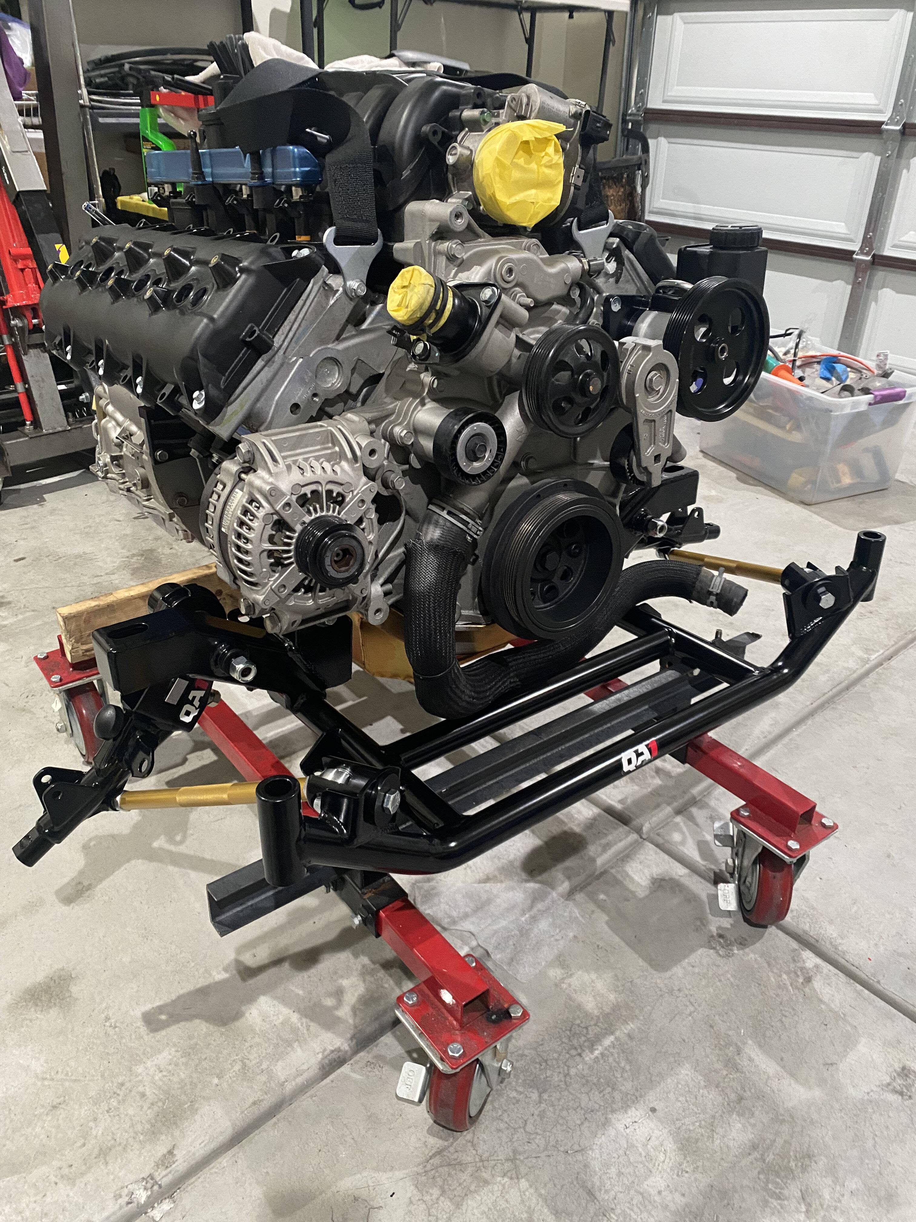

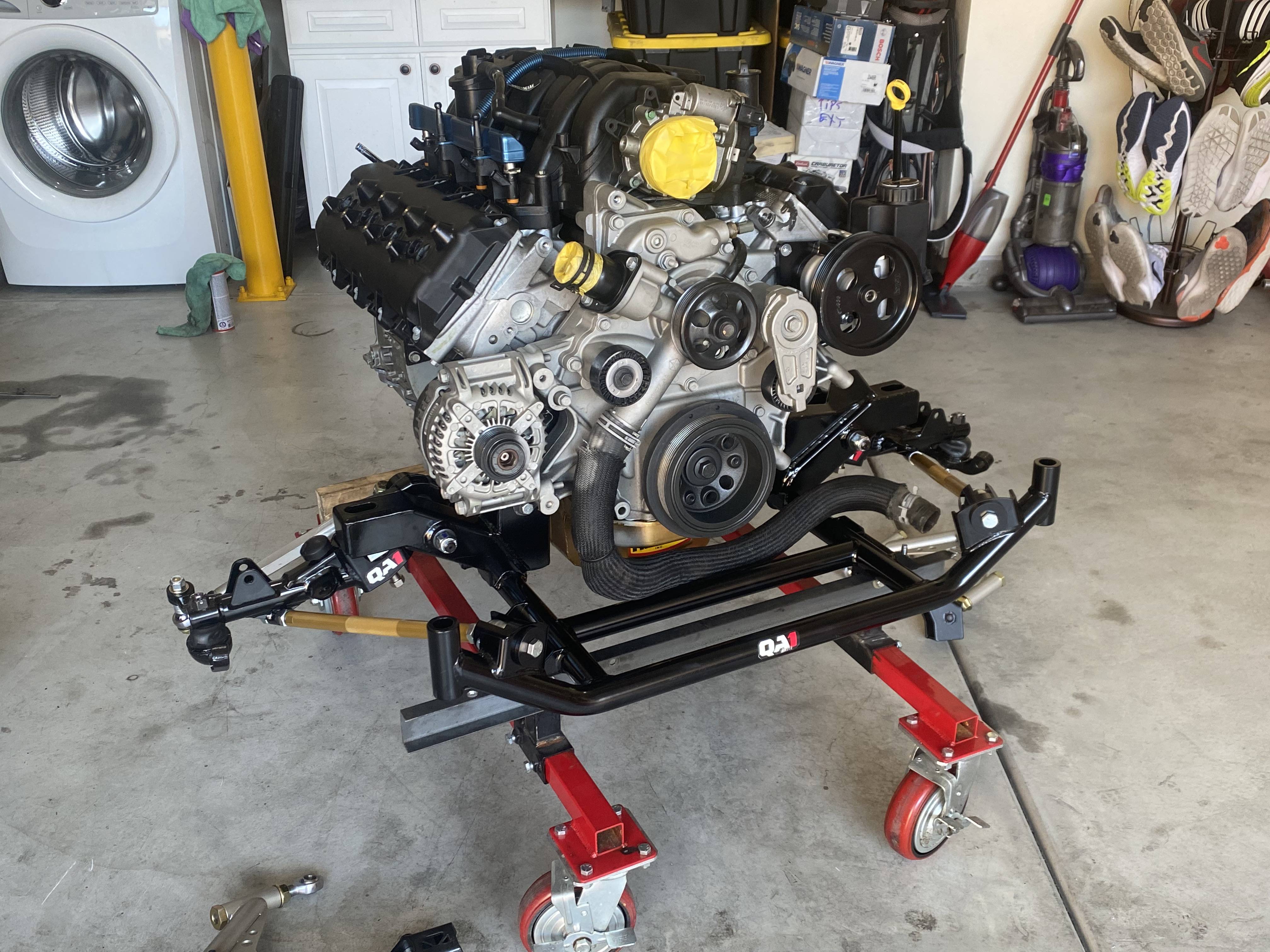

Started to put in the k-frame and suspension, for now what I have. When everything comes in, i will be ready to stick it into the car. Pending my body shop progress. Here is whats going in
QA1 K-Frame, lower control arms, sway bar, dynamic strut bars
Hotchkis- Upper control arms, tie rod adjusters and Torsion bars
Wilwood Slotted and drilled disk brake kit ( still waiting on it )
Borgenson Power Steering box.
Moog Pitman and Idler arms

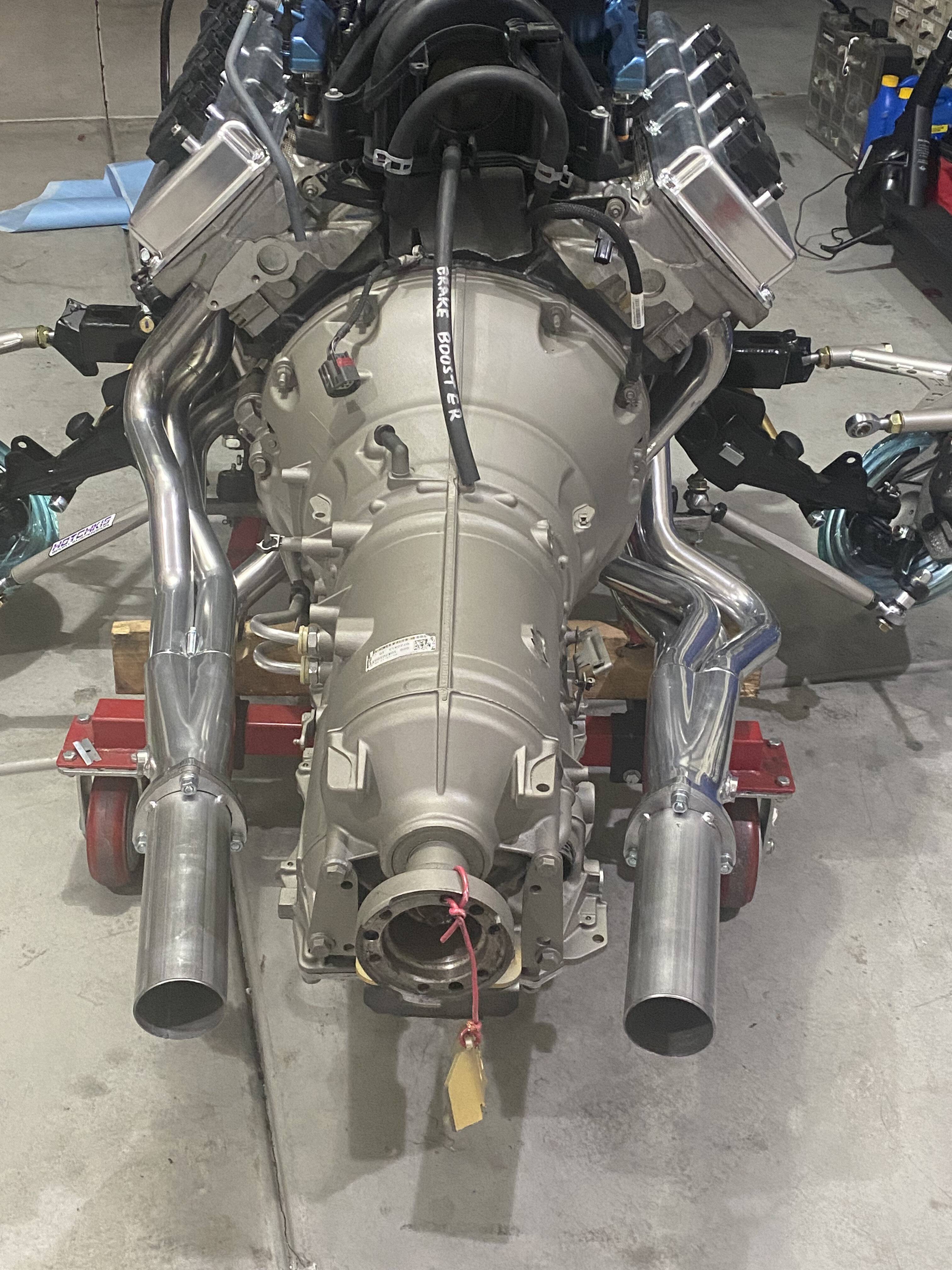

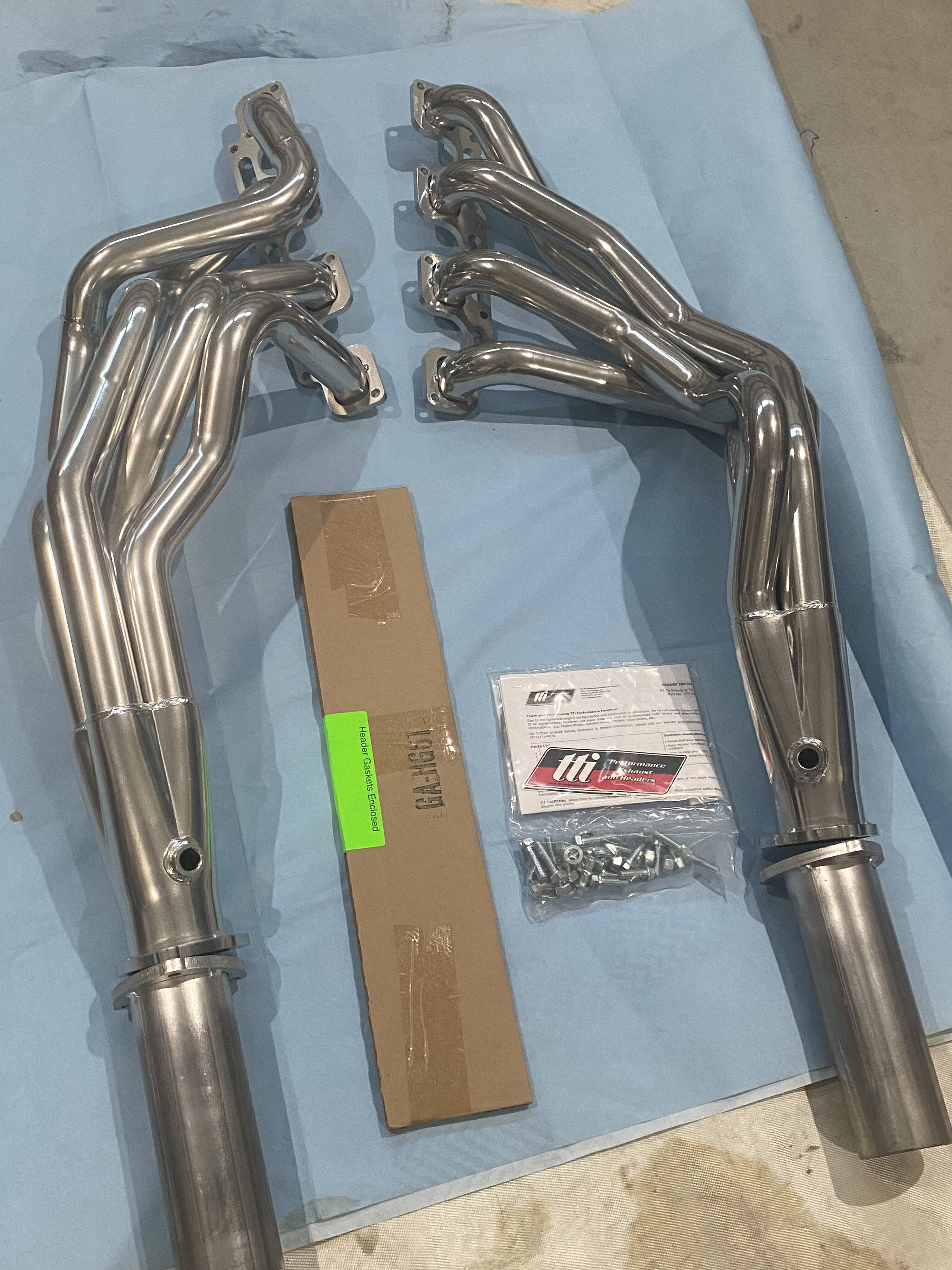

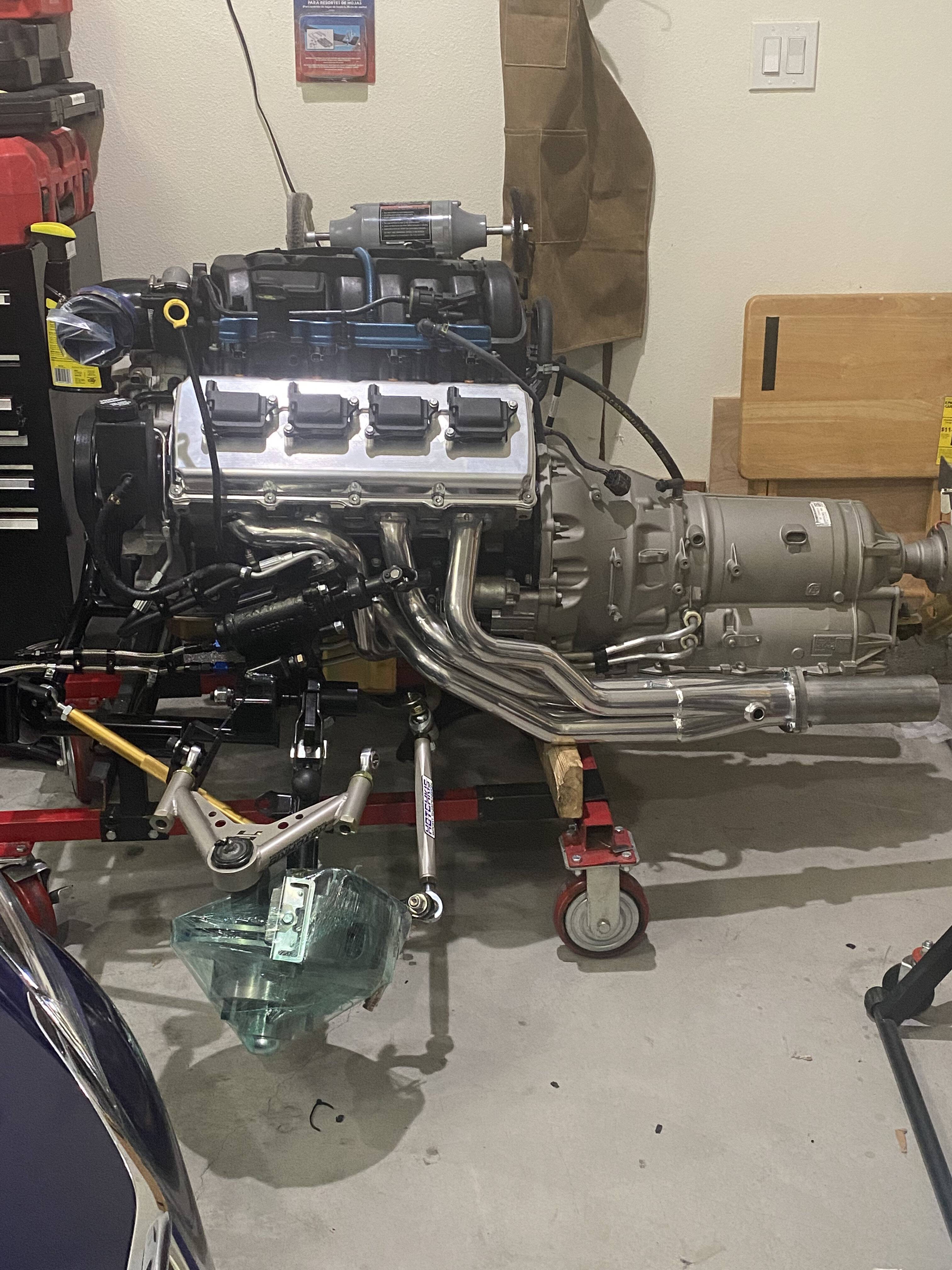

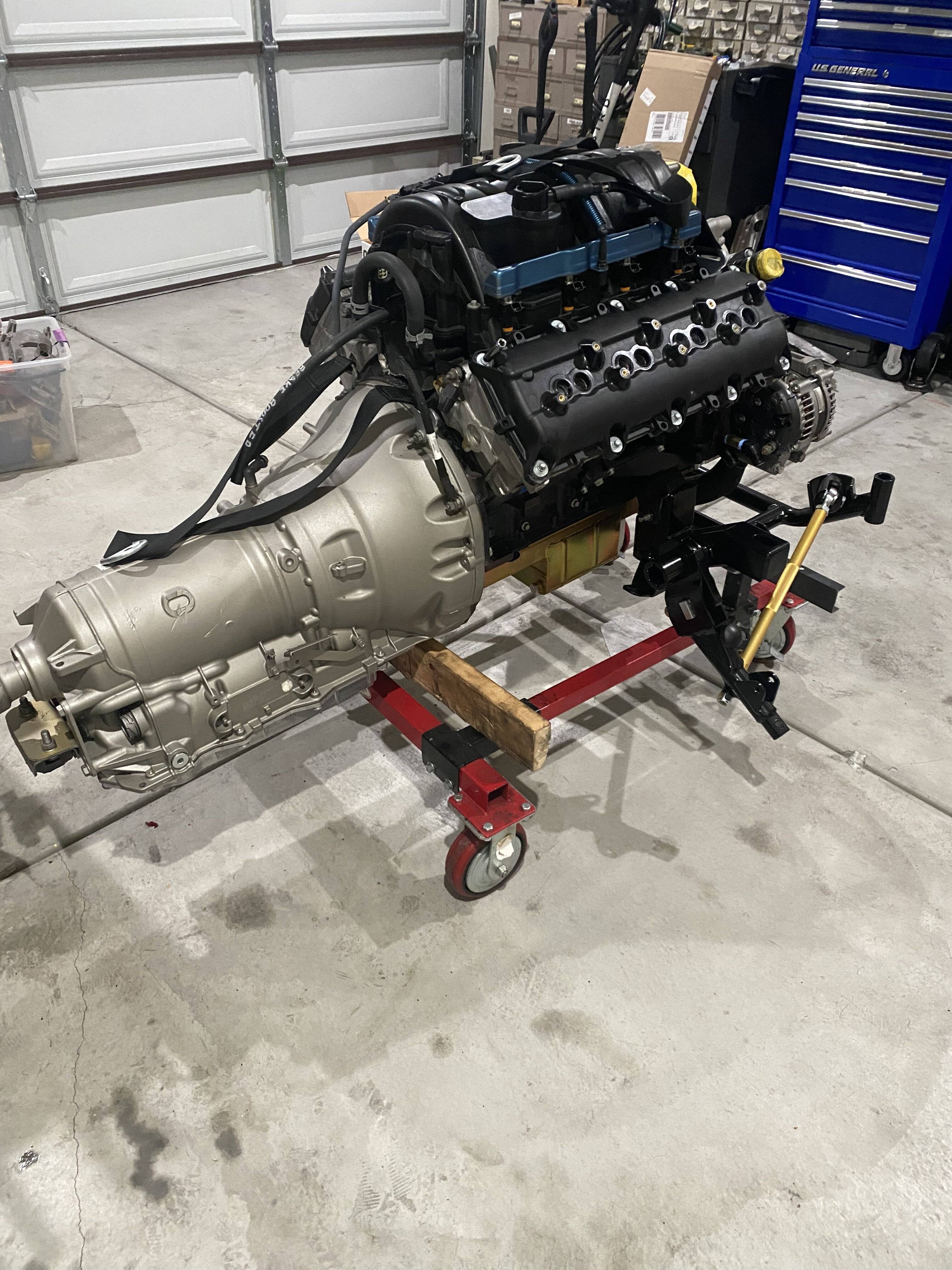

Ok received my piece of ARTwork from TTI Exhaust today. I am amazed how. nice these headers are and how great they fit. I did not have to do ANYTHING. to them.

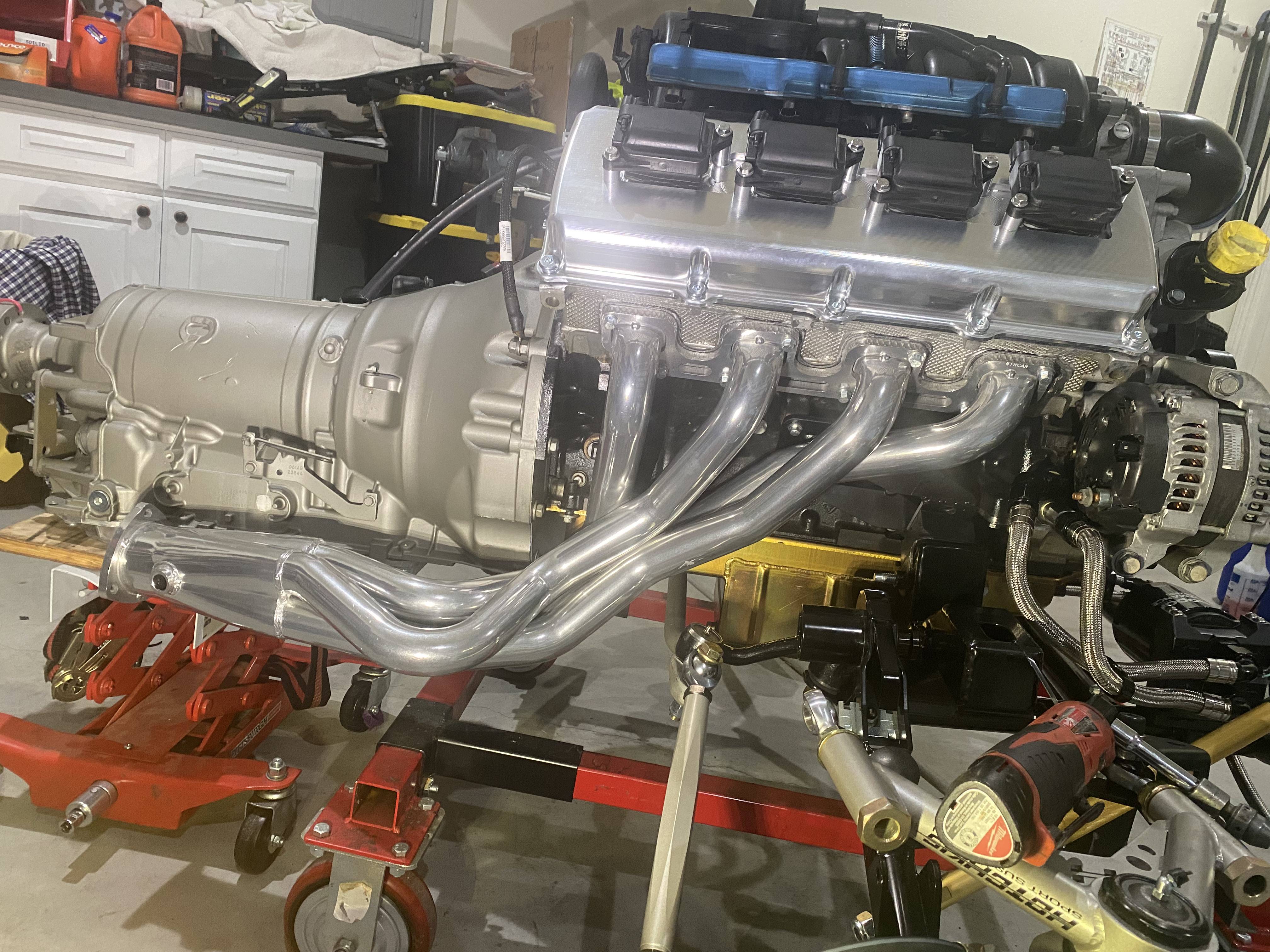

I am excited to have the 3 inch collectors as the MAGNA Flow exhaust should sound awesome. Engine is finally ready to install, remote oil filter and. AN-6 trans lines done. Let me know your thoughts folks.
