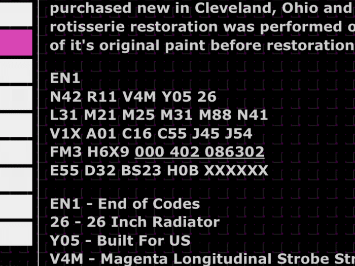

- VON 086302 belongs to a CUDA ordered from a dealership in Cleveland, OH.
You find your cars vehicle-order-number (VON) on your 1970 fendertag in the second line from bottom, it is the last 6 digits on the far right, see attached example-pic I borrowed from the www (yes, that samplepic shows a Cuda, though I am searching for Challengers).
