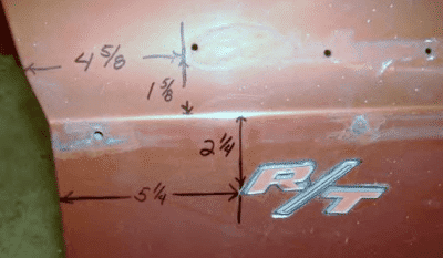

I have replaced my hood and fenders with AMD sheetmetal but have no idea where the emblems go now.. I need the following please.
Driver/Pass fender- Challenger script and R/T emblem that goes underneath. Pentastar location on the pass side.
Hood- location of 383 Magnum emblems on the side.
Any help is much appreciated!

This may help!
