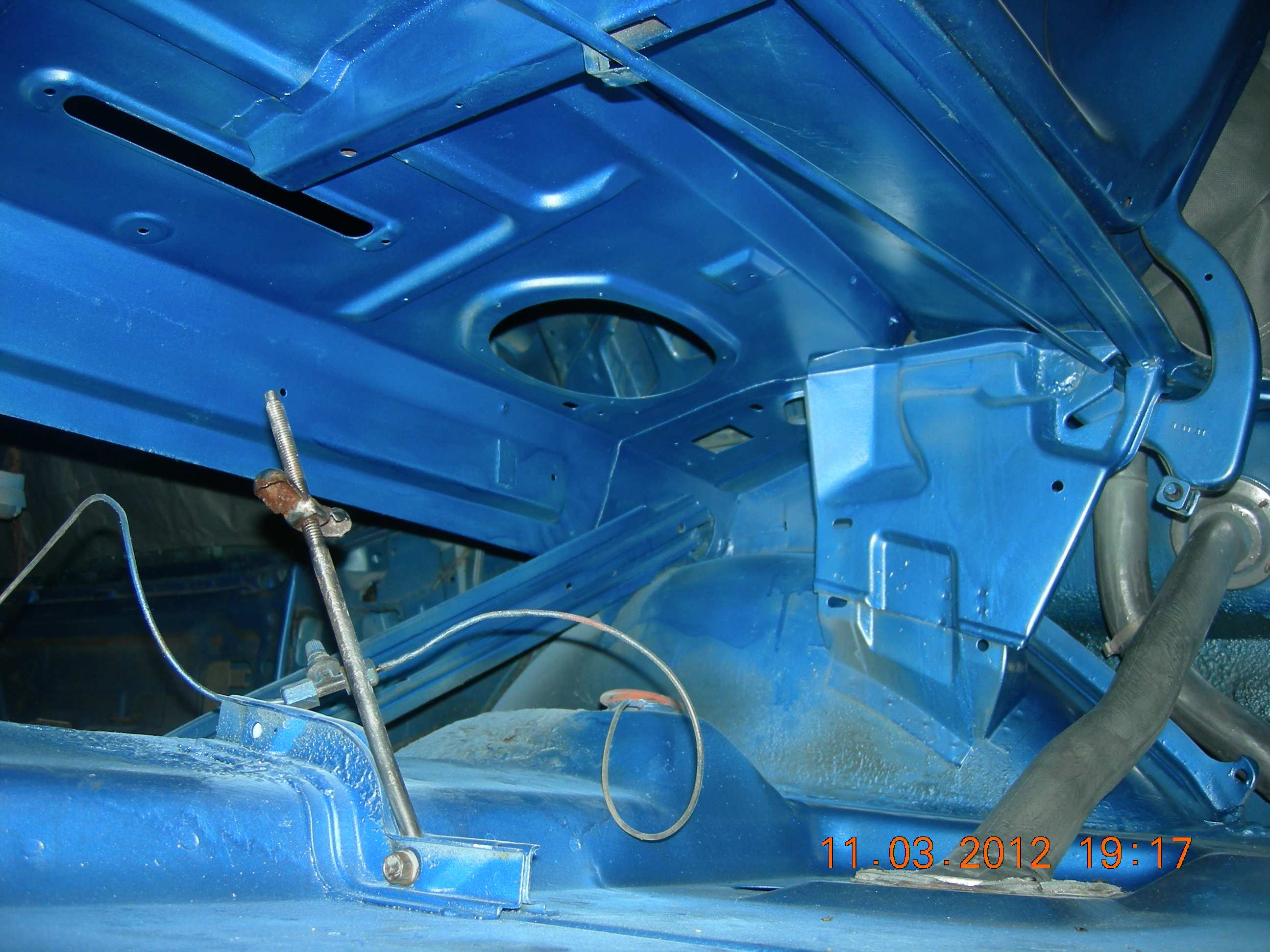

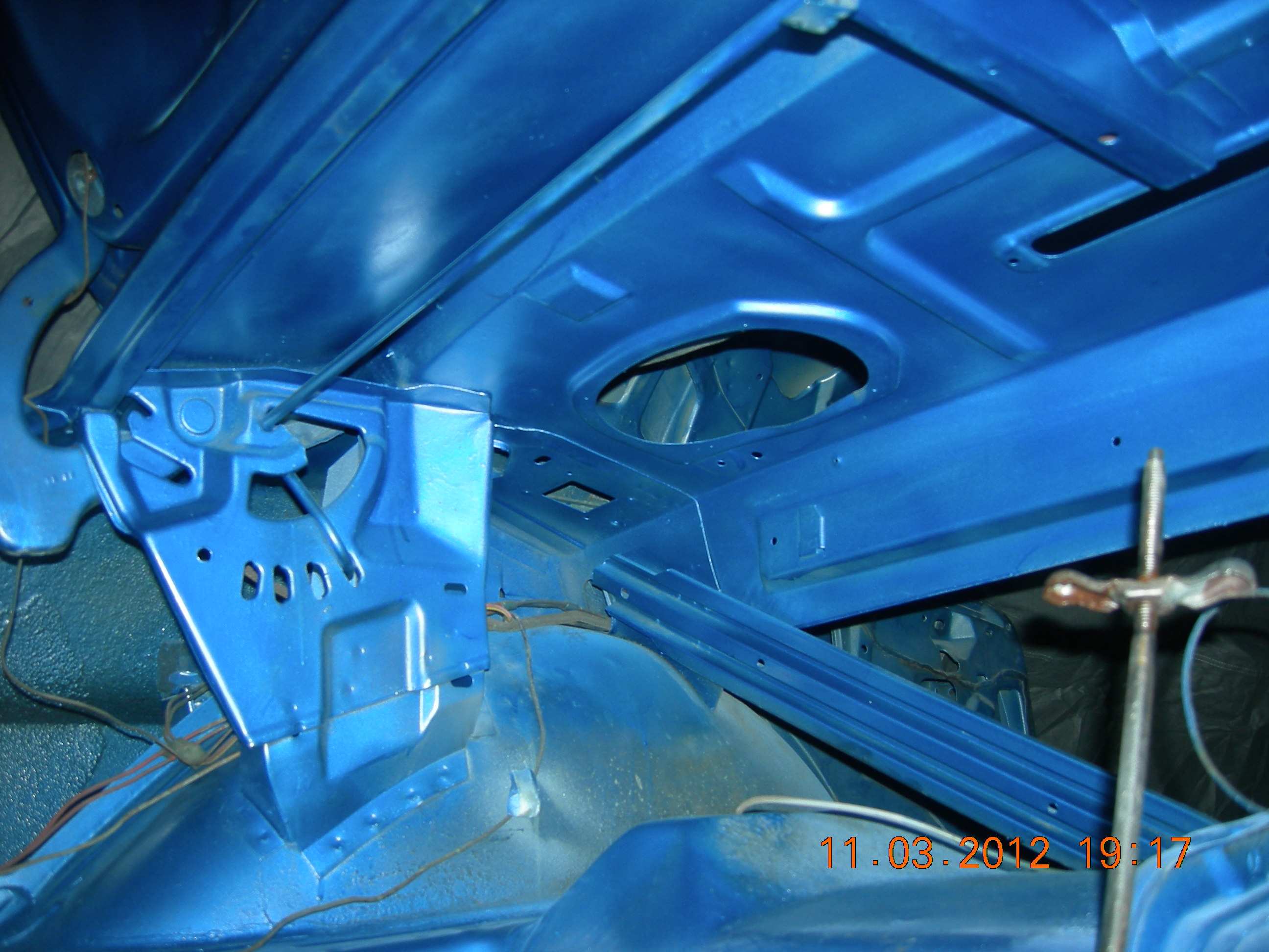

Show a picture of how you have it installed.

Do you have the adjustment in the correct hole for highest lift power if not maybe you need a new torsion rod
