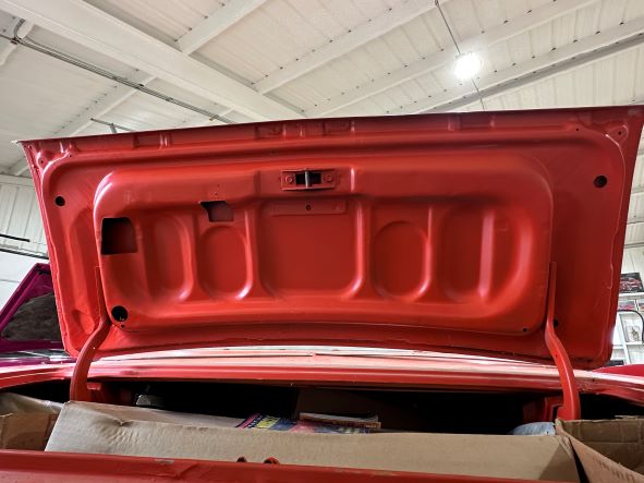

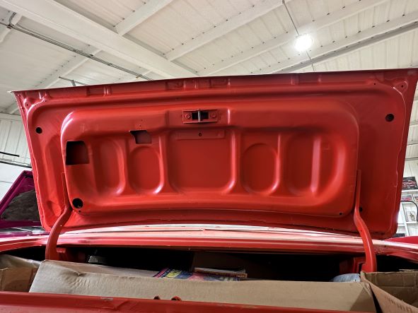

Ok, the trunk lid is one the questions I have yet to figure out on my car, and one of the reasons for joining this forum. My car came from the factory with a luggage rack, documented by the build sheet, and it was built Oct. 69 at the LA plant. It did not have a luggage rack when I bought it. At that time, I didn't care, I never planned on one. Well, fast forward to now, and I will go back with one. I actually got a decent, original luggage rack as of yesterday. I kind of like the looks of them now. Makes it "different."
After finding this thread and then going to look at mine, well, I don't know what I have?
That lid is a 1972-4 style. Your car is/was obviously missing the correct one. You will need to obtain a correct one for your car. Also, that lid was not "Drilled" for luggage rack. The underside of any 1970-74 lid always had the four holes cast into it from the factory, as the luggage rack was an option for all those years. Your original lid would have had the four stud holes for the rack installed at the factory on the lid, the top half, that is. You need to find one that has those on it.

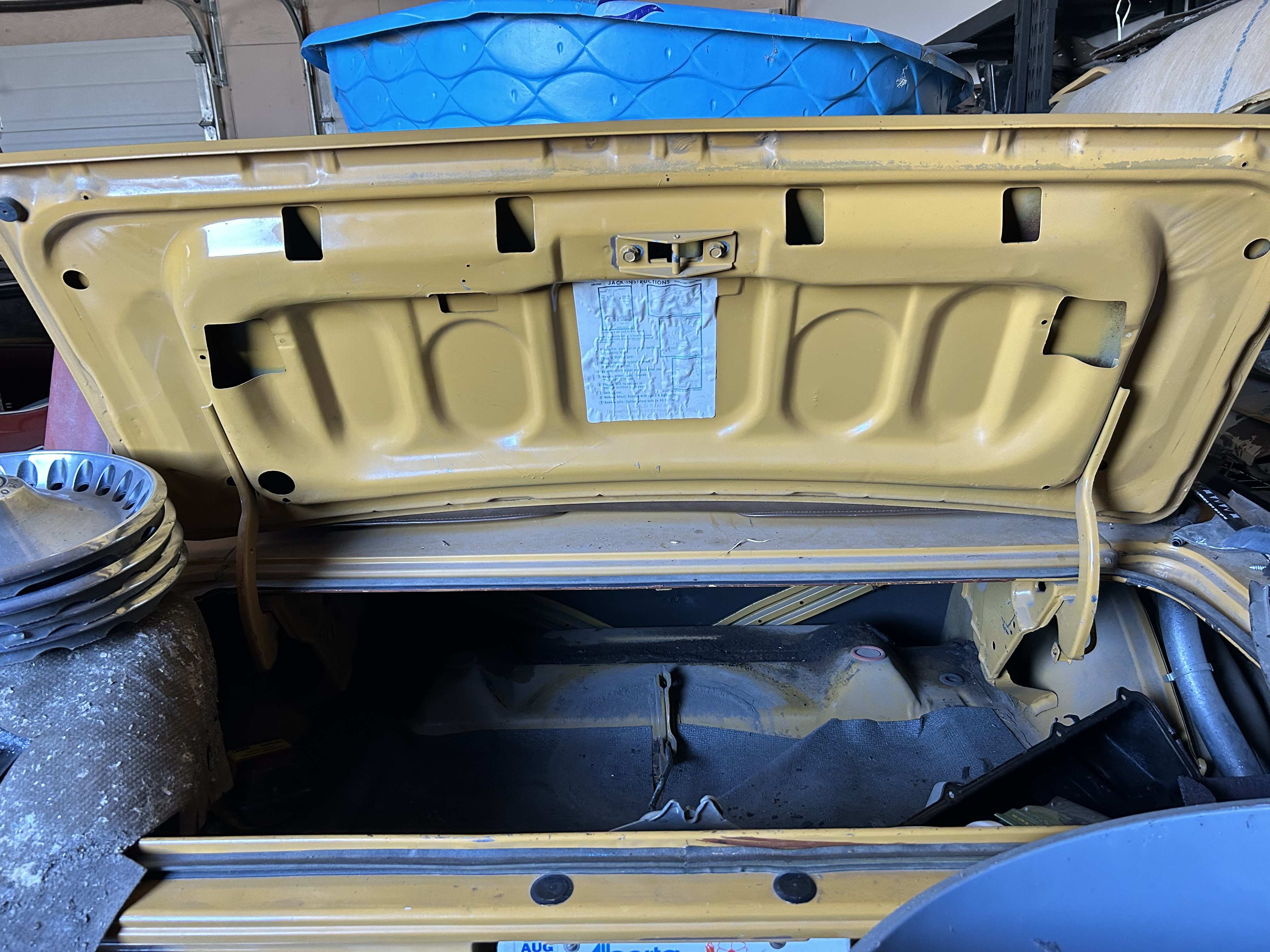

Can you post pictures of the Version 4 and 5 decklids so we can consolidate them into the graphic?
The picture that MoparCowboy posted is version five, the "generic" version used after 1971 production was over. It remained unchanged until the end of 1974 production and the end of the Barracuda. I will post a picture of the 1971 model year lid tonight, but it is the one you show two halves of in your luggage rack mounting diagram. Smaller areas for mounting the spoiler, each with a hole on each side of them.
