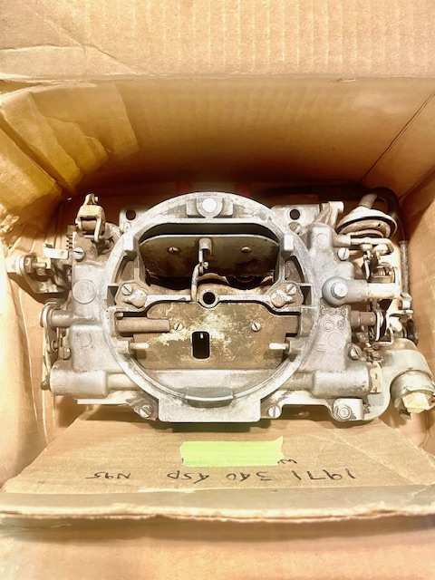

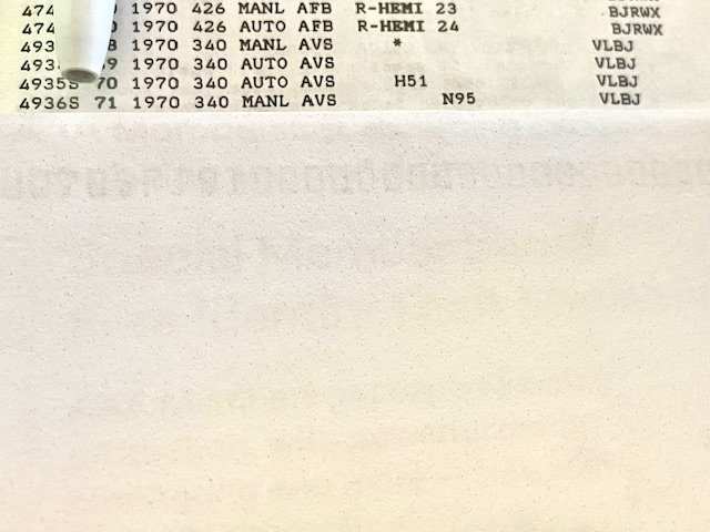

This is what I have in my inventory......see pictures and Galen`s reference book.

The only correct carb for a 1971 383+4 E Body, is a Holley.
lainetx9
Jan 30, 2023
50
26
Arizona
Sorry, my fault. My statement is correct for a 1971 340 4spd carb, but my 340 is the incorrect cubic inch he is asking for , yes the 1971 383 4 spd carb for his car is a Holly.
