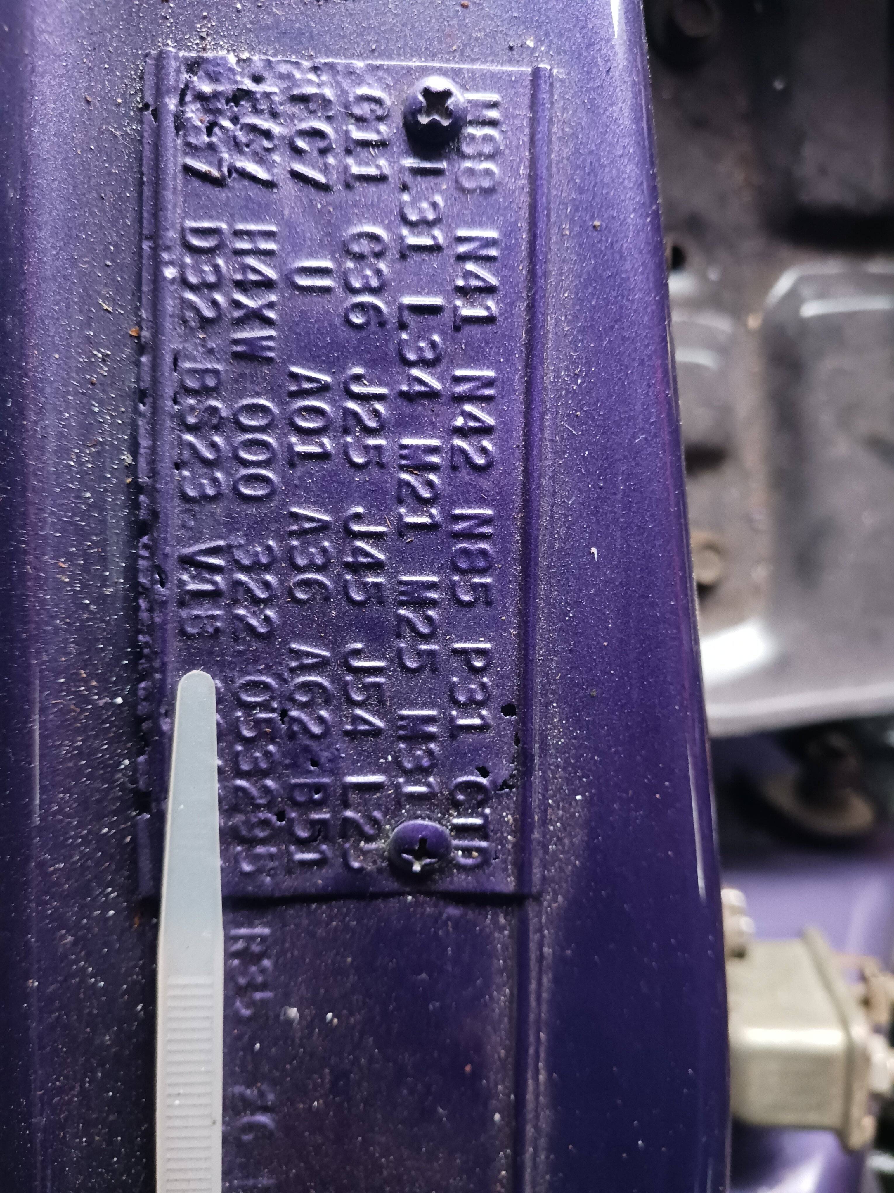

The build sheet photo is from Ebay. Too bad the pic didn't show the item number.

Tag is 334.not 224

In the first (deleted) post this photo was posted
What is the correct photo of your tag? With 334124 it is not a fake tag.
Photo I just posted is the correct photo.really strange that original photo .as I blocked out vin when I posted it..I'll post engine vin to verify as well
someone photoshopped this pic.inever posted complete vin also.look at colors above second tag.a line then lighter purple and brightness around te 124.i painted this car,and im sure color does not change to light purple on apron defined by a line.much more of this stuff and ill end this post.
i know 124 looks like 134 its not its 124 its the camera,hate to keep harpen on it but ther vin is critical on this car

The edited "photoshopped" fender tag with BS23V1B224124 was derived from the blurry video. Here is a screenshot of that blurry tag. It sure looked like 224124 but obviously it is not. I think the owner has proven that this is truly VS23V1B334124 and my expert opinion is that his full fender tag shown meets all the criteria for an original tag.

Additionally, Barrett-Jackson shows this car sold at two different auctions and is listed as BS23V1B334124.
The earliest one was Scottsdale 2007 for $132,000.
The latest one was Scottsdale 2012 for $104,500.
Good luck with the sale, Jim. Don't let our members get you down. We have the full story now and you got a great car there just needs some attention to get back to show status.
