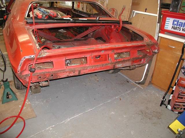

challenger6pk is correct, the 70-71 cars had no filler panels.
The 70-71 Challengers had a metal L shaped panel welded below the tail lights, most likely to shed water away from the car and was behind the rear bumper.

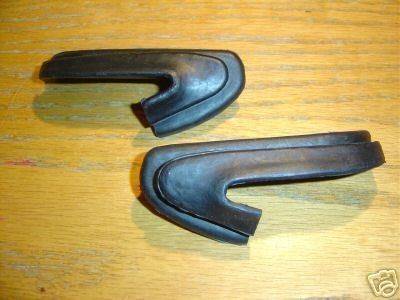

The 71 front bumpers have the rubber corners. Chrysler called them something else. I did not know you were referring to them. The 71 does not have the rear filler. That is 70 only. The rear tail light housing in 71 in flared at the bottom to form a bumper filler.
1970
Always something new to learn.
Interesting that only the 70 Challenger had the welded rear metal filler panel, and not the 71?
The rubber inserts were in the corners of the front bumper as stated.

Bumper fillers for the front bumper corners on 70 and 71
