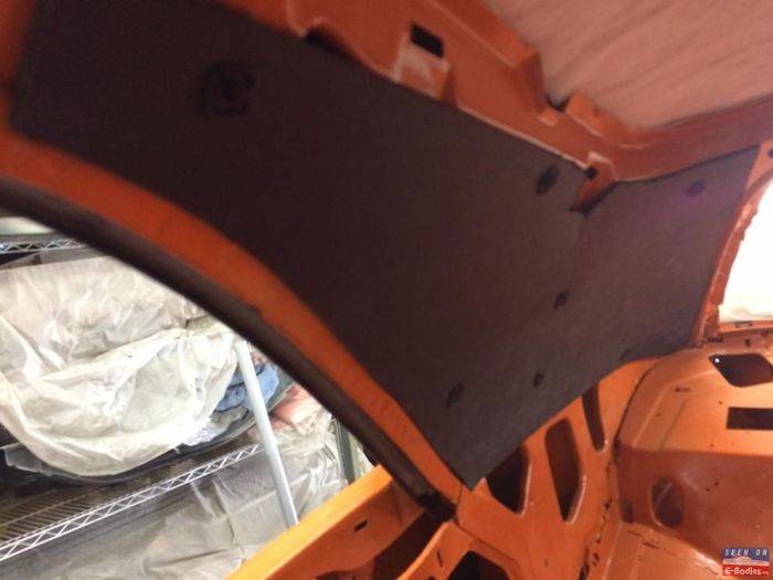

Amarillo Texas
I saw a picture where the challenger had sail panel boards that were uncovered and under the headliner. challenger headliner - Google Search:
