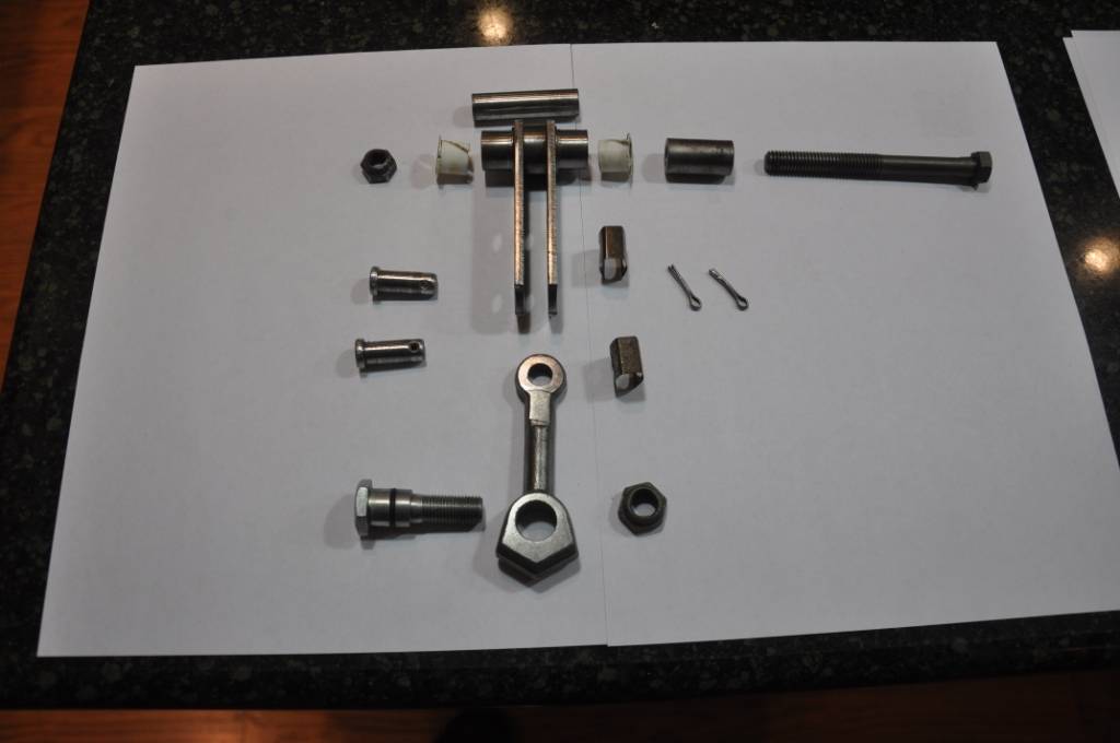

You need this bellcrank linkage between your pedal and the power booster.

The plate is different for the booster. The holes are in different shapes and location for the linkage. Pedal is the same.
