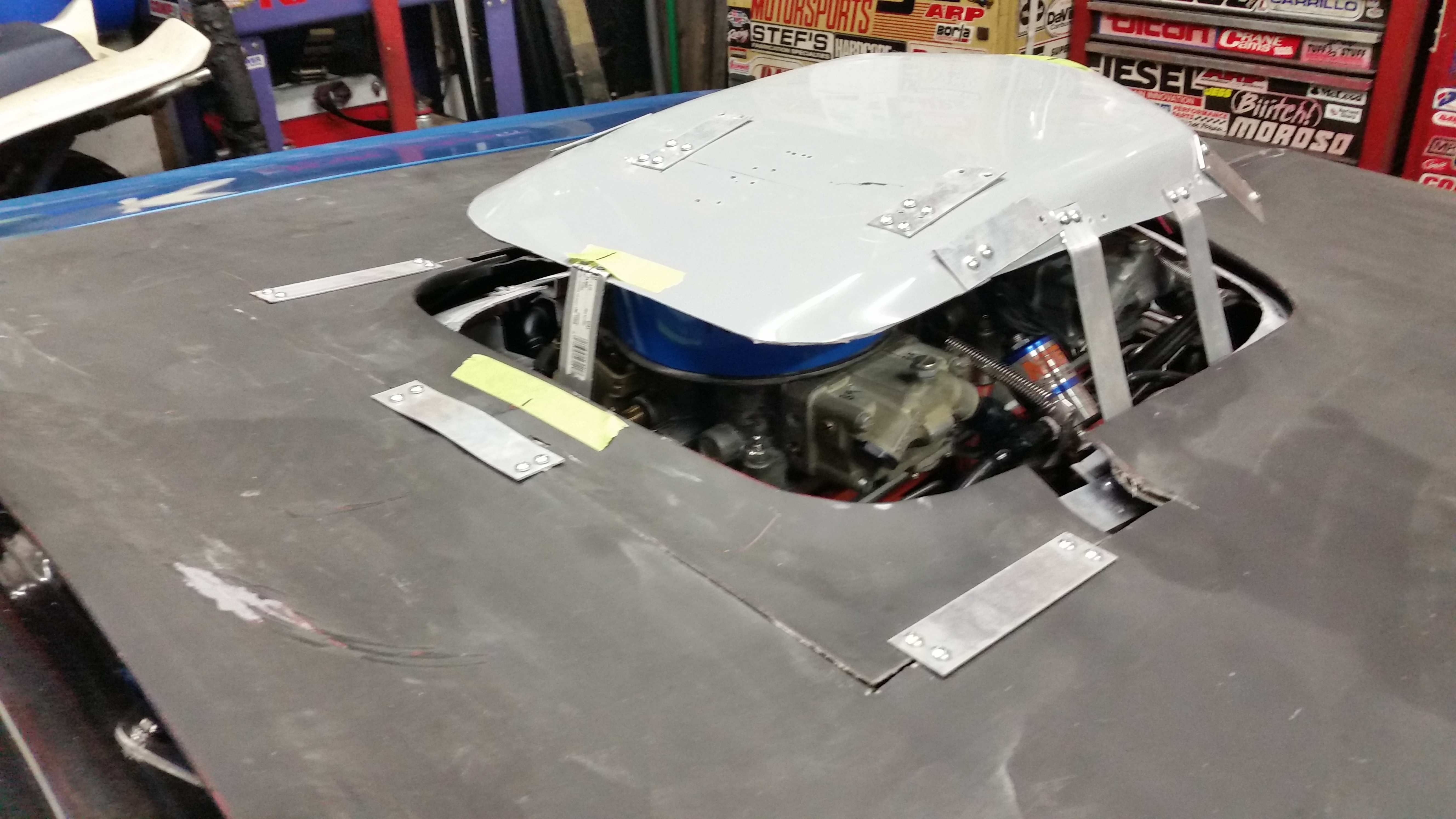

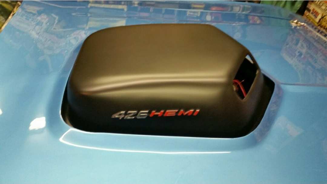

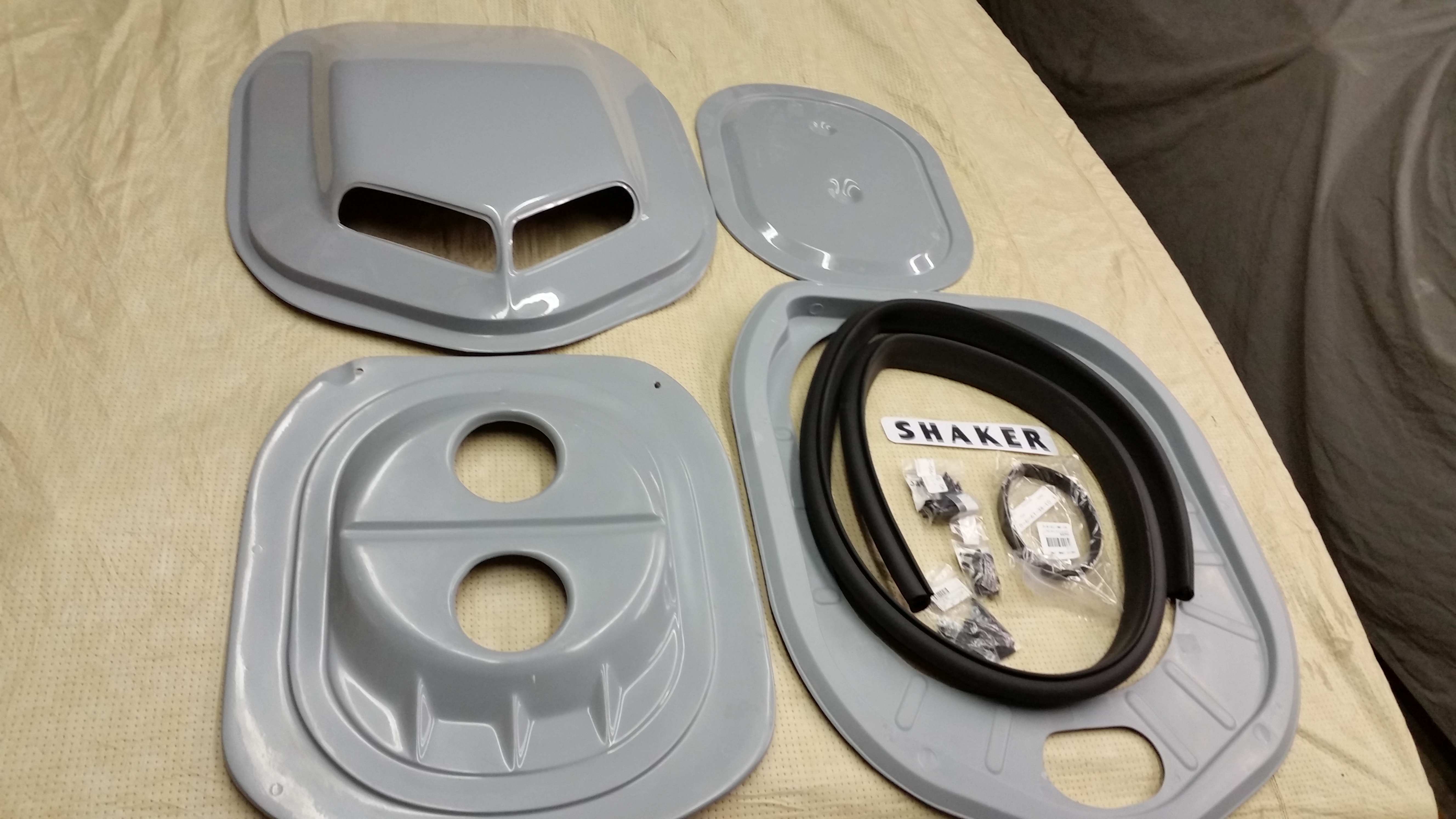

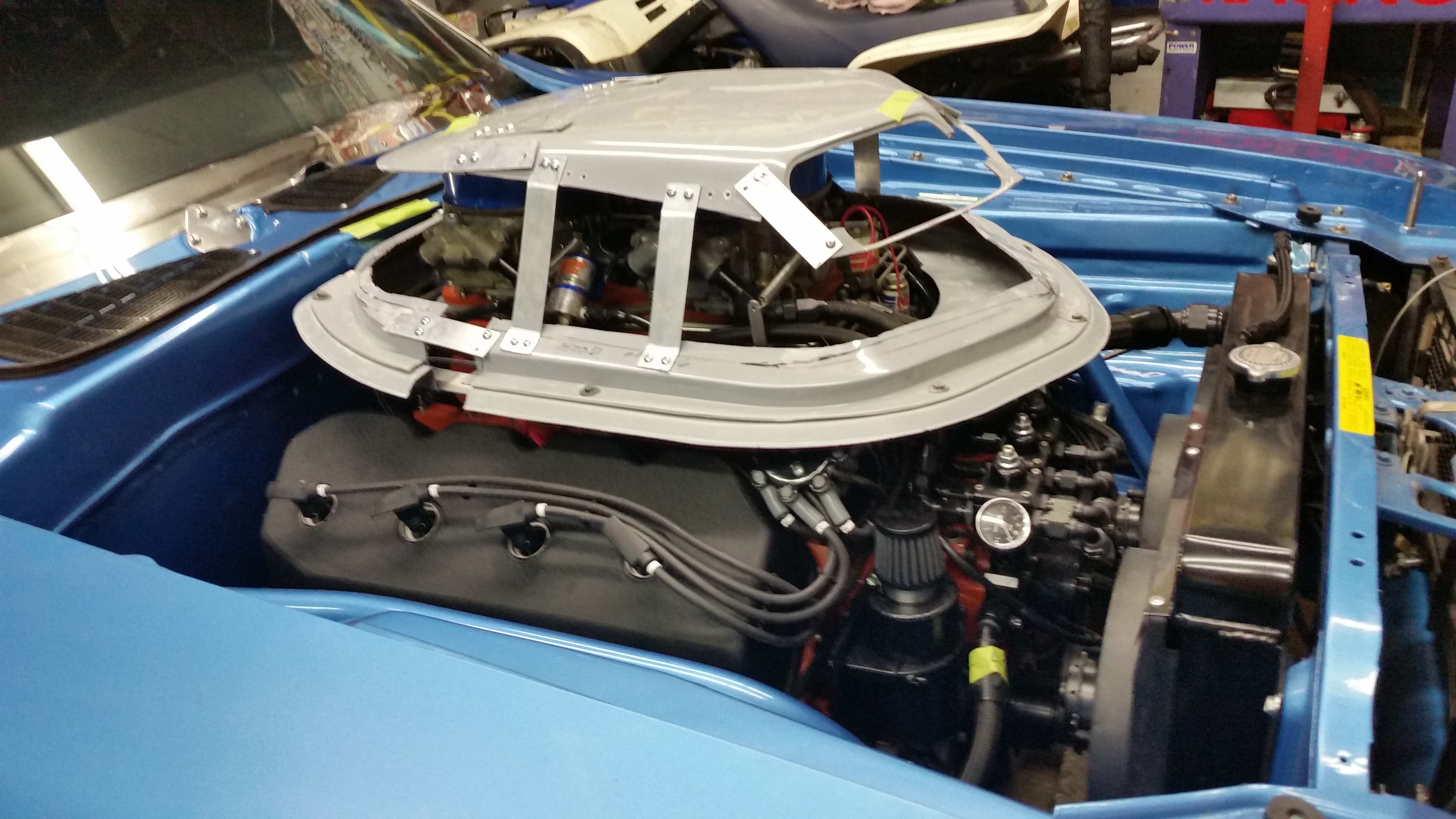

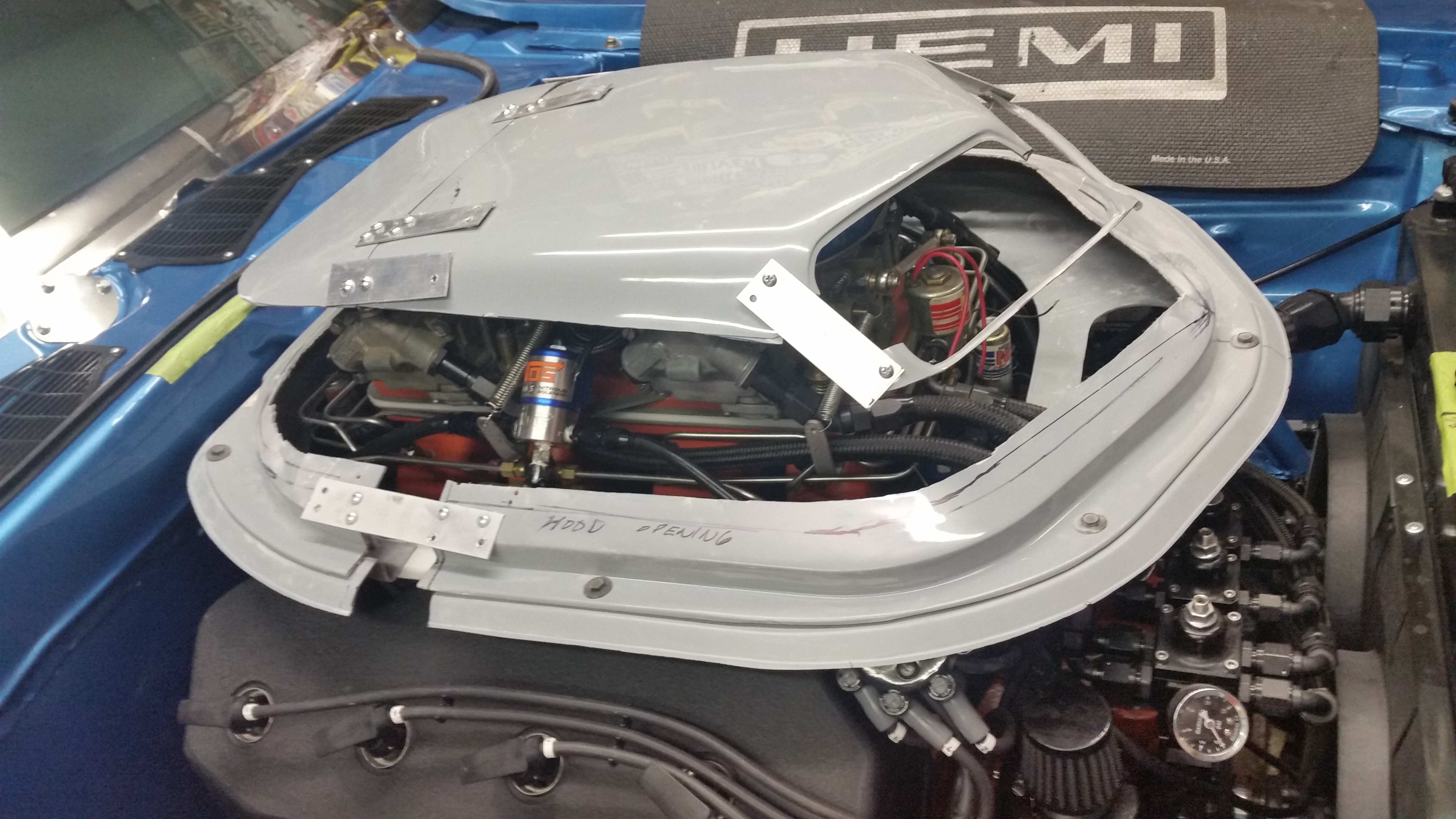

Mine is alittle over kill. However, so is the rest of my car. I stretched the hood opening, the base and the scoop 2-1/2" longer. Then raised the scoop height 4" and opened up the scoops nostrils 2-1/2" taller.
Holly Cow you do have some kinda talent. Yea, I wouldn't know where to begin. It's been 45yrs since I helped glass an old boat and that ain't no boat. I guess I'll try and find an intake and maybe it will fit. Thanks you, Sir.
