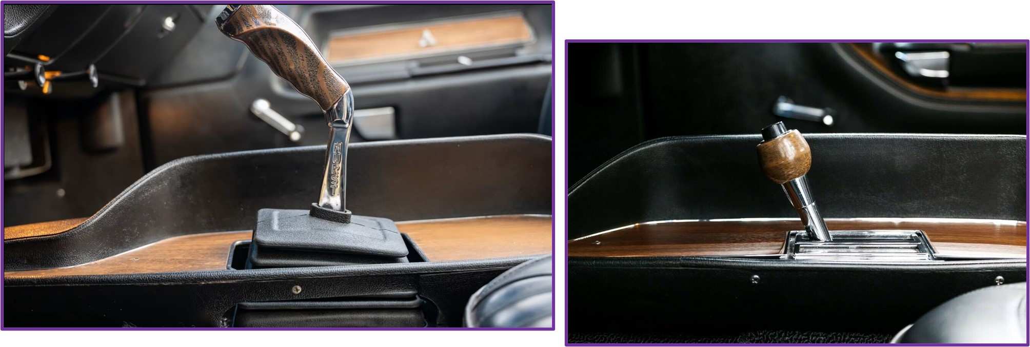

Nov 17, 2024 #3 MoparCarGuy Well-Known Member Joined Jun 28, 2020 Messages 996 Reaction score 937 For reference: 4-Speed vs. Auto Console and top plates.
